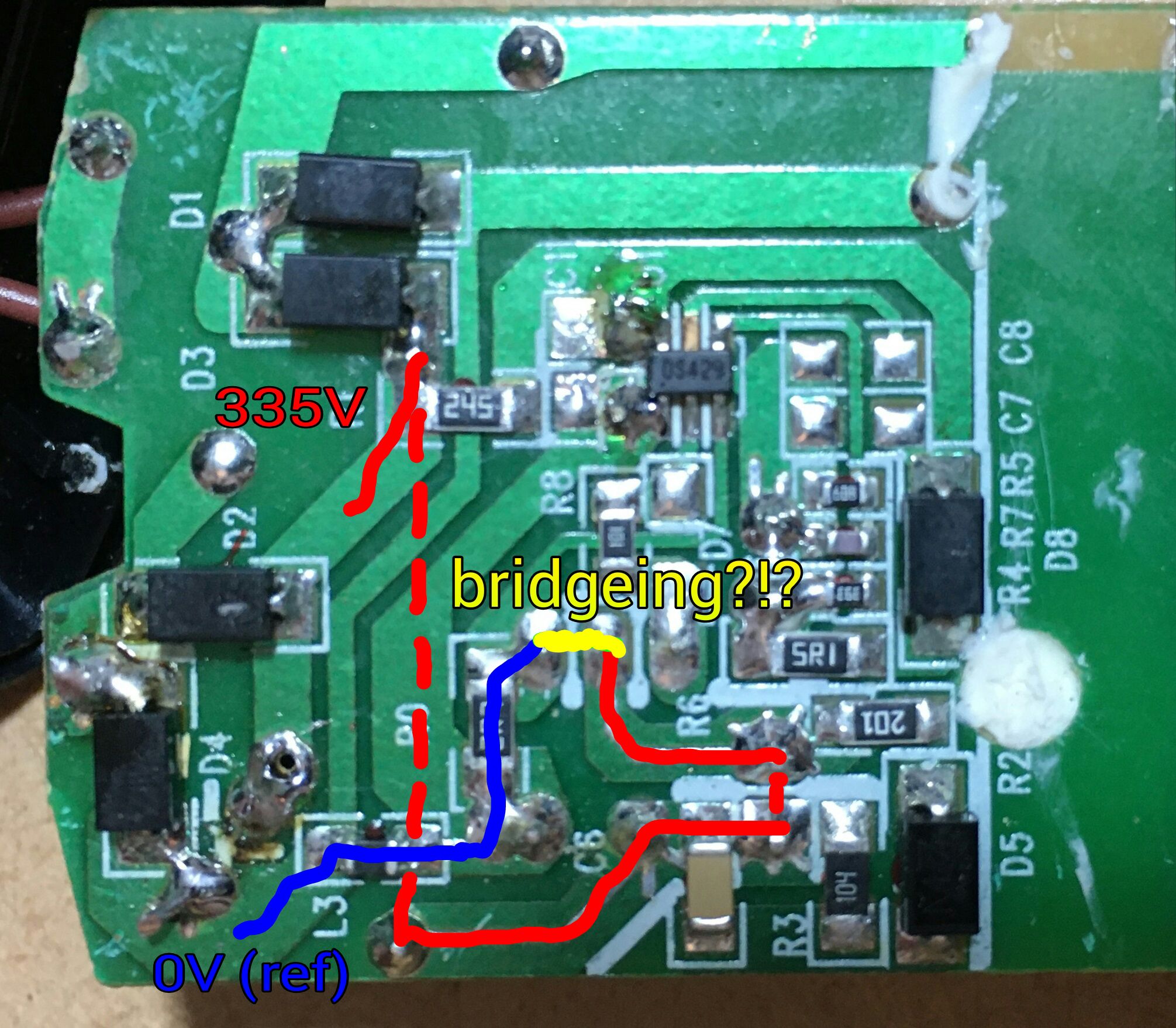

    Is there any way I can check that there really is a voltage between source and drain, in circuit, with power on?
    You did measurement with multimeter before:
    Source to Drain
    Voltage = 335 V DC.
    Voltage = 0 V AC.
    Are you expect some other reading? Is mosfet tested good?

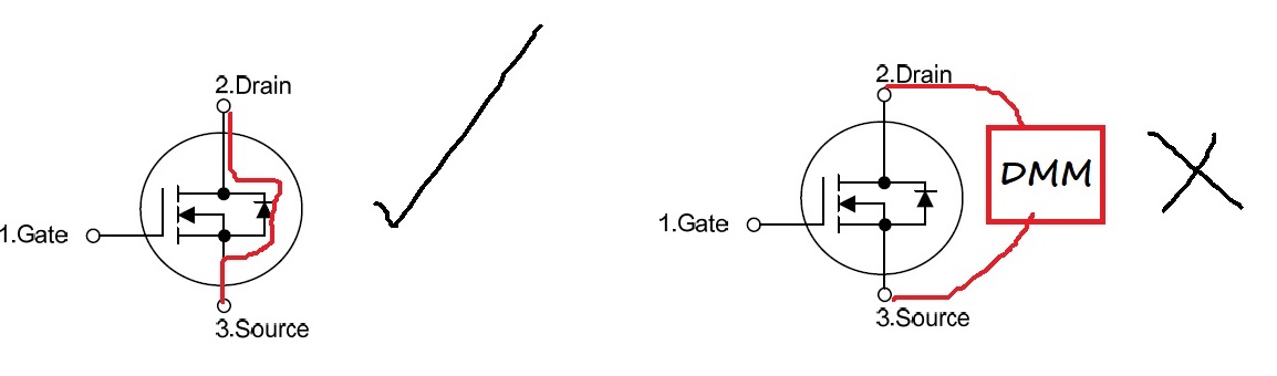

      I mean voltage going through the transistor source to gate, not parallel with it (possibly only going through the multimeter).

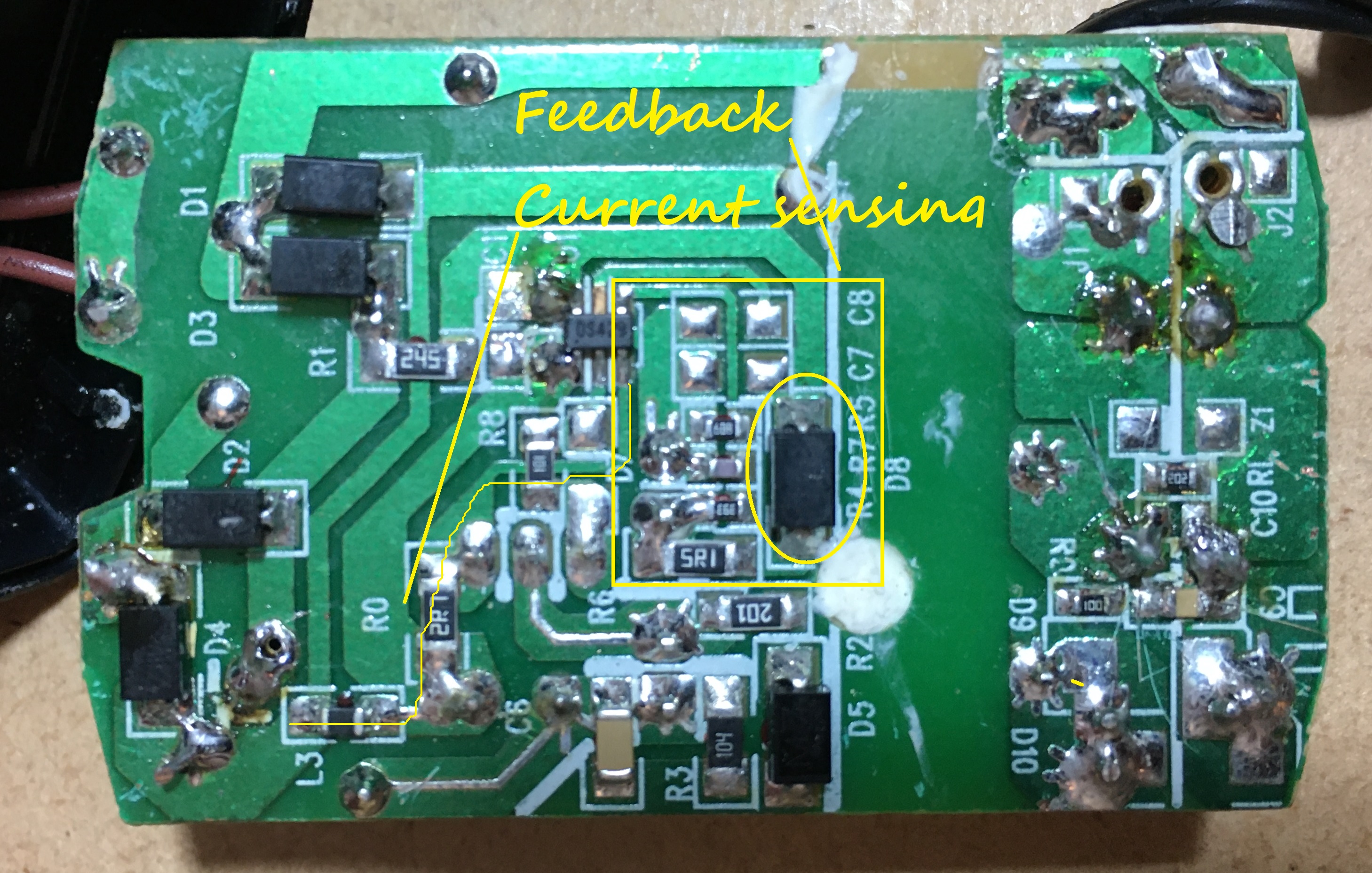

        Sounds like the mosfet doesn’t wanna switch. You got power full bore after the bridge rectifier into the main filter cap. So you can have few problems. R1 open (or going higher in resistance than it should), the cap failed, diode shorted, or U1 is buggerd up. Make sure you get proper Vcc to pin 5. Look at the spec pdf what it needs. And measure DC voltage between pin 5 and main filter capacitor ground for proper voltage. If you deterrent that the voltage is too low at the chip, replace the resistor, check that diode. Still doesn’t work, repale u
          #84
          Re: trying to fix a 6V 0.5A T1 (Transformer) AD050120T2 power supply
          OK. We are heading towards trying to verify if U1 is broken. By measuring VDD to ground of U1. I don't want to desolder U1 to test resistance to avoid damage.
          I have performed some more tests.
          Theory
          1. If Q1 (mosfet) is not working, it won't switch on the source drain voltage and no current will flow to the primary coil. If it is working it will switch on current to the primary coil.
          2. If I bridge Q1 source to drain with a wire, Q1 will be permanently switched on source to drain.
          3. If I apply 3 V battery power to Q1 gate to drain it will switch on source to drain and conduct current source to drain.
          4. With a current limiter bulb connected in series with this adaptor, the bulb will light when current is drawn, and the bulb will not light when current is not drawn.
          5. Previously U1 gate to Q1 gate voltage measures -0.1 V to 0.9 V changing rapidly. No voltage measured at the primary coil.
          I bridged source drain of Q1 and measured voltage at primary coil
          Result
          Primary coil voltage
          1.1 V DC.
          0.6 V AC.
          The current limiter light bulb goes on.
          I removed the bridge on Q1 source to drain and put 3 V battery power to Q1 gate to drain (to switch on Q1 mosfet)
          Result
          1.1 V DC.
          0.6 V AC.
          The current limiter bulb lights up.
          I removed the 3 V battery power to Q1 gate to drain
          Result
          0 V DC.
          0 V AC.
          current limiter bulb goes out.
                You are pushing your luck, even with light bulb current limiter (60w of power!) you can damaging various component on short circuit pathway! You are efficiently connected +335v with ground throu some non relevant resistance...
                The bulb will light when excess of current is drawn, so it prevent some nasty things can happen if you accidently touch wrong place. Light bulb is not miracle ultimate protector for everything bridgeing on your mind, you can damage all undersized components along it.
                But now, after testing it seems the mosfet is ok...
                Mosfet in this configuration is not intended to be permanently switched on, he must pulsing very fast.

                  RS1M has a cathode mark so should test like any other diode.
                  Testing D8 (RS1M)
                  Testing red probe to cathode = 0.697 V, black to cathode 0.064 V but there are other paths to the circuit.
                  both sides of this diode measure continuity to wires 1,2,3, and 5 of U1 and continuity from each side of the diode, but there are other paths.
                  I think this test shows that RS1M (D8) works fine.
                  That leaves U1 as the broken component, I think.

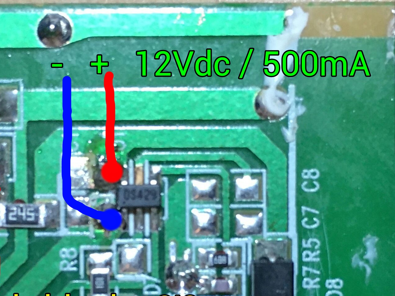

                        At least you can check and confirm where is this component with 62 ohm resistance. When I see the pulsating output, I suspect for external short and IC is fighting against them... but may be intenal also. 62R is unusual value for short circuit.
                        Be sure to unplug from mains voltage, and put 12Vdc directly on IC** and you may notice a hotspot, around 2.4W disipation of heat on a problematic component. You can spot it via finger tip or with spilled alcohol who evaporated quickly on that problematic component.
                        **it will be idealy that you can control and monitor passing current, you can use 12vdc from any wall adapter rated over 300mA, and monitor current with multimeter.

                            The advice on using a 12V power supply is very helpful since that would make it safer. I have a laser pointer thermometer and protective goggles, and the thermometer that measures up to around 400 C, and can measure the temp on U1 when I get it wired up.
                            I have a universal 12 V supply but I am afraid if I connect this to U1 it will break. Are you sure I can connect this adaptor to U1 VDD and ground and not break it? I might prefer 1 or 2 last mains powered measurements rather than risk breaking my power supply.
                            I would like to get a temperature reading just to confirm the short in U1. Now I know how to switch on Q1 I think U1 overheats and will show.
                            About other components. I have tested all the other components so it must be U1 internal. I am so much convinced U1 is broken I am no longer trying to find another cause. All the diodes and resistors that feed U1 are working so it has to be U1, since Q1 was proven to work with the proper gate voltage.
                            I might look at reading a current too. What sort of amps should I be looking for?
                              From theoreticaly calculations I am prety sure, but in practice things may go wrong. Say, with good electrical component, are you sure that do not fail right now? You may guess and hope to they not fail, but he fail at one moment. With broken component who has 62 ohms (some inside carbonised burns), it is unpredictable if he go next second on 500kiloohm, or on 0.01ohm.
                              Your adapter also may be good designed (with protection) or crapy, with proper or "only working yet" components...
                              I suggest if it is only adapter you have, and it is so valuable, that you dont using it on irelevant purpose like this.
                              I using small adapter from some router, 12v 1.2A with chinese module who limit current and can lowering voltage. Nothing fancy. If it stop working for any reason I do not drop any tears...
                              This tips for connecting a limited current to circuit with low resistance is common method to finding short component. The set voltage must not exceed maximum ratings of any component connected on that rail, lower voltage can be obtained if is left enough power to disipate heat.
                              So, it is about 60R, and with applaying 12v into it, it will drow about 200mA, but if it unexpectedly shorts it can pull out maximum current of your supply. Because, it is always good idea to have some current limiter circuit while testing, and a very bad idea is to use car battery directly, hopeing to circuit stay consuming only 2.4W...
