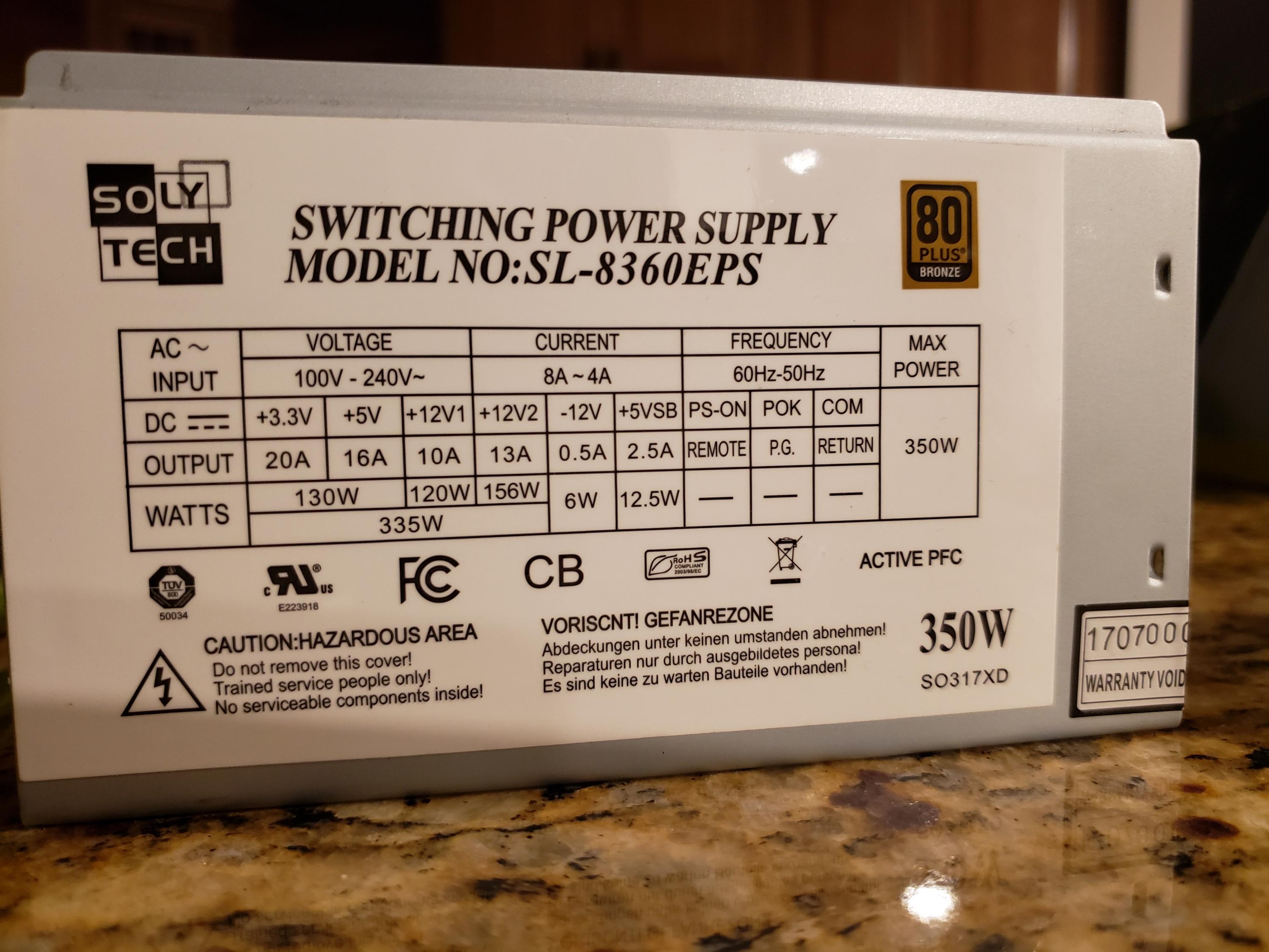

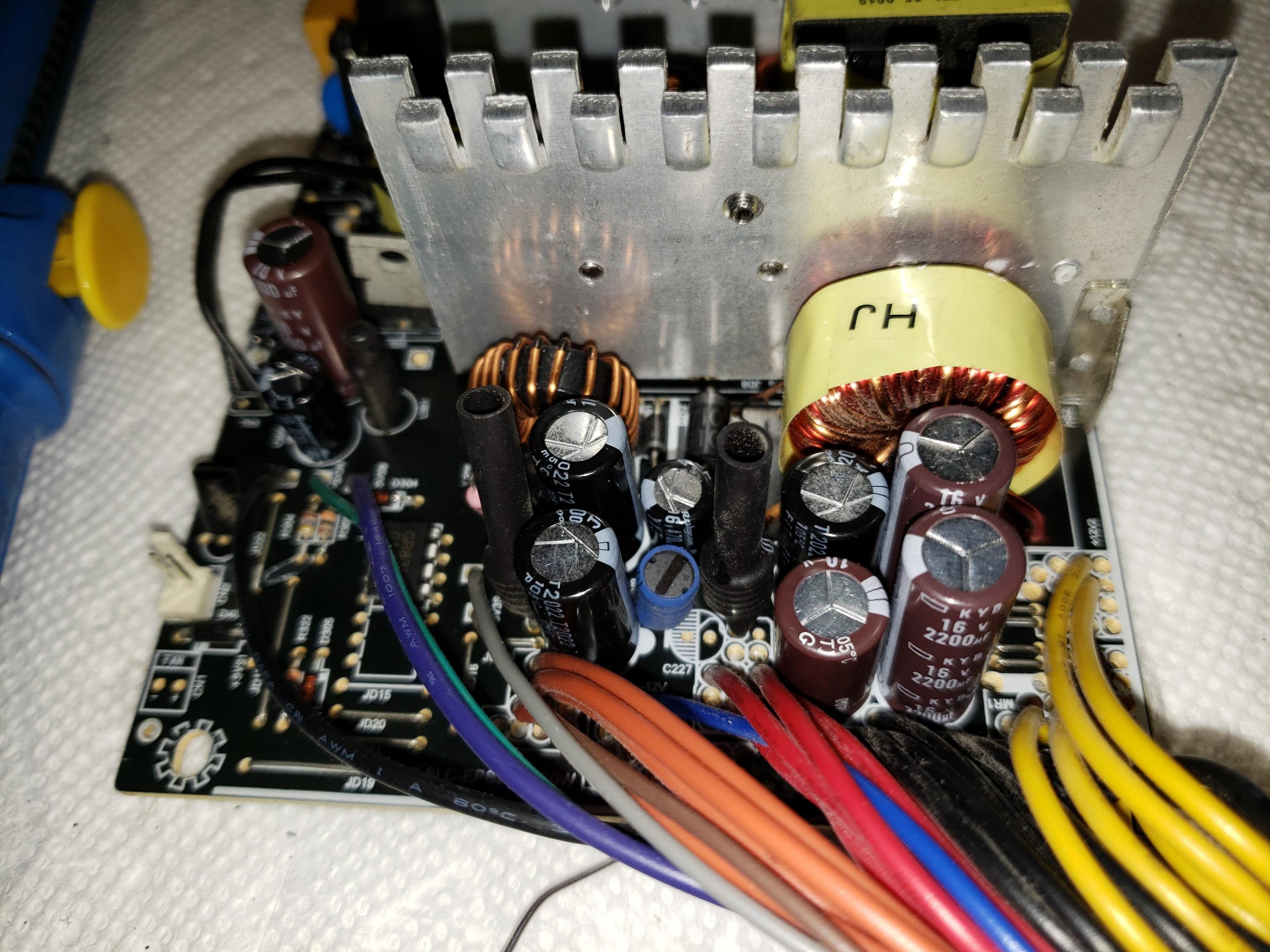

    Unfortunately I got rid of most of my power supplies a few years back so I hunted some on eBay. Of course I could have got some with already good caps but what's the fun in that when you can save unsuspecting victims on eBay from buying something that could cause them problems?
    I'm also aware that Solytech is capable of making a decent unit, minus their caps. This one is on the 80 Plus website as being able to do its full wattage.

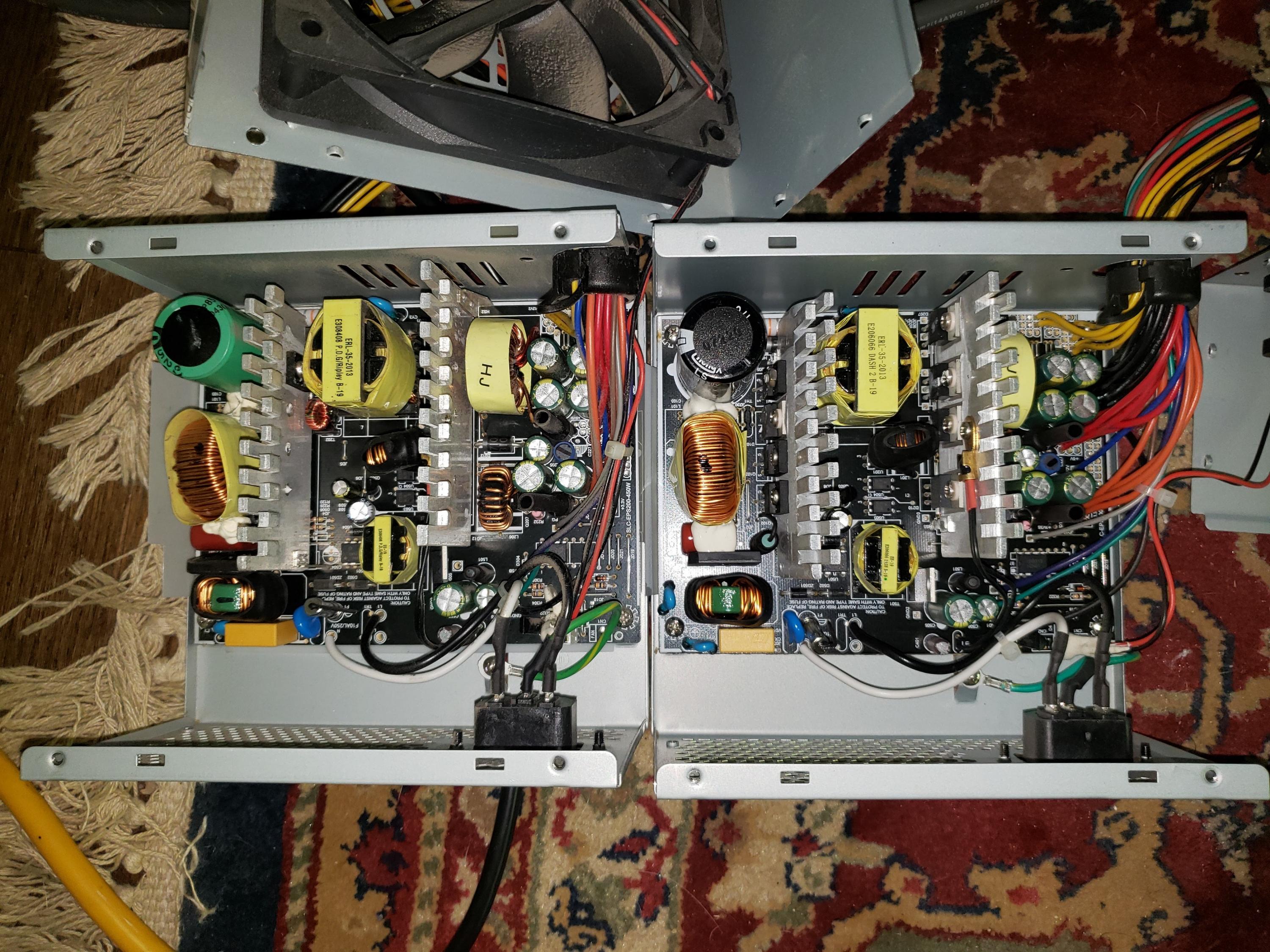

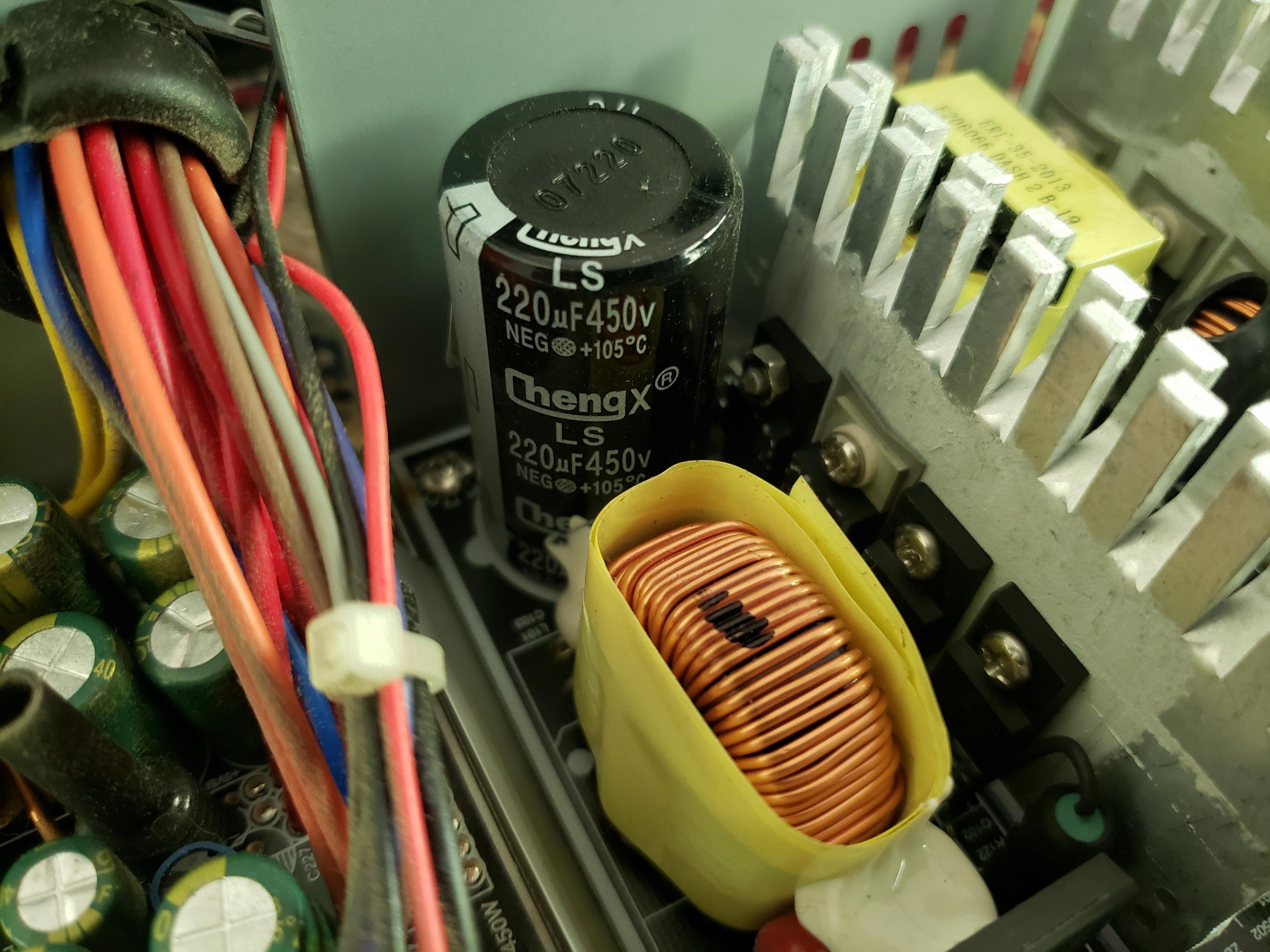

    I bought two of these as a lot. One was made in July 2017 and one was made in September 2017. Interestingly, the only difference between the two was the primary cap.

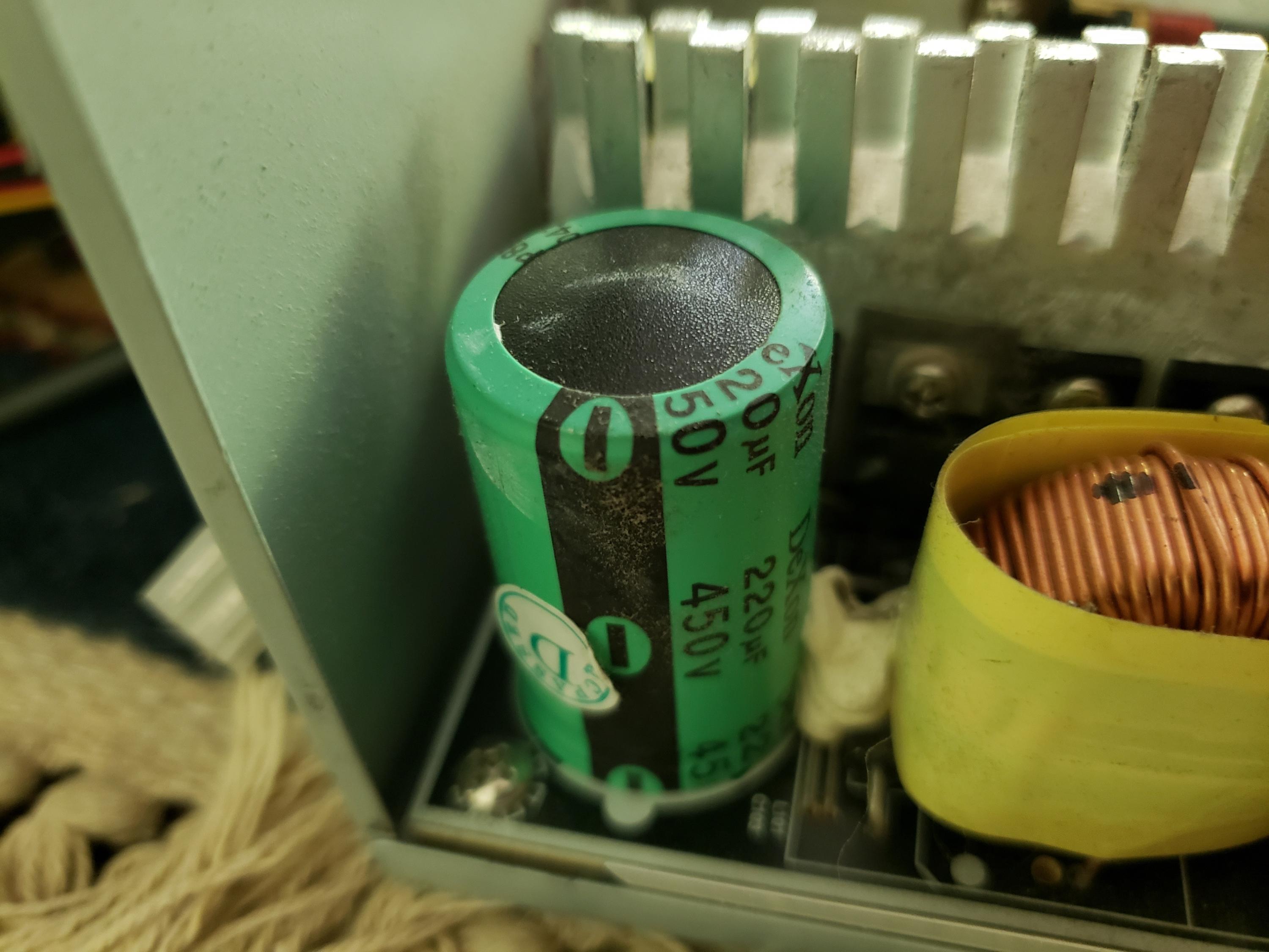

    The July 2017 had a 220uF 450V DeXon cap (no series) rated at 85C. I was surprised to pull it and see that it read 209uF and 0.22Ω ESR. (I decided to give Wurth caps a try)
    The September one had a taller 220uF 450V ChengX LS cap rated at 105C. I found this very interesting because the DeXon 85C cap is bulged! As you can see there, and I am not able to press the disc down.
    I was intrigued by this because I tested both of them with a paperclip and both turned on. Curious, I hooked them up one at a time to my Kill-A-Watt brick. I tested the one with the ChengX cap, it powered on and idled at a shocking read of 0W with a PF of 02.
    Due to there being no minimum load resistors, the voltages were all out of whack.
    12V = 12.83V
    5V = 4.72V
    3.3V = 3.38V
    5VSB = 5.18V
    -12V = -10.17V
    I hooked up the one with the bulged DeXon cap, and this one read 10W draw with just a paperclip and a PF of 59. All of the rails read exactly the same as the healthy one except the 5VSB was 5.17V
    So what's the deal with 10W more? Is it because the cap may be in "early" stage of failure? Is the leakage current increasing, causing the PSU to have to charge it more with the mains? I'm very curious about this since it didn't have an affect on the secondary at all (with no load at least).
    Other shots:

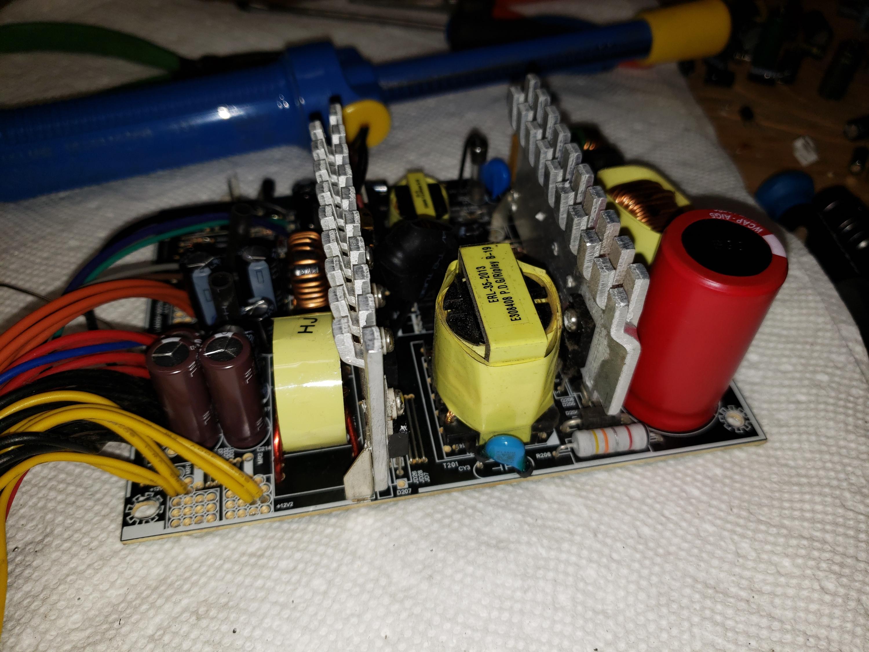

    The primary uses:
    (For PFC):
    x2 Toshiba TK10A60D (10A) FETs
    Diodes Incorporated LTTH806RW (8A) power diode
    (Switchers):
    x2 Toshiba TK13A60D (13A)
    Secondary:
    3.3V: x1 Vishay 30V30CT (30A)
    5V: x1 Vishay 30V45CT (30A)
    12V: x2 Vishay 20V60CT (20A)
    It looks like this PSU does actually have two 12V rails. (Pleas correct me if I'm wrong!) One of the rectifiers is just jumpered over to the other one where they both pass through the same winding on the big toroid. Then, they are jumpered to their own sections of 12V wiring but where they are jumpered from is the same pad. I'm used to seeing a giant shunt, instead it just uses two small jumpers (and a giant glob of solder lol)
    In my next coming post I will show the recap and my intentions with this PSU!
    Another note, what's up with this not having a current inrush limiter?? Could that have caused the main cap to bulge? Although it does have one MOV by the fuse. Should I add an NTC? I have one from a dead half bridge Solytech.

    Re: Solytech SL-8360EPS analysis + mods
    I don't see any pictures, but this is an interesting one. I don't think I've ever seen a Solytech with PFC before.
    The bulging cap probably is leaky, but you'd see it getting hot (and probably venting) at 10W. I haven't tried Wurth caps before, but considering the price, I would consider them for something non-critical.
    Also, your title reminded me that I ran out of 22uF caps to replace CapXons. That's pretty much the only brand of caps that I still don't want to use.

      must have some sort of inrush limiter, the inrush limiter mainly affects your power switch from welding itself closed, also helps save your power lines from undue stress after a power outage.
          What do you think was causing the significant increase in power?
              Looks like Solytech has moved up the ladder in terms of build quality and design. I see this is a double-forward design and has pretty good rectifiers on the output, especially the 12V rail. For a 350W-rated PSU, this is quite nice. The output and APFC toroids also seem to use a more up-to-date 45 -type core. That being said, the output toroid does seem a bit on the small side. But it being a -45 core, it's probably just enough for about 300-350 Watts.
              Yeah, I think this PSU does indeed have two 12V rails. Well, it's a single large 12V rail split into two with "current shunts". Indeed I'm also used to seeing the thicker shunts instead of thin jumpers... but I guess if the thin jumpers present enough resistance at high current to cause a measurable drop in voltage, then they can be used just like regular current shunts. And I think I've seen this in some other PSUs as well, though I can't recall in which one right now.
              +1
              Actually, even with no load, I don't see how the PSU can be using 0W when jumpered On. The transformer core, output toroid, and APFC toroid should all be wasting a small amount of power equivalent to a few watts each. So the PSU with the bulged DeXon cap is the one that seems to register properly on the KAW meter.
              But indeed there doesn't seem to be one.
              Perhaps the manufacturer is relying on the inductance of the APFC coil to somewhat limit the initial current spike enough that an NTC is not needed?
              I also have a PSU that doesn't have an NTC, and it's a non-PFC PSU too - a Thermaltake TR2 430W (XP-550np). I use that PSU in my GPU test PC, which I power cycle with the switch on the back almost every time I get it out of the closet and test a new (to me ) GPU. The switch has easily seen over 1000 cycles now. Hasn't welded or loosened yet. The primary caps are 2x 200V 680 uF units... which is substantial capacity when running with 120V AC (which is how I've used this unit its entire life.)
