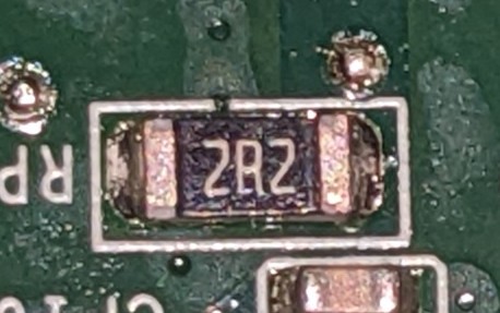

    Re: Dell T5810 bios mods, motherboard mods, schematic help
    Could someone help me identify exactly what resistor this is. I can measure with a caliper if needed. I believe the markings indicate 2.2 ohms. My meter reads 2.4 but also varies .1 to .2 when touching the leads together.
      Have to quit for the night but I found another pwm controller.on the board a ncp6133. Here is a quote from the data sheet. I think the resistor I pictured above which there are 6 of are feeding it. Here's the quote.

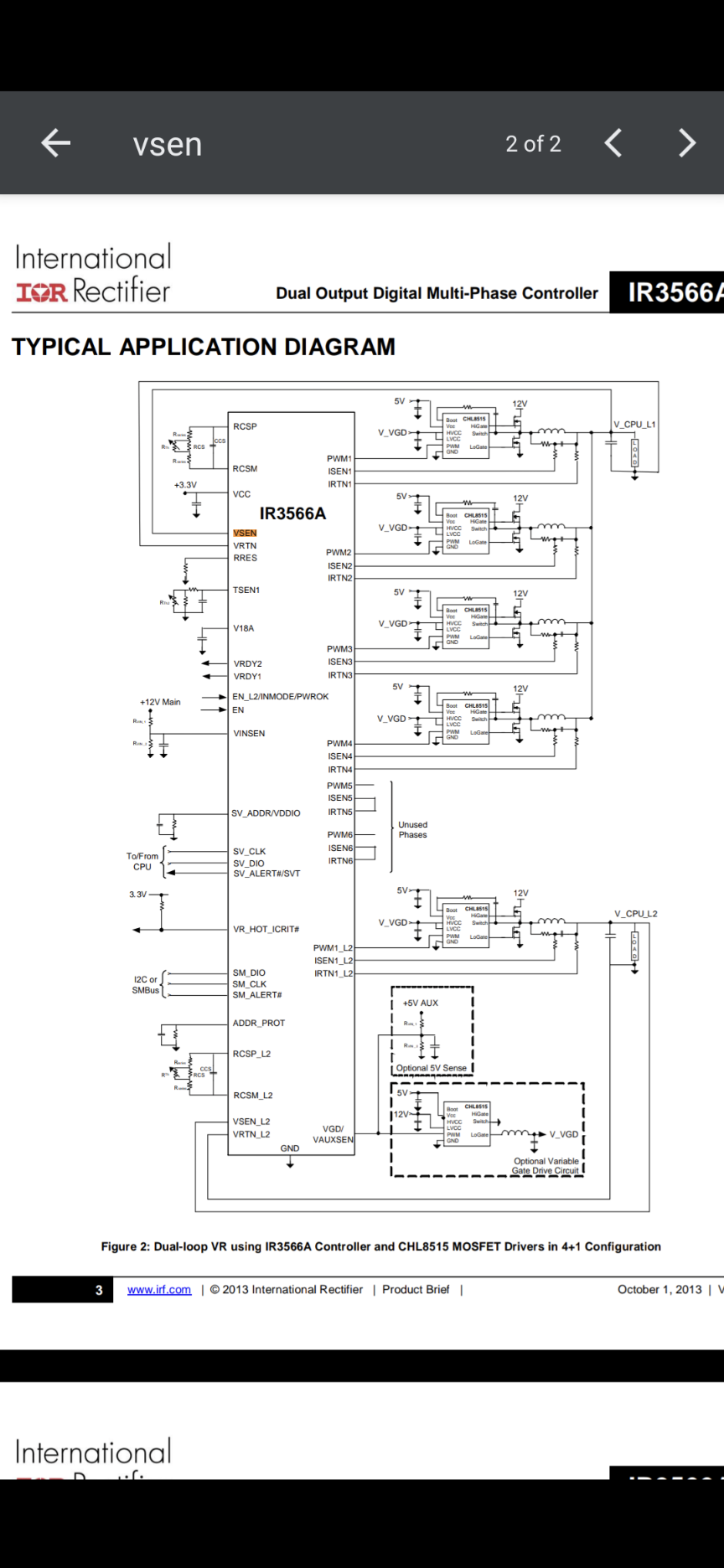

        Could someone please explain a little about the vsen and vrtn pins 5 and 6 on this schematic?
          Well if anyone cares I'm going to but some 2.2 resistors and solder them on. Don't have much to go on other than a guess lol. I contacted infenion who makes the vrm controller and MOSFETs for my board and they told me they can't assume what the current sense is on my board and from an inside source the Dell schematic is nda. I've given up trying to meter out guess work so I'm just going with my gut. If I get the board it's 45 bucks. I'm going to stick a cpu on it that I don't want to use Incase I cook that too along with a GPU I don't need a psu I don't need and 1 stick of ram. It could basically catch fire and I won't be out much lol.
