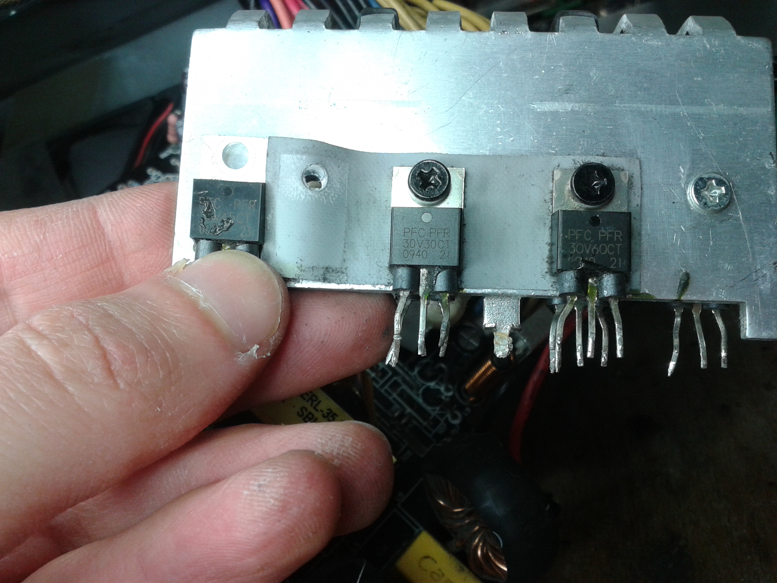

    This is an ATX PSU rated for 550W powering 24/7 a computer load of about 200W, fed by a line-interactive 1500VA UPS. Mains is 230V.
    1. First issue: the PSU blew a mosfet on what I think is the active PFC boost converter, shorting its G D S pins together causing a short across the + and - lines produced by the rectifier on the 230V mains. The surge protector of the house tripped. When this happened I found that the UPS was unexpectedly disconnected from the wires of its battery. The UPS wasn't damaged, but I suspect this spontaneous detachment of a battery wire caused a condition that blew the power supply, because the UPS doesn't provide output voltage without its battery connected. The blown mosfet is a 16N50C3 in TO-220, replaced with an IRFP460 in a bulkier TO-247 which I had ready. The characteristics are mostly similar except particularly for the slower slew rate and higher gate capacitance of the IRFP460. The PFC PWM seems to be generated by a CM6800 which according to datasheet has a max frequency of 250ĸHz. The IRFP460 can switch up to about 3MHz.
      After this replacement the short between + and - was gone.

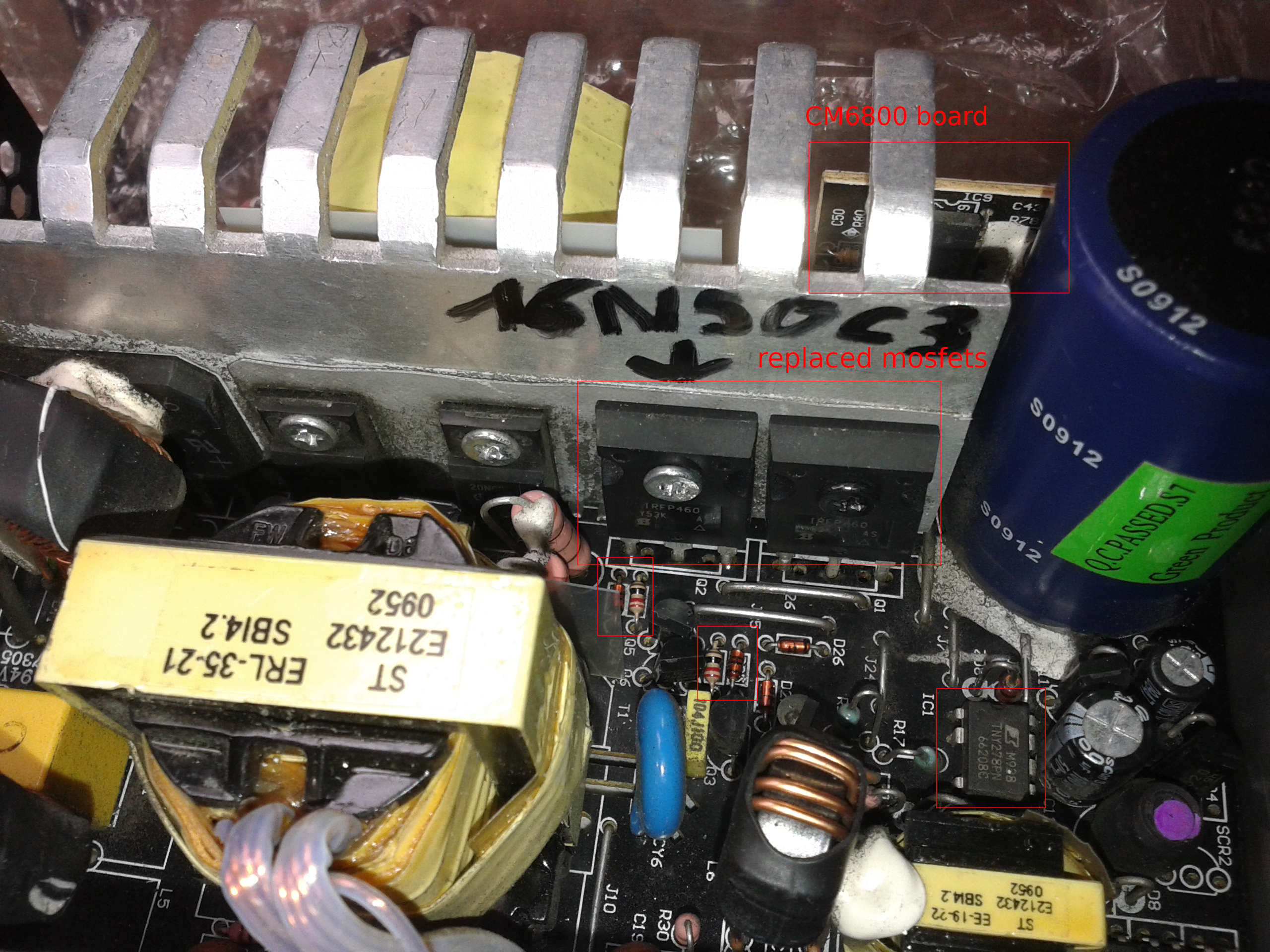

      Pictures shows two IRFP460 screwed to the input-side heat sink that replace two blown 16N50C3.
    2. Second issue: after I replaced the blown mosfet, I plugged the PSU to mains and tested the standby voltages on the bench. I had 5V VSB and the 5V power-on voltage from the green wire. All stable so far. I shorted green to black to turn on the PSU with a load of 3 x 12V fans (almost 1A total) plus the PSU's own fan. No load was on the 5V and 3.3V lines. For about a second it seemed to work fine and the fans powered on, then the other 16N50C3 on the same PFC circuit blew up, shorting + with - as before. The replacement IRFP460 physically next to it was undamaged.
    3. Current situation: I cleaned the PCB as I suspected that metal dust / fragments from cold solder joints may have caused a short in a control pin around the CM6800, then replaced the second 16N50C3 with another IRFP460 and tested again. I have a wall switch to quickly toggle mains power to the PSU on/off, to quickly cut power after repeated short tests of about 1 second each, so to prevent another blow up. Green remains shorted to black with a jumper wire. This time the dummy load is an old ~20 watt hard disk (1.2A on 12V + 0.75A on 5V). With the wall switch on, I measure ~12V between yellow and black and ~5V between red and black. The measures are approximate as the multimeter doesn't have time to stabilize before I turn the PSU off. The hard drive doesn't begin to spin up even after a second. The heat sink with the two IRFP460 becomes warm to the touch just after a second, and the 400V bulk capacitor of the boost converter remains discharged to 0V. It has a 1MΩ resistor in parallel so it would need several minutes to discharge.
      With only a multimeter I tested all discrete components on the PCB for continuity. There are no shorts across components and all diodes' forward voltages are within expectation. BJTs tested fine for continuity, resistors are all within specs, the 3 optocouplers at the bottom center of annotated_2.jpg tested ~1.2V for the diode side, the transistor side isn't shorted. The integrated rectifier (visible in annotated.jpg, left side of heatsink) is fine. No capacitor is shorted, and I can observe the electrolyte ones charging up slowly under the multimeter's own voltage. The transformers don't short primary against secondary. The white glue has not become conductive due to deterioration.
      I suspect what is broken is the PWM driver IC (CM6800) mounted on the vertical board close to the bulk capacitor. I tested its pins for shorts and there's none. One of its outputs connects to the base of both BJTs in front of the burnt/replaced mosfets, with one of these emitters connected to both mosfet gates thru a zener (unknown voltage) in parallel with a 22Ω resistor. The pair zener+resistor is replicated twice, once for each mosfet gate. (see annotated.jpg). It seems both mosfet gates are held open by the IC, conducting + straight to - via the boost converter coil (see annotated_2.jpg), preventing the capacitor from charging.
      There's a second PWM IC, TNY278PN, which I'm unsure of its relation to the faulty circuit.
    I found both replacement ICs (CM6800 and TNY278PN) on ebay for ~5€ each, I may order them based on your recommendations.

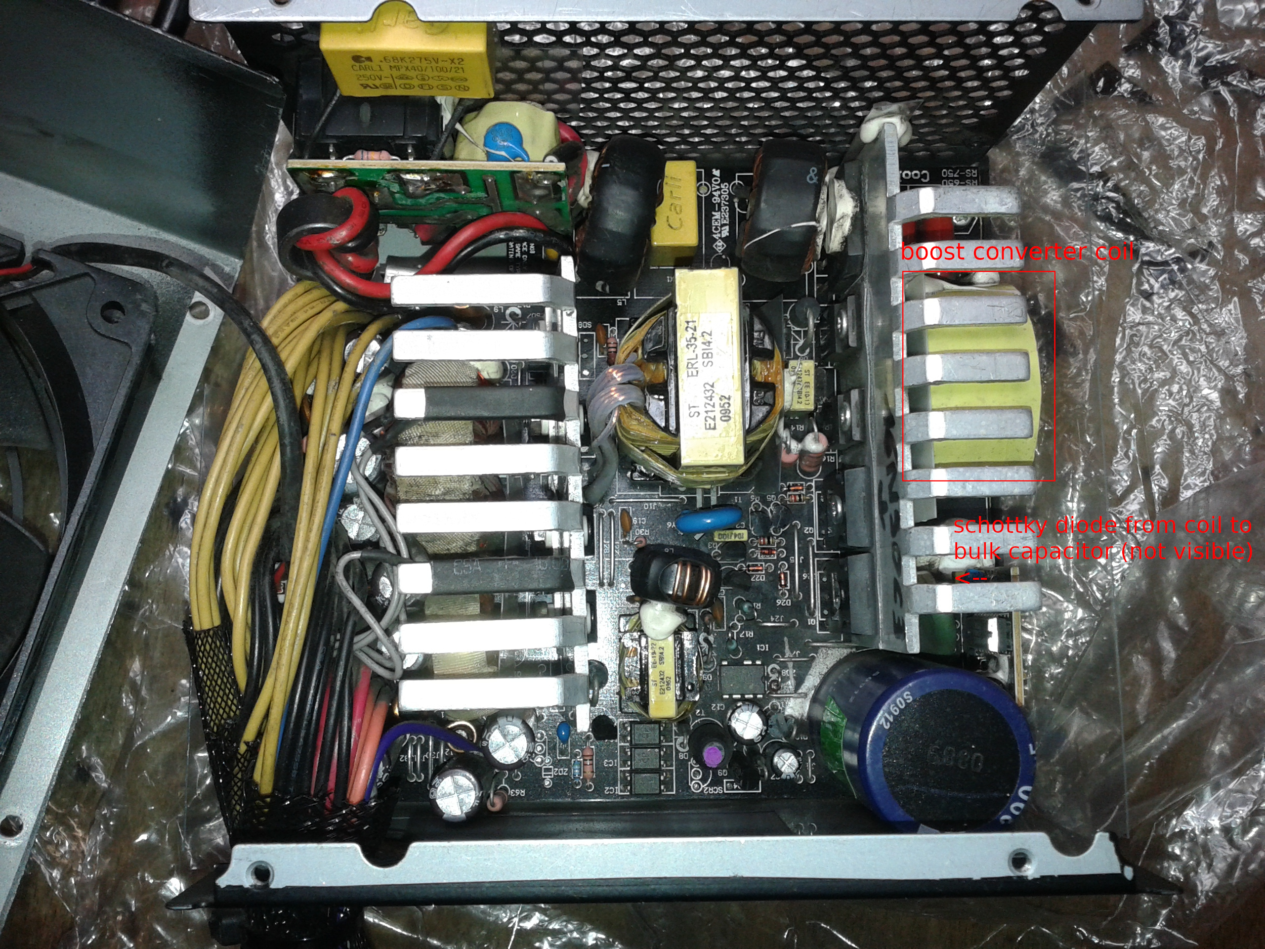

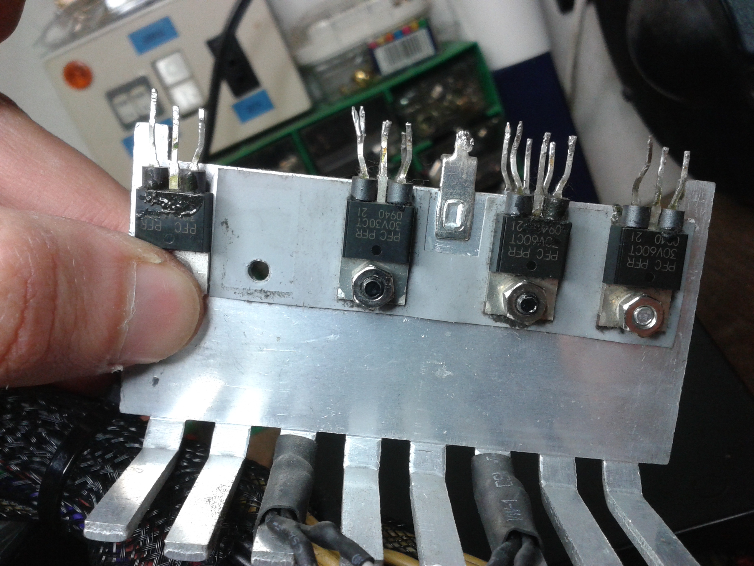

    Images description:
    20230124_185848.jpg and 20230124_185924.jpg show front / rear of the disassembled heat sink on the output side of the PCB.

    Mistake one: if Mosfets are paired, replace both at the same time with the same part numbers. So don’t mix match them. They blow, because one was switching a little faster than the other. Same thing happens with diodes in parallel.
    The TNY27x is your standby power. So this would be always on, whereas the PFC only runs when the PSU is turned on.

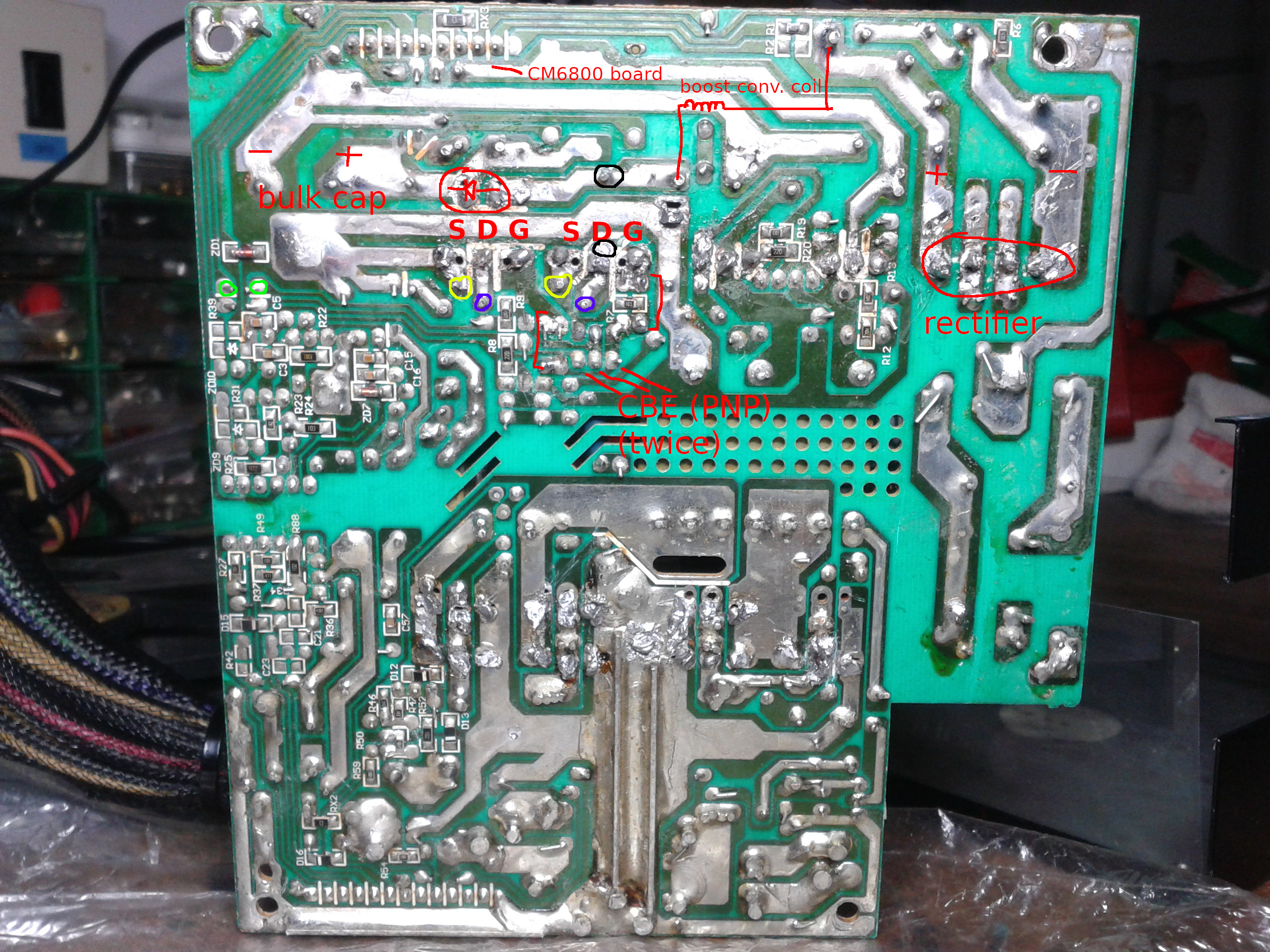

      Attached annotated PCB layout.
      The IRFP460 G D S pins are marked. Green, yellow, purple and black circles indicate jumpers. The two PNP transistors in front of the replaced IRFP460 are marked, with two pairs of zener+resistor connecting both gates, one pair per gate. Both BJT bases are connected to the CM6800 board via the thru-hole resistor (on the PCB components layer, not visible here) that crosses over the SMD R9 on the tracks layer.

        Noted. The overheating I got after replacing only one 16N50C3 seemed exaggerate to be explainable only by a mismatch of response time between the two mosfets, as the remaining 16N50C3 exploded after less than 1 second of uptime. After I replaced this one too with another IRFP460, I'm still getting a warm heat sink after just one second.

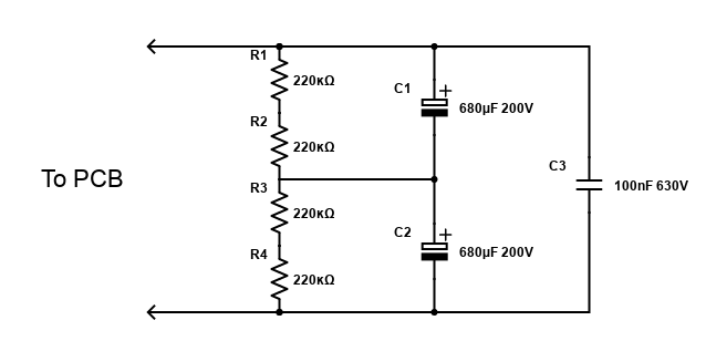

                      I may cram these two spare caps into the PSU chassis and wire them in series, to replace the original cap; they are 200V 105°C 680uF Teapo, so I'd have an equivalent 340uF cap. But perhaps there might still be something else broken on the PCB?

                        If you wire the Teapo caps in series, make sure to add their respective divider/balancer/bleeder resistors as well. Typically these are 270K to 500K. Lower resistance = better balance of voltage between the two caps, but also slightly more heat dissipation (so make sure the resistors have appropriately high power ratings.)
                        There shouldn't be anything else wrong with the board if you found the PSU appeared to work for the short 1 test intervals... but again, wire up a series current/power limiting device. If incandescent bulbs are not available, use halogen ones. The "long-tube" high-power ones (200-500 Watts) I don't think are outlawed, because they don't have anything equivalent in LED versions. So go to your hardware store and check. If not, then use an appliance with a 300-500 Watt heating element (and no "smart" electronics - i.e. the heating element can be controlled by a physical switch and not a relay or MCU.) "Mini" toaster ovens, hair dryers (on low setting), and sandwich makers are good for such use.
                        Finally, consider adding a 0.1 to 1 uF PolyPropylene (metal film) capacitors in parallel with the "main" cap in the PSU. The PP cap can take on some of the high-frequency ripple current from the APFC and possibly give the electrolytic caps an easier time. It should also provide as a "backup" path for the APFC inductor to dump its energy, in case one of the electrolytic caps opens. A 400-450V PP cap might work, but I suggest using one rated for 630V, just in case.

                            Thanks for the suggestions. Today I prepared a "replacement kit" inspired by momaka's suggestion using components I had at hand, with a voltage divider between the two electrolytic caps and a film capacitor in parallel (see schematic) rated 100nF 630V. The 4 resistors are 220ĸΩ 1W which will replace the original 1MΩ resistor on the PCB. The corrugated cardboard box in the picture contains the two caps, which will be squeezed between the two heat sinks leaving about 4mm of clearance, so hopefully the cardboard will insulate sufficiently from the heat.
                            Tomorrow is test day.

                              Schematic looks good.
                              However, I would advise against running such long wires between the caps, the resistor divider board, and the PSU board itself. Such long wires would have terribly-high ESR and ESL at high frequencies. The PSU still might work for a test... but be careful. With such long wires, there will be lots of RF and EMI that other neighboring components could pick up and possibly malfunction.

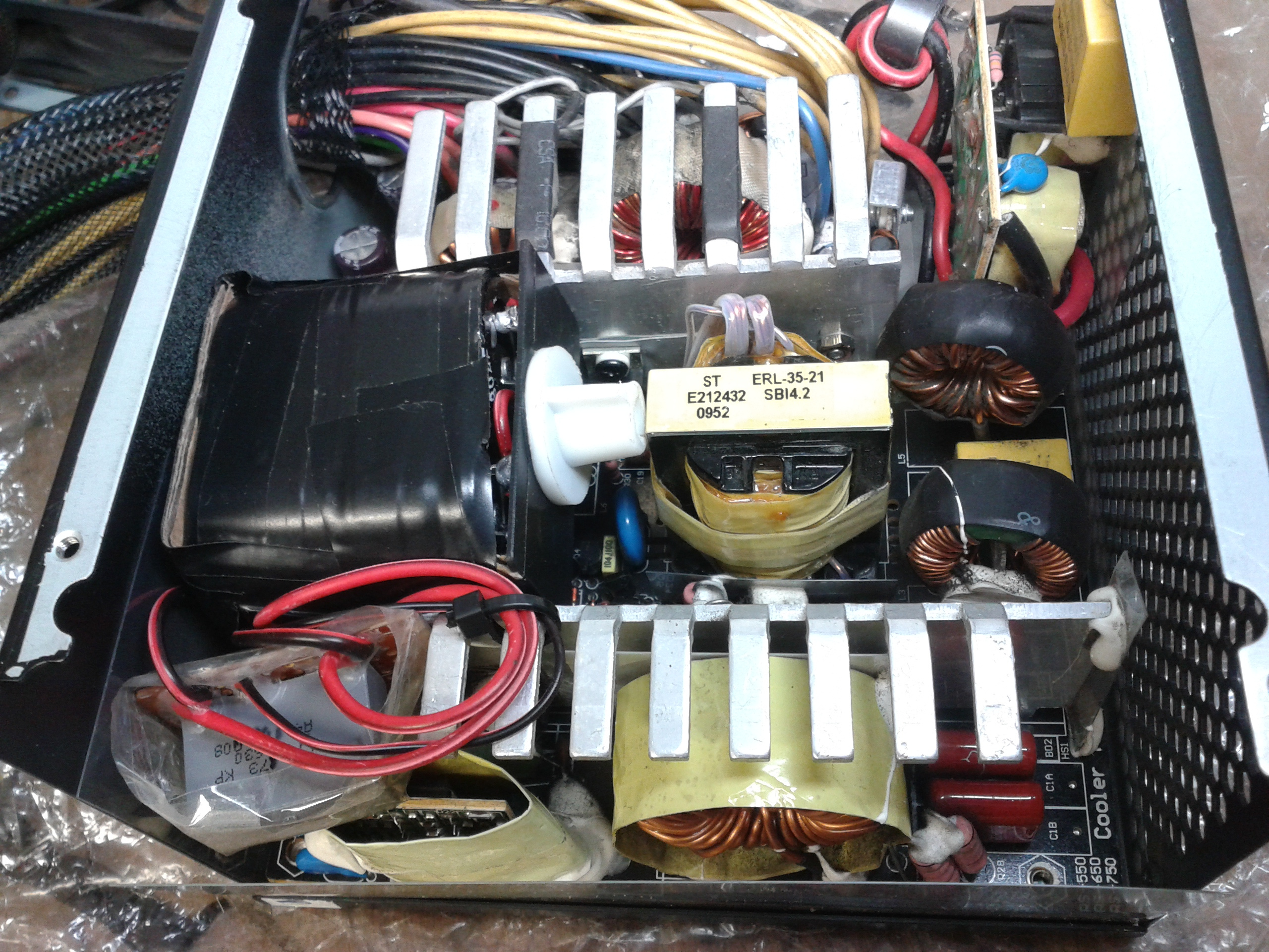

                                It works!
                                This is how it looks now just before I closed the chassis and called it done
                                I did the standby test which yielded 5.1V SB (purple wire) and 4.8V PS_ON (green wire). This time VSB remained stable and precisely regulated at 5.1V for ~30 seconds after I toggled off the wall switch, while in the previous test with the broken cap it began to drop immediately. The bulk capacitors now retained some charge for ~40 seconds past power off.
                                I shorted green to black with the same 20W hard disk as a dummy load. It spun! No overheating from the two IRFP460 and both heat sinks remained cold. Red wire had 5.05V and yellow 12.1V, both within spec. Too bad I couldn't test for ripple with a scope. These voltages remained stable for over a second after toggling off the wall switch, with cooling fan energized and HDD spinning at full speed (estimated on noise) which is expectable as the bulk capacitors hold around 50 joules at 380V. I left it running a few minutes and all remained stable and cold. I put it into a storage box, vacuumed the mess in the workshop, and I'm done with it!
                                Confessions: I was too lazy to fix or trim the long wires... as I already glued them to both boards (the PCB and the "kit" board) and taped them for extra strength, but at least I routed them above the heat sink, somewhat away from EMI sensitive stuff; there's about 3cm from the wires to the CM6800 itself, hopefully it's enough. The resistance of these wires should be negligible, around 10mΩ [1], only the center wire of the voltage divider is thinner to help with identification, as it's not supposed to bear high currents and I didn't have a choice of wire colors, only of gauges. But I'm not sure about the ESL. One day in the following weeks I'll take it out of storage and mount it into my workstation to properly test it under full load tripping the UPS.
