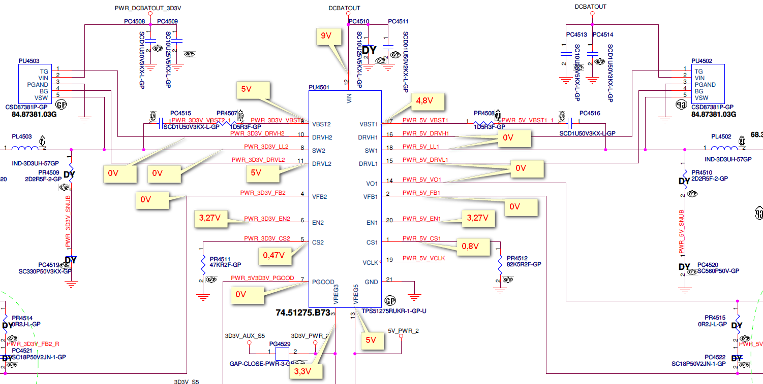

        • sellit
          • Jun 2017
          • 105
          • Latvia
          Re: Dell Inspiron 14 7437 no power, need schematics
          Attached picture with voltages I get on PU4501.
          • BlueMidnight
            • Jan 2015
            • 489
            On this board, the BQ24715 (PU4404) doesn't just charge the battery. It also powers the main system rail (DCBATOUT). So the DC jack voltage stops there, and it uses the PU4406/PU4407 MOSFETs to create voltage on DCBATOUT. Anything from 9-20V is fine. And PU4501 can operate on anything from 5-24V.
            The most likely bad components are PU4501 and/or PU4502 and/or PU4503. The first thing I would personally do is test PU4502 and PU4503. They are just 2 MOSFETs in one package and they should be testable just like separate MOSFETs would be.
            I notice that PU4501 has latched PU4503 in the overvoltage protection configuration (with the upper FET turned off but the lower FET turned on with 5V on pin 11 of PU4501). That might mean there's something wrong with PU4503, but could just as easily mean PU4501 is bad, etc.
            • sellit
              • Jun 2017
              • 105
              • Latvia
              Thanks for help. Purchased PU4501, will give an update after replacement.
              • sellit
                • Jun 2017
                • 105
                • Latvia
                Replaced PU4501, made no difference. Purchased PU4502 and PU4503.
                • sellit
                  • Jun 2017
                  • 105
                  • Latvia
                  Replaced PU4502 and PU4503, no difference. The same voltages. Can I inject on some pins voltage to make it work? Like PGood or DRVL1.
                  • mielta
                    • Apr 2015
                    • 368
                    Hi
                    You must check Pgood Pin7 it must be 3.3v it goes to Side 17 from the schematic
                    Q1701
