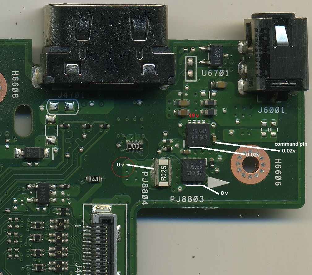

    the power jack was broken , make a short circuit, i power the board with 19v but no power, no battery charge. I was able to recharge the battery, now laptop starts on battery
    I edit a photo from internet with my voltage , i did not find schematic for this model , possible that A5 KNA 9P0503 is good , but is no vontage on command pin.

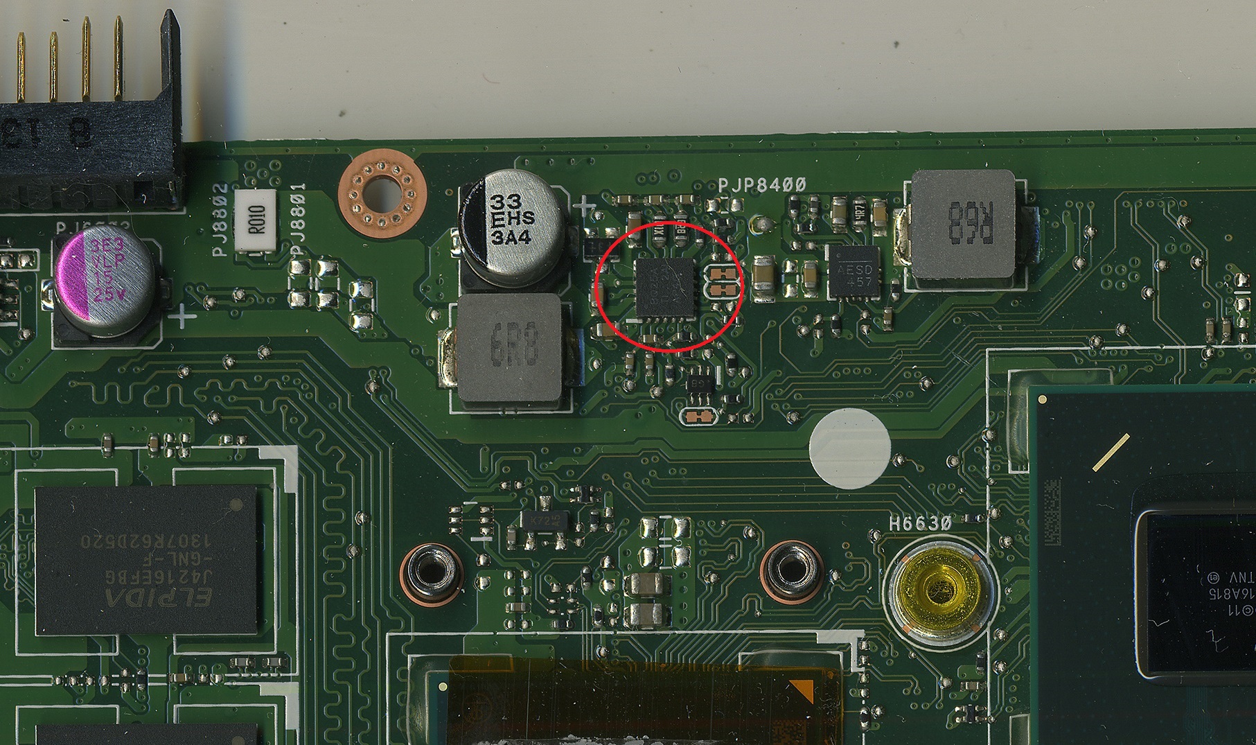

                  BQ25A voltage?
                    Re: Need Schematic for Asus X200CA REV 2.1
                    ok , i will check . tks

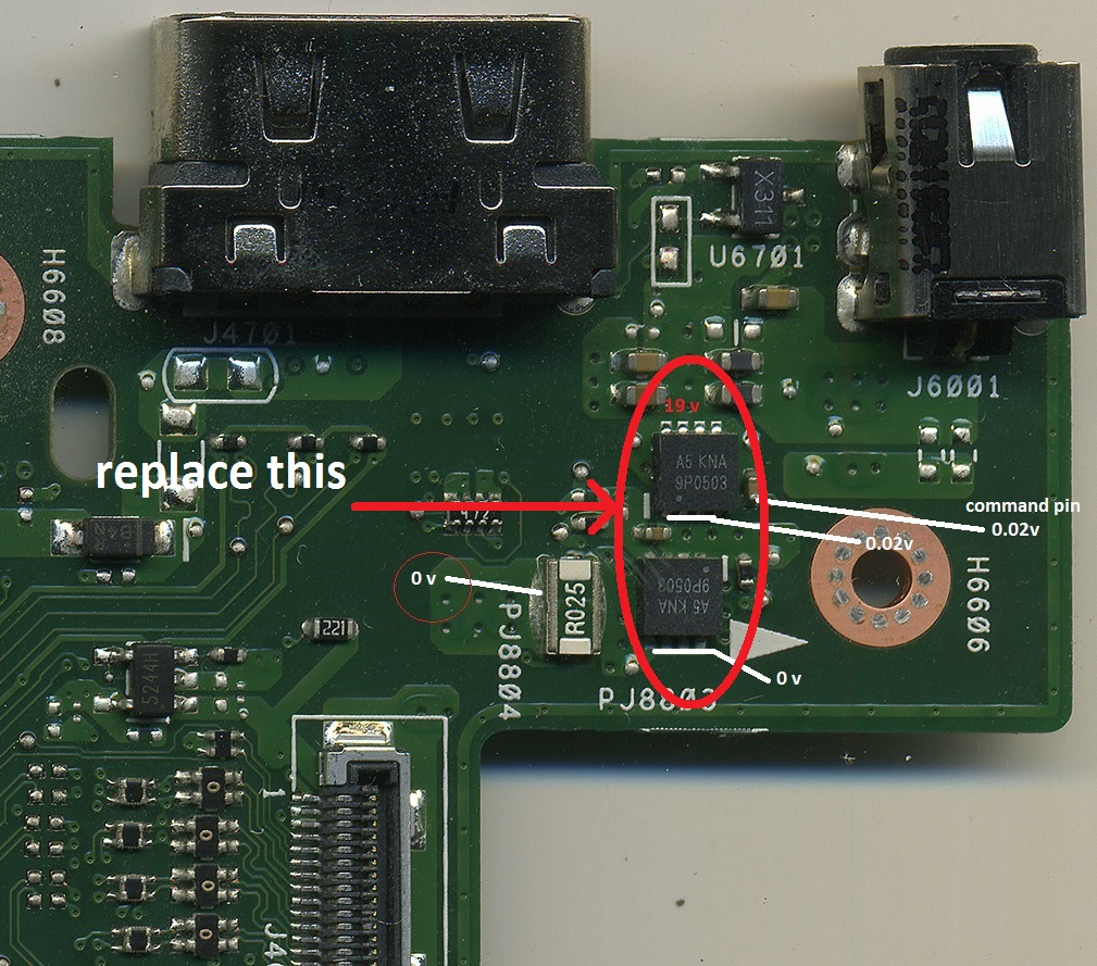

                        here often fails one of two base power mosfets, or transistor on driver to them

                              hi,
                              replace the first two mosfet: P0903BEA N-Channel
                              here the datasheet of the mosfet:
