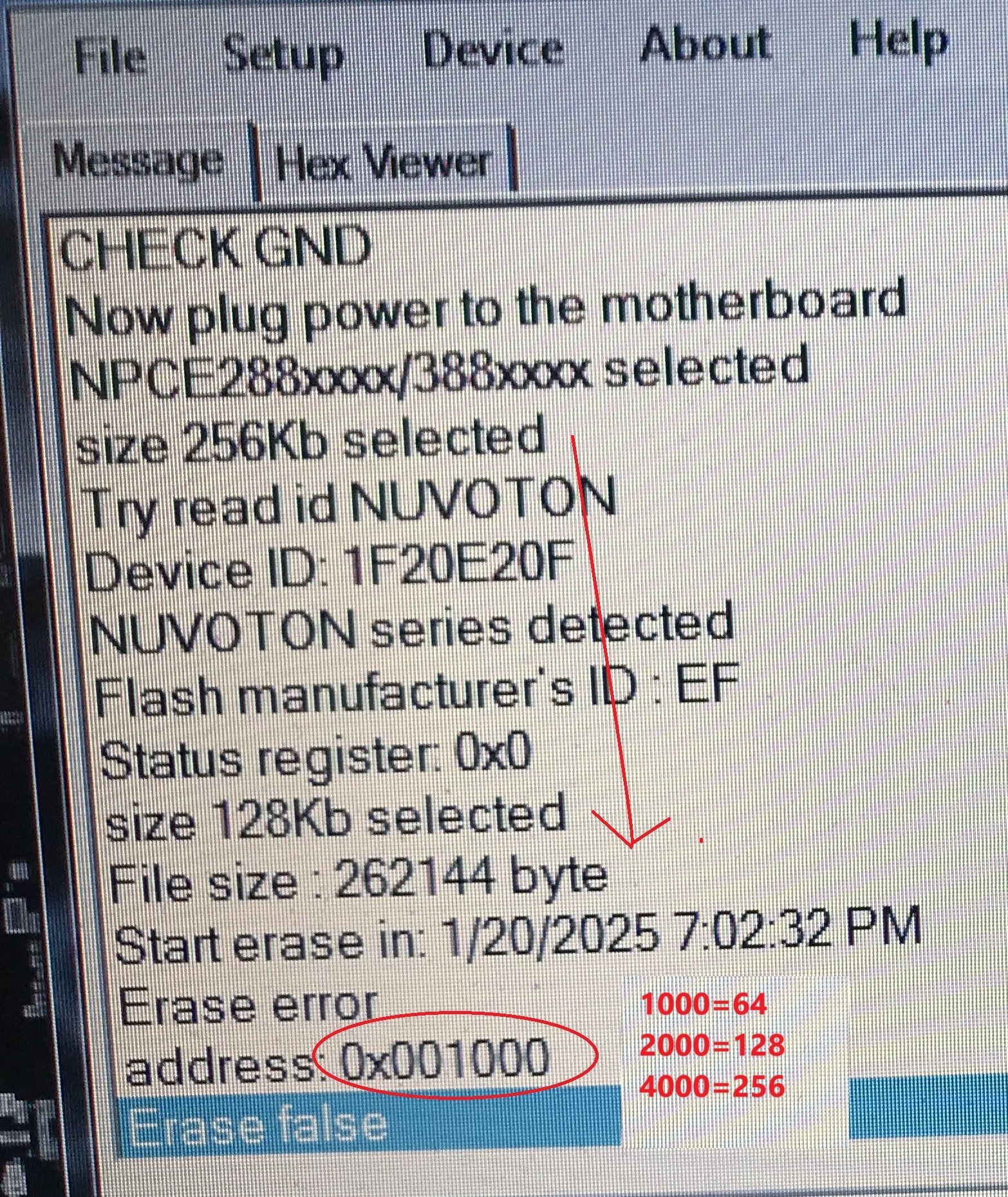

      I tried for you on L390 Intel. I think it's npce288. It worked perfectly
      128
      Click image for larger version  Name:	image.png Views:	0 Size:	487.0 KB ID:	3553109
      256
      Click image for larger version  Name:	image.png Views:	0 Size:	468.1 KB ID:	3553115
      write
      Click image for larger version  Name:	image.png Views:	0 Size:	266.4 KB ID:	3553117
        try to select 256Kb and see if reads 256Kb. I see you got the same ID as mine.

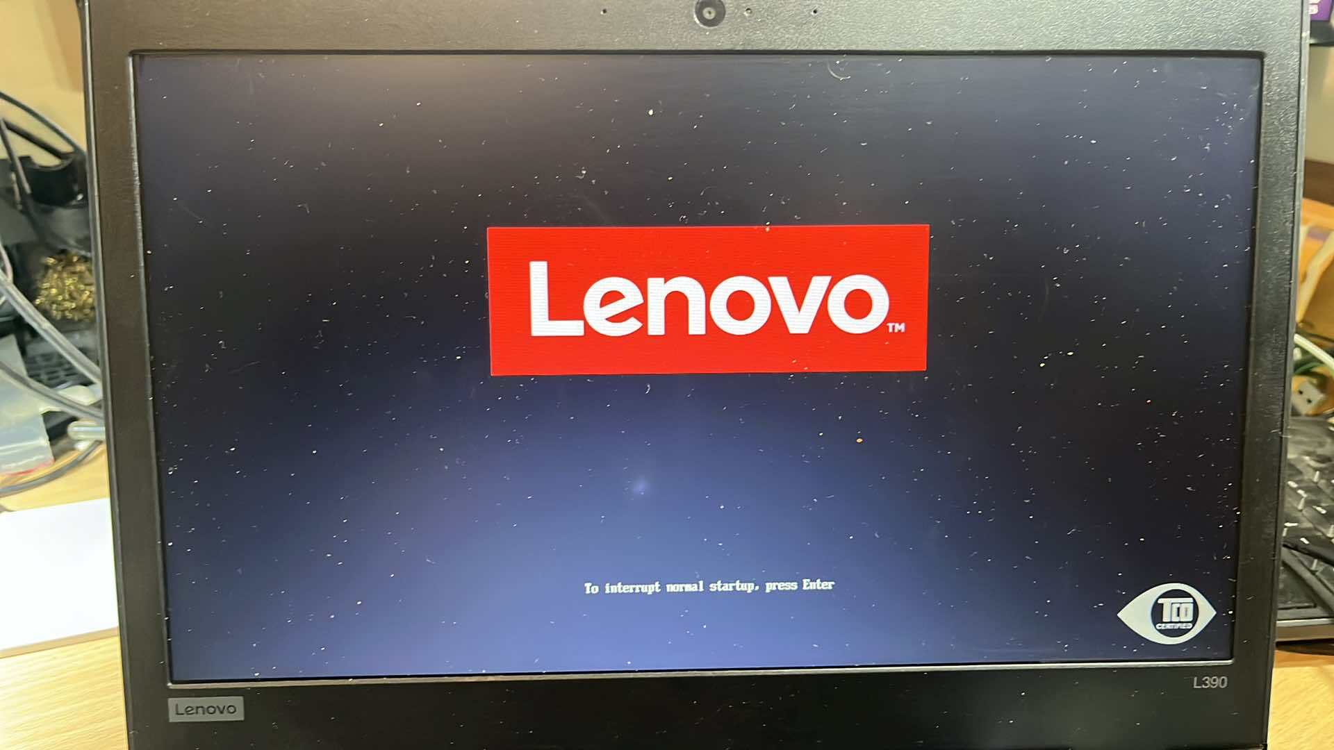

              just after write, never rebooted with my original file in 256
              consumes a little 0.5/6 a few seconds, does things, the screen moves a little and after finished. I tried clean which I did with the Lenovo site the same. It worked before flash
              Edit I used an old version, and the same thing
              I didn't understand.
              But by long holding the power button and pressing it again,
              it restarted!
              I didn't understand why,
              it didn't start on its own. No CMOS or battery
              Click image for larger version  Name:	473633362_1152979846835799_6576057015072801552_n.jpg Views:	0 Size:	92.6 KB ID:	3553148
              I will try again with the new version
              double edit
              and now it works with new version and reboots alone.
              I don't understand anything anymore.
              the power button which was incorrectly placed and pressed alone therefore power off??​

                even I select 256Kb when I hit "read ID" it sets back to 128Kb
                Select 256 after read id

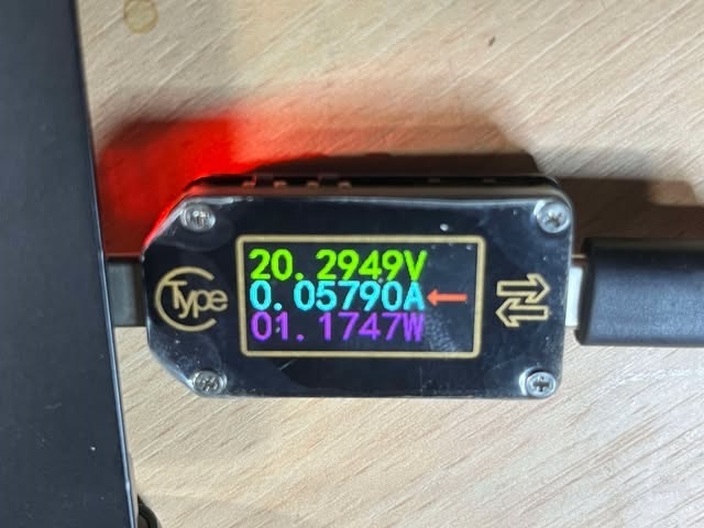

                                ON ebay Joy-it JT-TC66 or Joy-it JT-TC66C (with Bluetooth)
                                I'm happy with it
                                after that I have several different ones, but I use this one most often.
                                I have to buy this one next time
