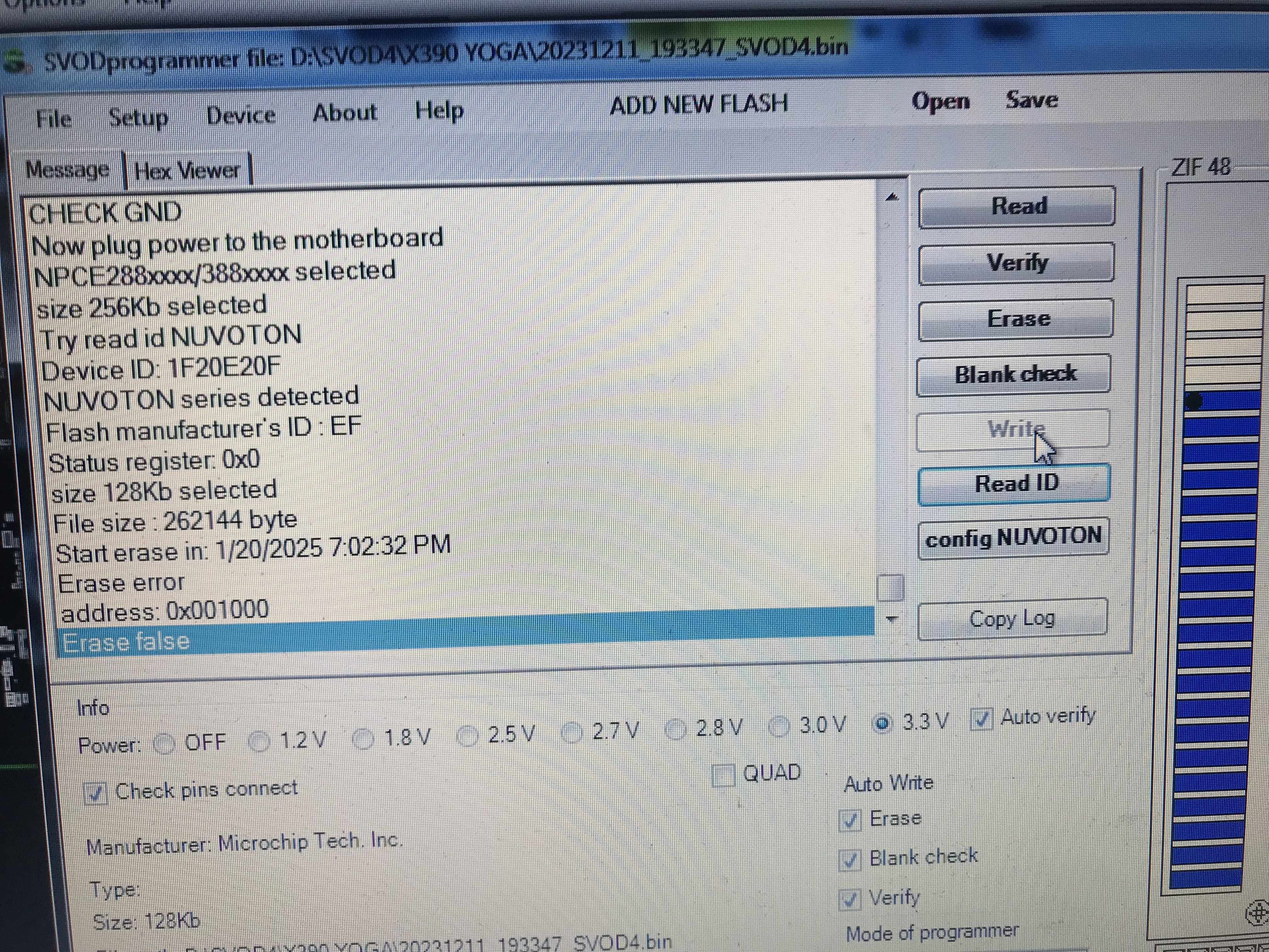

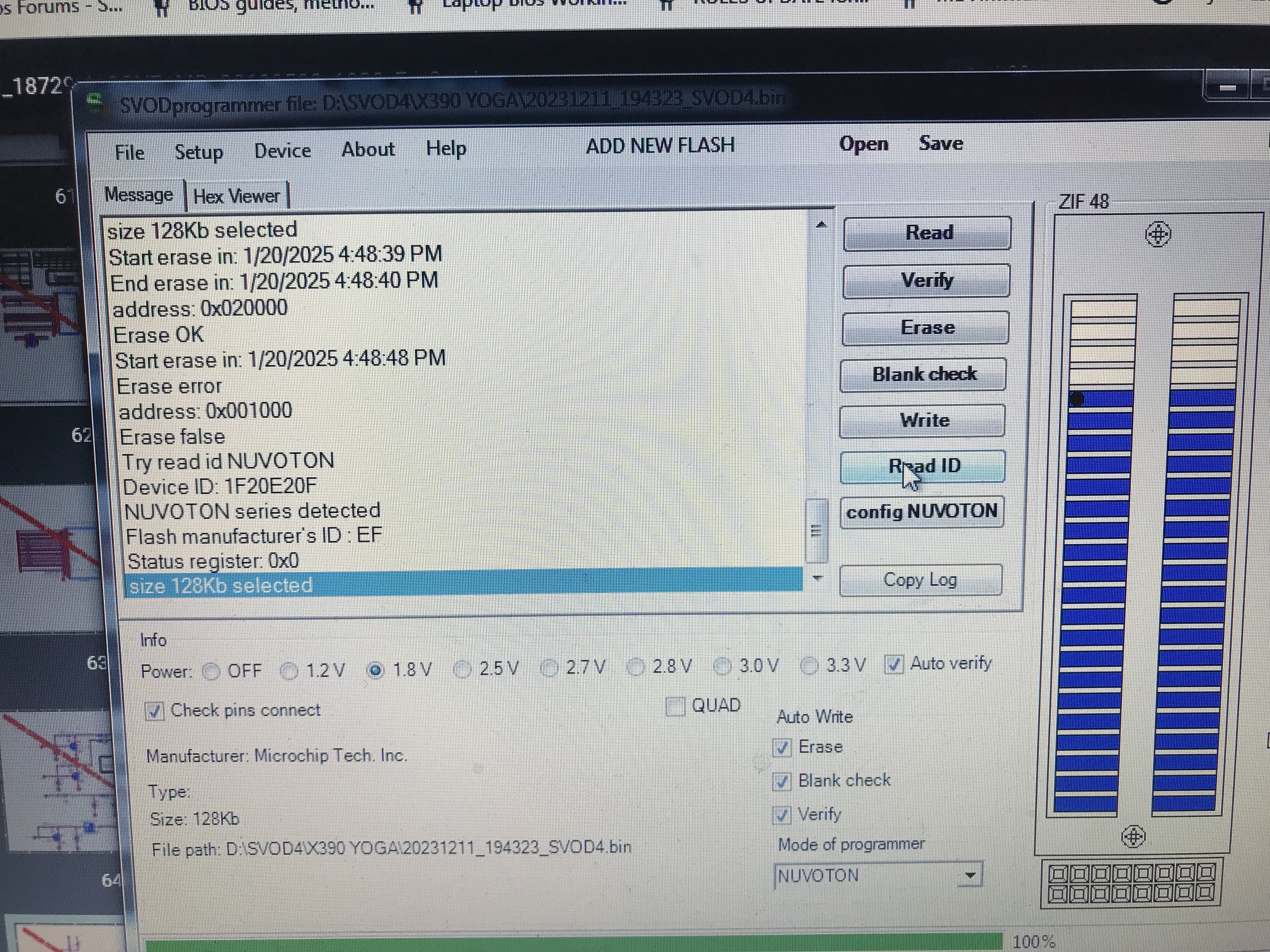

                    I need some help with X390 yoga, please.
                    SN: R90X9EZQ
                    MB: LBB-1 18729-1.. 448.0G105.0011
                    EC: NPCE388PB0BX
                    Laptop doesn't start.
                    my problem: no matter how I set SVOD4 programmer it reads ID: 1F20E20F but it sets eeprom area to 128Kb. Can't erase or write, it reads only 1F1F.... all 128Kb. even I set Nuvoton to 256Kb when I hit read ID it sets back to 128Kb. Below are some photos with programmer settings.
                    thanks in advance.
                      • 21996
                      SN: R90X9EZQ
                      EC: NPCE388PB0BX
                      thanks in advance.
                      Why does it read at 1.8V but write at 3.3V ,is that normal. I don`t own a SVOD so excuse me if its normal.
                        and size of file .128 selected file 262142
                        128 or 256 ??
                          no matter what voltage is set, EC is powered when adapter is plugged in, not from programmer.
                          • volinakis
                            • Jan 2021
                            • 2874
                            • N/A
                            128 or 256 ??
                            even I select 256Kb when I hit "read ID" it sets back to 128Kb
                            • Maxpower3
                              Bad Veteran
                              • Feb 2018
                              • 1356
                              • France
                              often I have to put 1.8 if there is 3.3 it doesn't work. I don't see the chip. It did it to me again 2 days ago​
                              • volinakis
                                • Jan 2021
                                • 2874
                                • N/A
                                yep, but as you can see in photos it reads ID even is 1.8V or 3.3V
                                • Maxpower3
                                  Bad Veteran
                                  • Feb 2018
                                  • 1356
                                  • France
                                  I didn't even see that you were the author of the post, leave 1.8V I already had problems writing in 3.3v
                                  did you manage to read correctly? I just made one
                                  edit ha no thin it's intel, mine
                                  what's the equivalent?
                                  AMD X395 or X13 or T495 available
                                  • volinakis
                                    • Jan 2021
                                    • 2874
                                    • N/A
                                    I didn't even see that you were the author of the post, leave 1.8V I already had problems writing in 3.3v​
                                    yep! I am! I remember doing another x390 yoga with NPCE388 and had no problems, I didn't even set motherboard, just selected Nuvoton, set to 256Kb and powered motherboard and hit read ID. This one is stubborn!

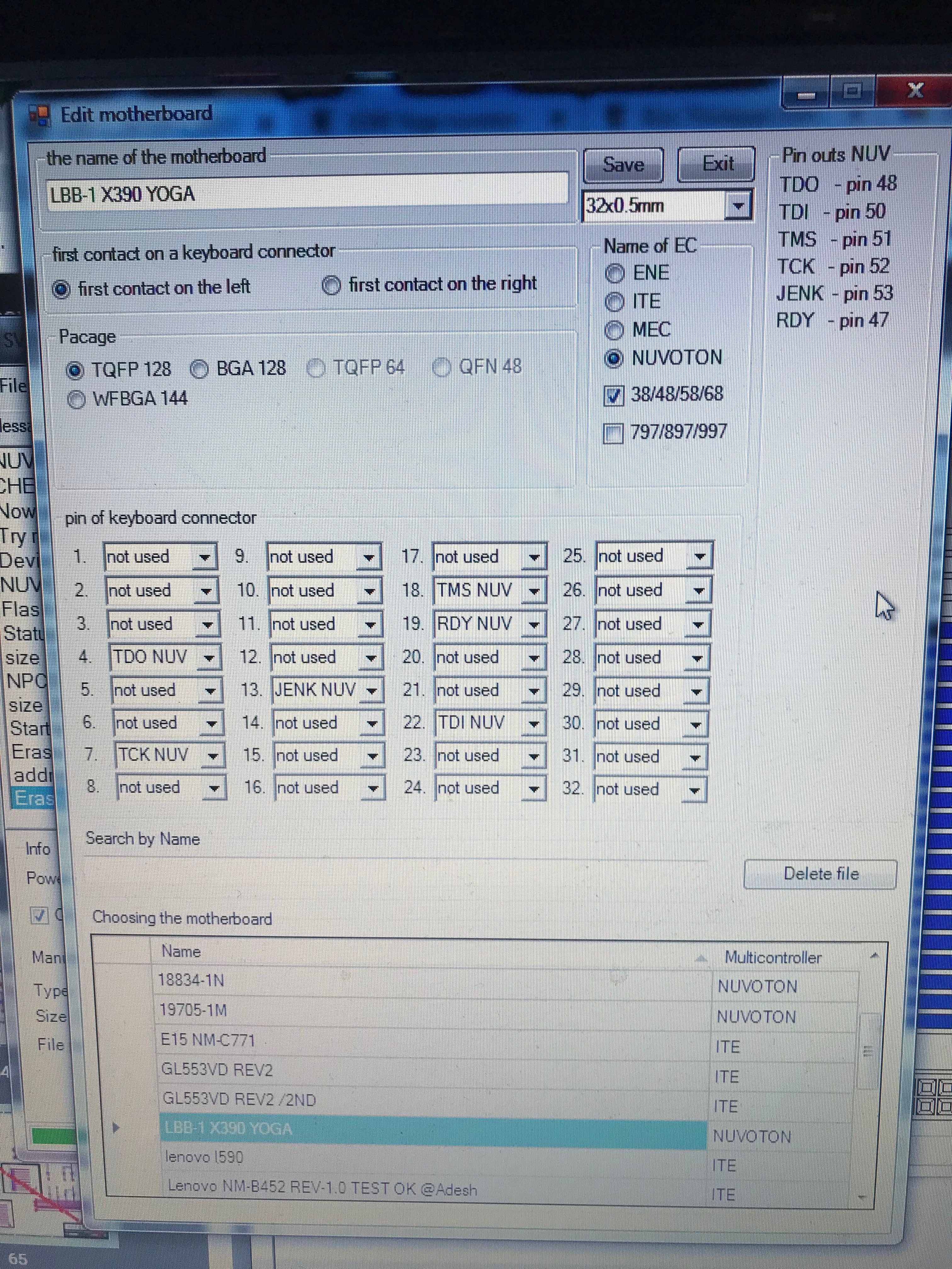

                                    • Maxpower3
                                      Bad Veteran
                                      • Feb 2018
                                      • 1356
                                      • France
                                      you know all that but there are images
                                      no need select motherboard
                                      https://www.badcaps.net/forum/troubl...ide-with-svod4
