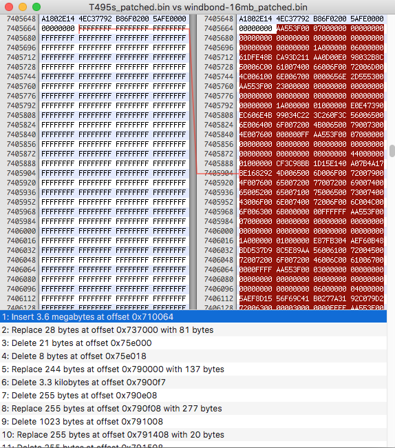

        volinakis franklinogot The patched bios worked like a charm, I did not even have to remove the winbond chip (I used clips), clean & quick method. Thank you very much! :-)
        • volinakis
          • Jan 2021
          • 2873
          • N/A
          which patch did you use? mine or the other one? because they are different.
          • 3mz3t
            • Sep 2023
            • 13
            • Slovakia
            volinakis I used yours (I assumed the other one uses the same mechanism).

              nope, the other one doesn't even have NVRAM volume cleaned. I am sure it will not work.
