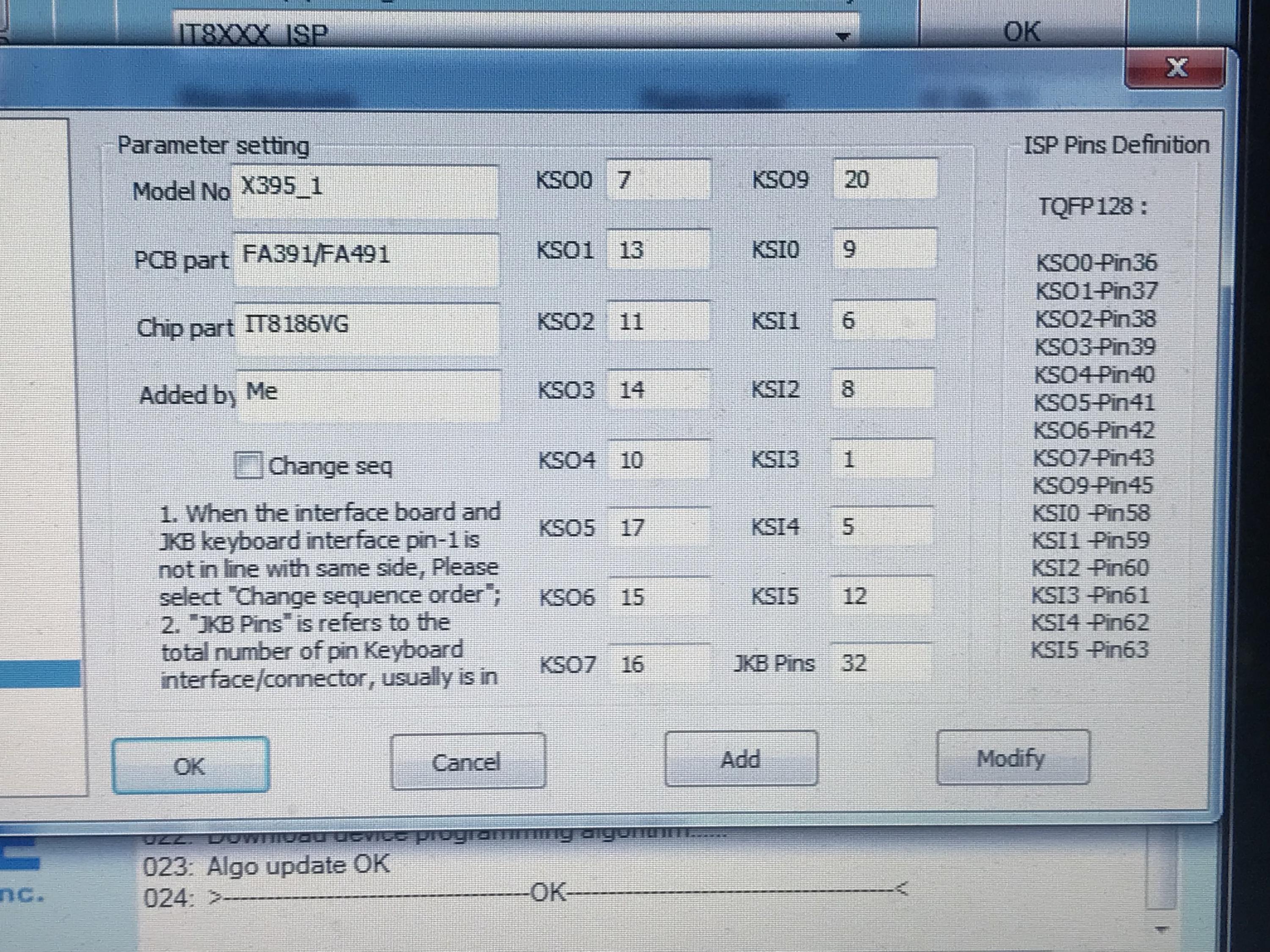

    ThinkPad x395 attempt at password removal
    Did some experimenting to try supervisor password removal ... initially laptop has supervisor password and no computrace. I erase IT8186VG controller, it self-reprograms upon booting with serial number errors and supervisor password is gone but to my surprise computrace automatically activates ... I program a clean bios file downloaded and cut from website and upon booting, self-healing activates and upon checking setup, password still gone but computrace remains activated ... I write back backups of both Bios and EC and things are back to normal, that is supervisor password is back and computrace is off... I also noticed that removing UL5 (MX25L80) from the motherboard stops Bios self-healing so that's probably where backup is stored. So long story short, I'm back to square one ... anybody had success unlocking? I think the whole secret lies in the EC firmware ... still can't wrap my head around what's causing the computrace to activate ...

    What programmer did you use to erase IT8186VG?

      Re: ThinkPad x395 attempt at password removal
      Svod 3

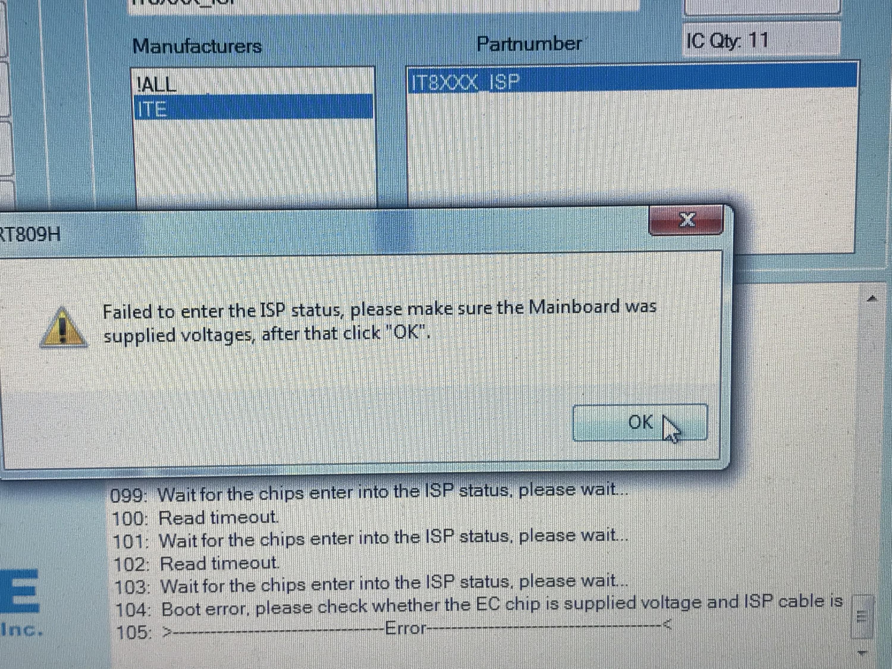

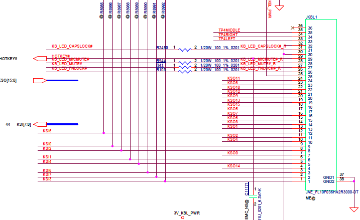

        I also have a X395 with password, I did try to unlock it with RT809H but no luck. I set up lines as in schematics, I used a 24pins FFC cable but I get "failed to enter the ISP status". UL5 is linked with ethernet controller, I erased it and nothing happened, no bios recovery, all DMI data shows in bios, so...
        Maybe someone with more experience take a look and tell me what I did wrong or if RT809H is able to read IT8186VG. 24pins FFC cable I used is B-type - reverse contact.Thank you.
