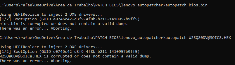

                    I have one Lenovo X395 (japanese) and need remove Supervisor Password.
                    I read my BIOS (25Q80DVSIG) but I get a error when try to patch (BIN Zip attached).
                    Model: X395
                    Type: 20NM-S1PG00
                    SN: PC-1FBBDX
                    It would be great if anyone could help me.
                    Thank you :-)

                      #50
                      Model: X395
                      Type: 20NM-S1PG00
                      SN: PC-1FBBDX
                      Thank you :-)
                      Sorry, wrong chip.
                      The BIOS chip is near the CPU
                      You uploaded the Thunderbolt chip.
                      The BIOS chip is UC3 16MB or W25Q128FW...
                      • rafaellguerra
                        • Jul 2025
                        • 6
                        • Brazil
                        #51
                        Originally posted by Markus1741
                        Sorry, wrong chip.
                        Thanks Markus1741.
                        This is correct file. Can you help me ?

                          #52
                          Thanks Markus1741.
                          Ok here the new file.
                          It is important to understand that the autopatcher was written for Lenovo Intel CPU, and a hash value must be changed in Lenovo AMD CPU (which I did) everything further described as in the autopachtcher.
                          Have fun
                          • rafaellguerra
                            • Jul 2025
                            • 6
                            • Brazil
                            #53
                            Have fun
                            I hear several beeps (like music) and no image appears.
                            I try to patch here and the result is same (sounds and no screen)
