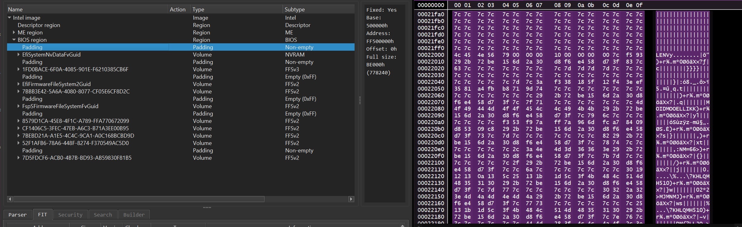

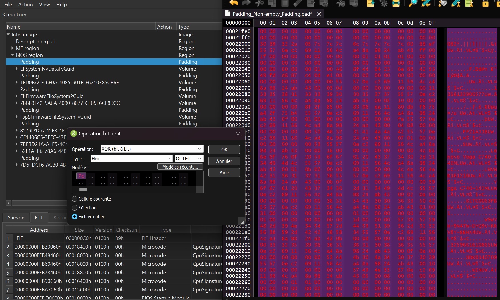

                              Originally posted by bumper1
                              I used bios from post #6 to test and it's working. But when I copy from old bios DMI .
                              What area should I copy?
                              Here DMI and Win key
                              Cliquez sur l'image pour la voir en taille r?elle   Nom : 		DMI LENV.jpg  Affichages :	4  Taille :		521,9 Ko  ID : 			3325725
                              decode with Xor
                              Cliquez sur l'image pour la voir en taille r?elle   Nom : 		decode.jpg  Affichages :	3  Taille :		565,1 Ko  ID : 			3325726
                                • 22109
                                I think the problem was he added his DMI to the bios at post 6, and that bios has the Debug section (9C) .His DMI 7C ,the 2 don`t play well together.To copy his DMI to the bios at post 6 he would have had to include the debug section as well 520000 - 523FFF
                                .The bios at post 5 has no debug section as its a virgin bios,only the DMI needed copying to it 522000 - 523FFF
