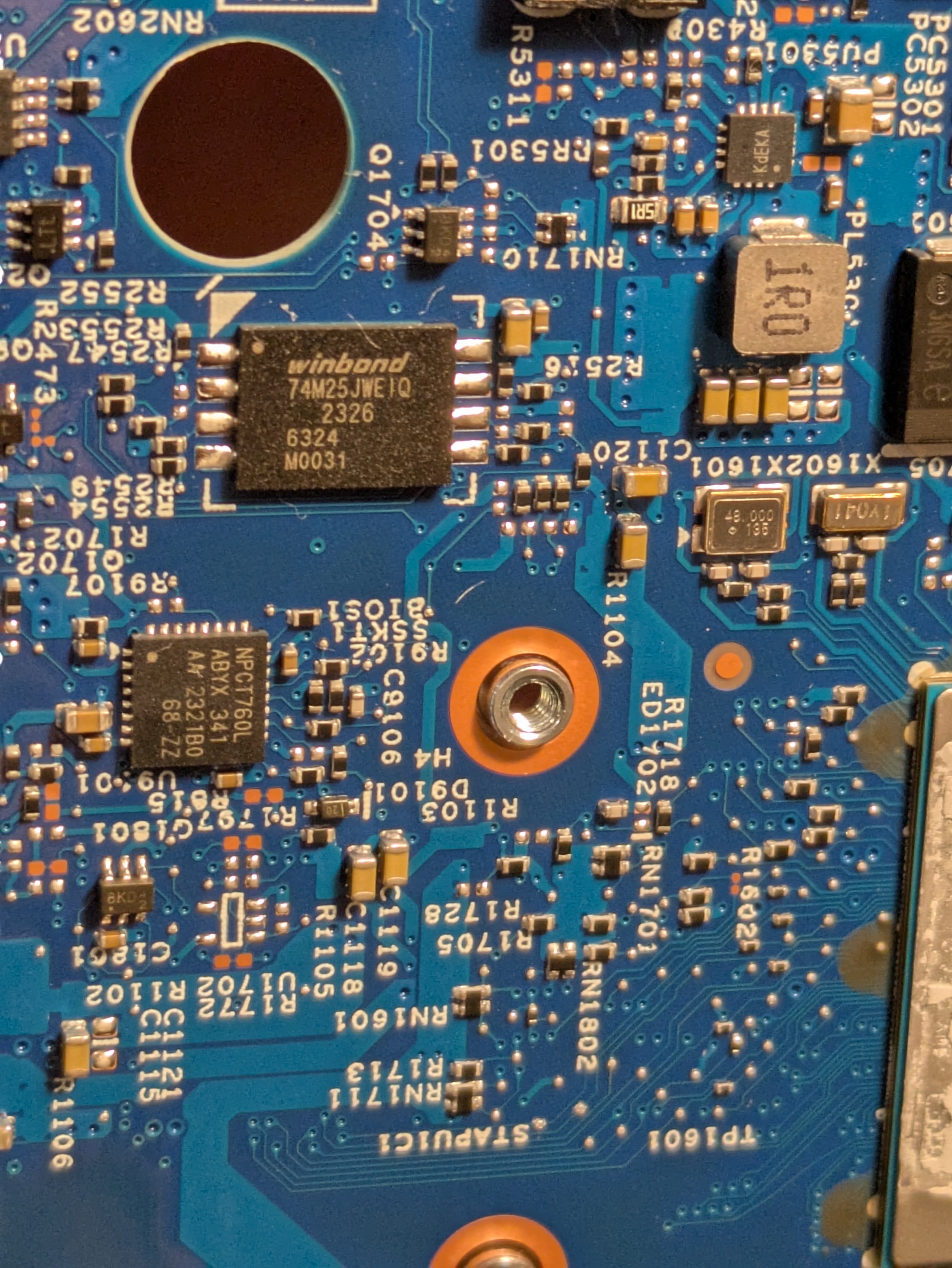

    Somehow an auto update, which I triggered before I left my laptop unattended, bricked my BIOS.
    I was able to extract the 2MB BIOS and 16MB BIOS which I will attend. (CH341B black with NeoProgrammer 2.2.0.10)
    The Device is a Lenovo Yoga L13 Gen3 and I was able to identify the following specifications:
    Lenovo Yoga L13 Gen 3 AMD:
    Lenovo Modell: Type 21BB
    Artikelnr.21BB006GGE
    Seriennummer: PW0A6207
    AMD Ryzen™ 5 PRO 5675U
    Memory 16 GB DDR4-3200MHz
    SSD: 512 GB SSD, M.2 2242, PCIe Gen4, TLC, Opal
    Display type: 13,3" WUXG
    System Board:
    Lenovo BDPLANAR R5PRO 5675U,16G,RZ616,YdTWINyAB
    Repalcement Unit: 5B21H47118 (System Board)

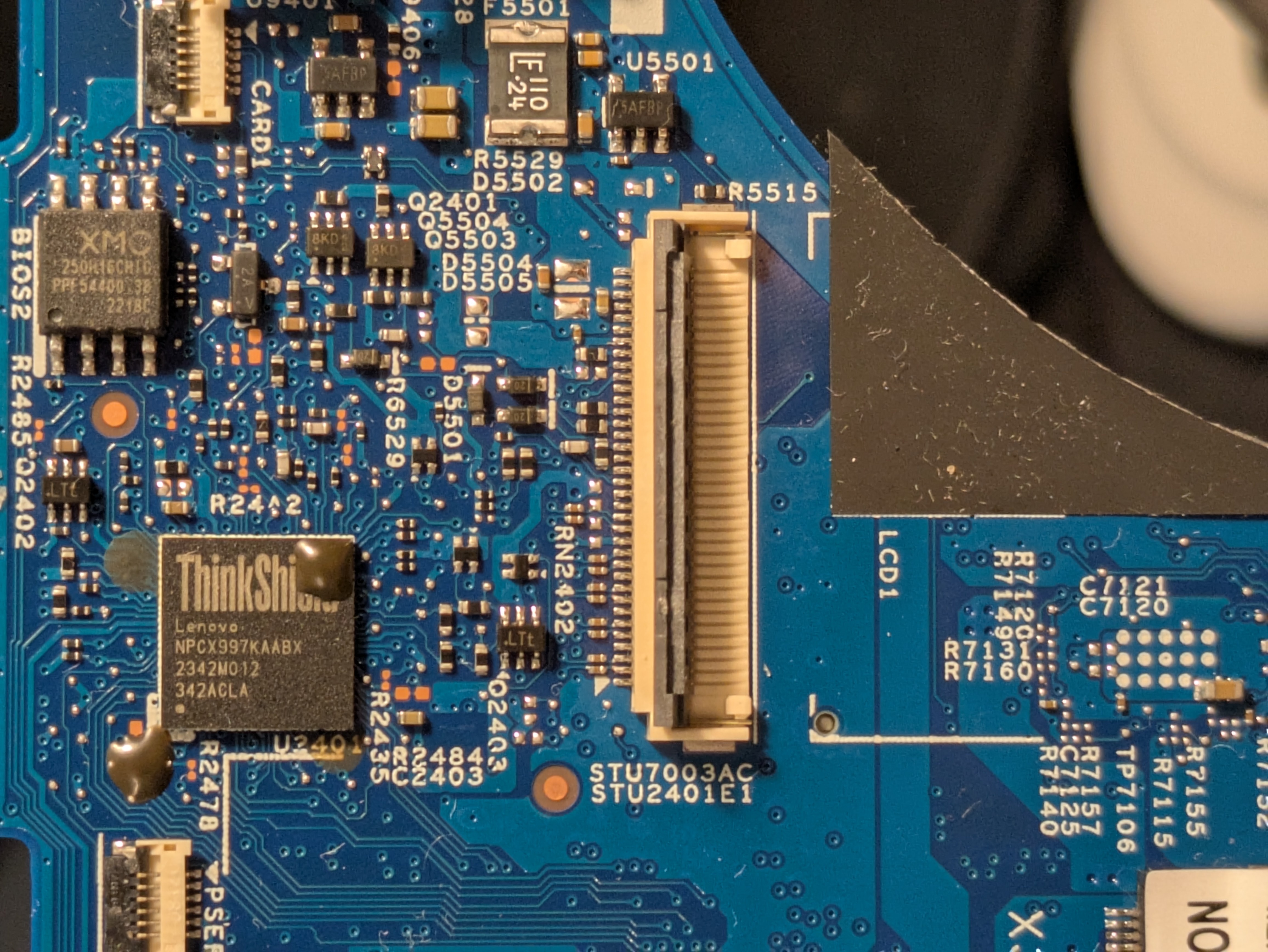

    2MB Chip: XMC XM25QH16CHIG
    32MB Chip: Winbond 74M25JWEIQ 2326 6324 M0031
    BIOS: Update
    Problem:
    At first The Escape and F1 LEDs were providing some light but no further reaction. I used the hardware reset button and now the LEDs aren't shining anymore. Nevertheless, tried everything to recover the laptop, support-Keyboard and Power kombinations, nothing worked so far, could any of you be so helpful and assist me with a useful BIOS binary?
