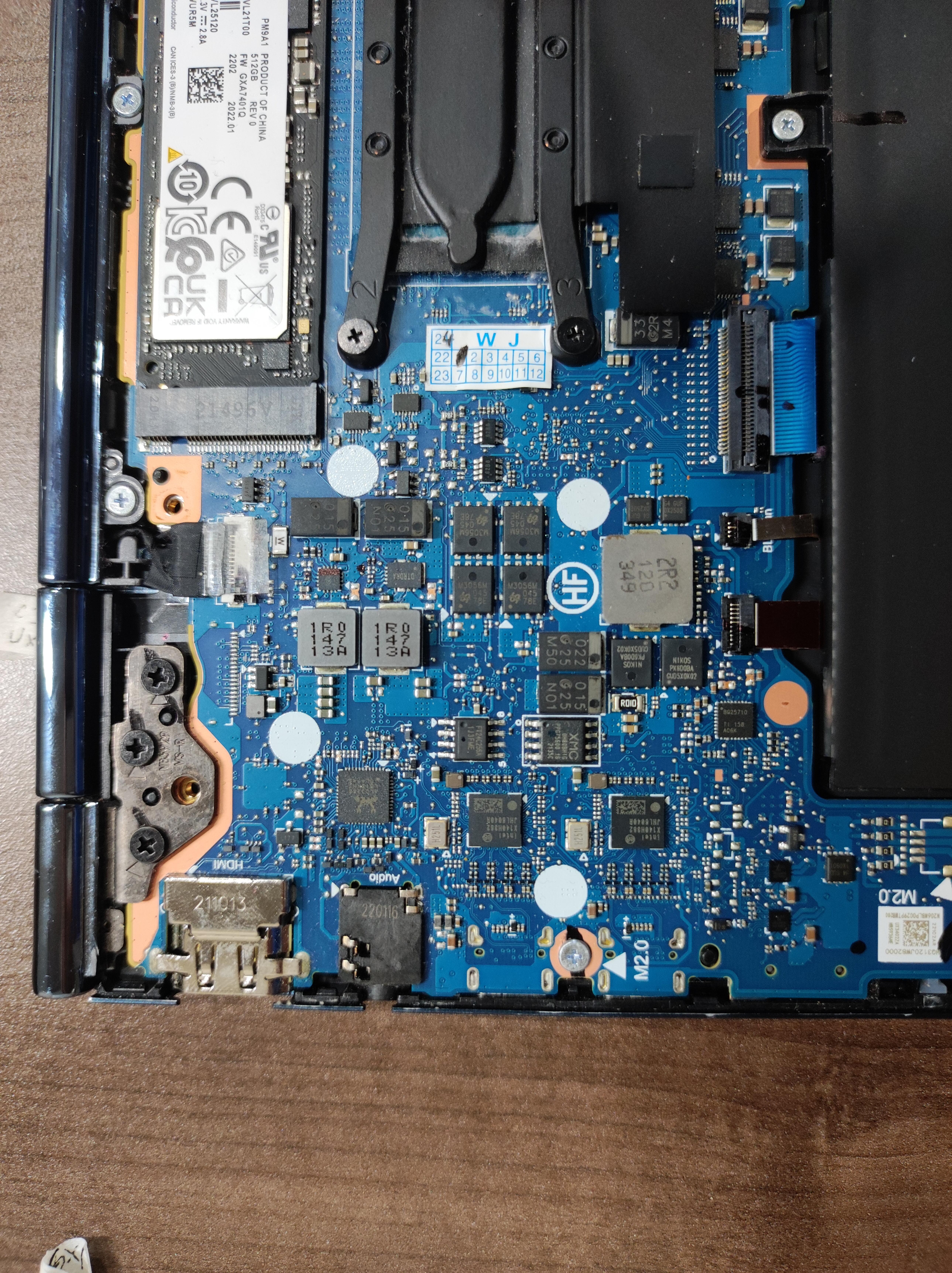

    I have and Asus Q409ZA that I purchased new, and all was well until it eventually turned on to a black screen.
    I backed up my original BIOS. I then downloaded and flashed an engineering BIOS posted by another member. It works great until something updates and the laptop starts up to a black screen, no activity. It can be reflashed with the engineering BIOS and work again until etc. etc.
    I've attached the original dump of this laptop with its serial number and other information in tact. I've also included the new engineering BIOS. Maybe somebody could take a look and find out what the problem is, or rebuild my original.
    Laptop : Asus Q409ZA (UX3402ZA)
    S/N: N2N0LP00C329067
    Motherboard : NB5936 V3.0
    Thanks!

    I managed to repair my original BIOS (so far) using the ME guide and doing a LOT of digging for v16 tools.
    Major breakthrough, feels great to finally be back to using the original BIOS on this laptop. Hopefully it will last.

        Hi, I have the same laptop and am currently facing the same issue. I have bought a ch341a from amazon, but I am very new to this stuff. I can't identify the bios chip. Could you help me identify if the bios chip is the one in the image below. Also, is it ok if I just flash the Engineering BIOS given or do I need to update anything on it. (I sent it for repair before trying myself but the repair guy ended up losing my original bios file without fixing the issue.)
        I am also attaching another working BIOS file I found. Should flash that instead of the engineering BIOS? (Should I just replace all the SN on this BIOS and flash it?)
        Thanks for the help.

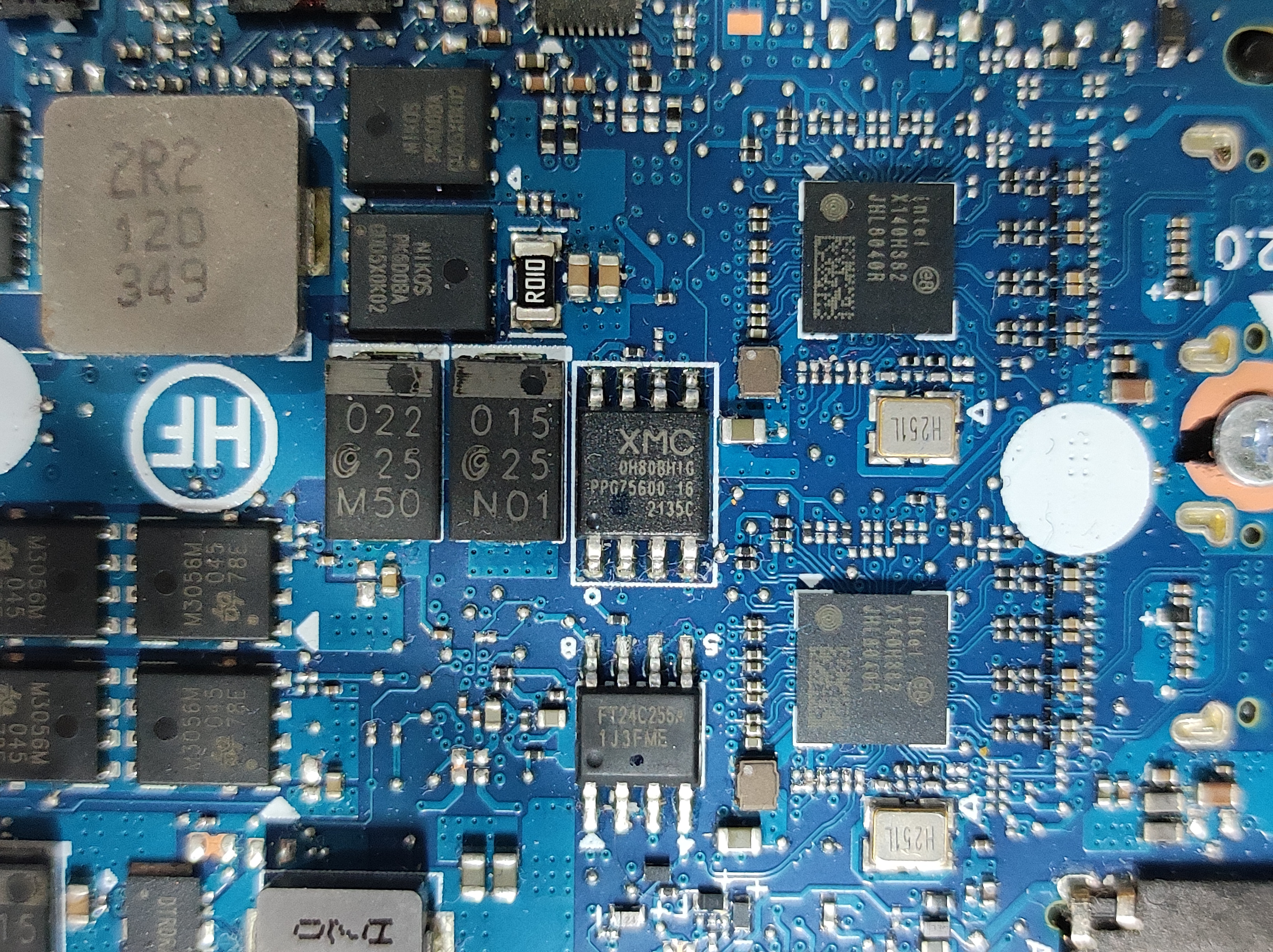

          Find the chip with the number 256 on it. For example: 25Q256xxxx

            bios chipset is on the other side of motherboard

              The Bios chipset is on the other side of the motherboard
              Thank you so much. I found the chip on the other side (as shown in the image below). Please correct me if I'm wrong.
              I tried a SOIC8 clip that came with my programmer, but it didn't connect properly. Would I need to desolder it using a hot air station? (Or would a standard soldering iron be enough?).
                yes, that's the bios chipset. you have to desolder it

                  I just ran some wires directly to the test pads around the IC, much safer and less work than taking hot air to the board.
                    yep, wires and CH341A = perfect combination for a disaster
