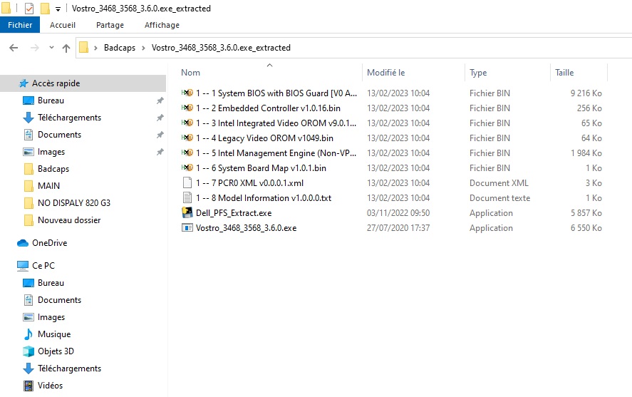

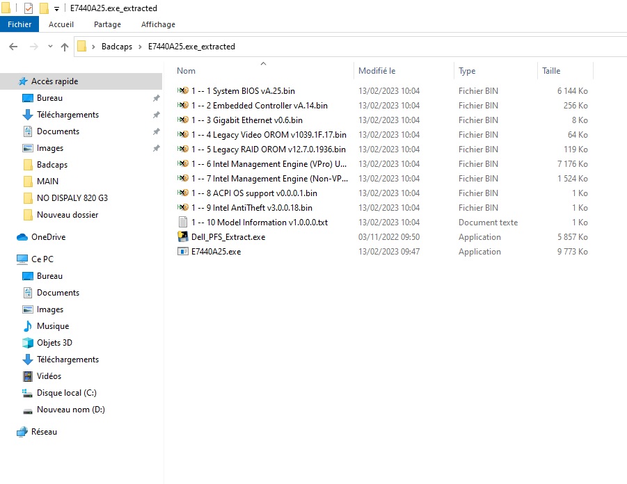

    For example one of these 2 files
    • lapfix
      • Mar 2020
      • 2765
      • my workshop
      Re: Help with Dell PFS extractor
      The 2 files are ok and extracted , you have a pb at your laptop

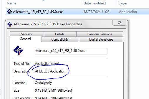

                            Is it possible to extract BIOS (or BIOS modules) with Dell PFS extractor for Dell Alienware X17 R2?
                            It splashes me
                            Error: This is not a Dell PFS BIOS image!
                              • 22241
                              #34
                              It splashes me
                              It won`t extract using Dell PFS extractor until the first exe is extracted, its an AFUDELL app.
                              See: https://www.badcaps.net/forum/troubl...table?t=115830

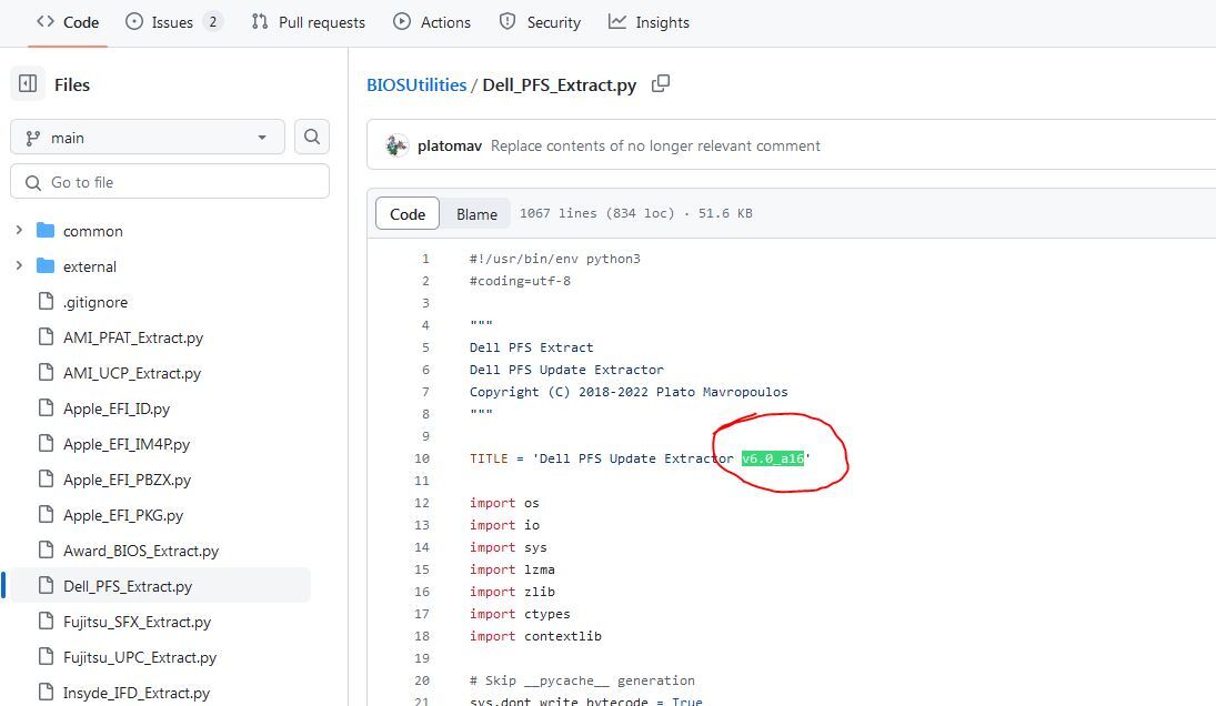

                              Dell PFS 6.0 exe format anyone can share please
                                • 22241
                                #36
                                I`ve seen it on a few paid sites and some &8*%$ÂŁ on a famous video sharing site is selling it as well.Any software posted here must include the source code,as per the rules -> https://www.badcaps.net/forum/troubl...before-posting
                                The python script is version 6.0 ,and its free

                                • augustocs
                                  • Jul 2019
                                  • 8
                                  • sĂŁo paulo
                                  #37
                                  Click image for larger version  Name:	PFS Extractor version.jpg Views:	93 Size:	63.9 KB ID:	3244243
                                  I converted the code as it is available.
                                  But it opens and closes, it doesn't work.
                                  Do I need to edit something for it to work? Could you share a link to the exe file?
                                  Thanks​
