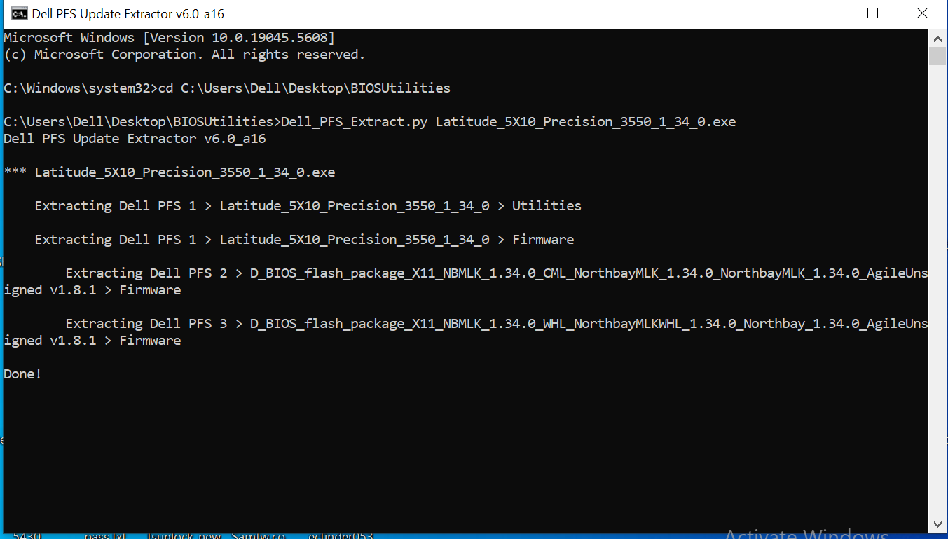

                  • volinakis
                    • Jan 2021
                    • 2874

                    Originally posted by SAHILSHAIK
                    can anyone extract this file for me
                    do it yourself using dell pfs extractor, rename "Latitude_5X10_Precision_3550_1.34.0.exe" into "Latitude_5X10_Precision_3550_1_34_0.exe". There are tutorials in this forum how to do it.

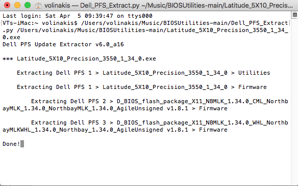

                            • volinakis
                              • Jan 2021
                              • 2874
                              • N/A
                              no sir dell pfs v6.0 not working on my comuter i don't know why, plz anyone can extract tk
                              it's working well, just have to follow instructions of author platomav
                              Click image for larger version  Name:	Screen Shot 2025-04-05 at 14.48.41.png Views:	0 Size:	48.4 KB ID:	3608303
                              same in windows

                                  • volinakis
                                    • Jan 2021
                                    • 2874
                                    • N/A
                                    why don't u post that extracted files? it violates rules?
                                    because you want to be given to you instead of learning to do it yourself.
