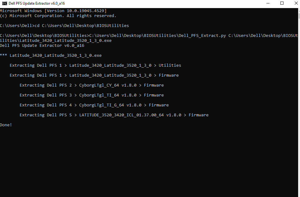

    • N/A
    GUIDE TO USE DELL PFS EXTRACTOR or other extractors from BiosUtilities (my way)

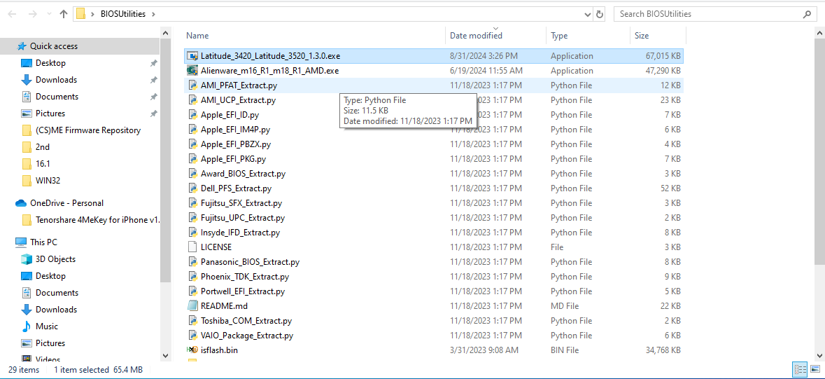

    1. Download BIOSUtilities (thanks to platomav) and move folder "BiosUtilities" to Desktop
    https://github.com/platomav/BIOSUtilities
    2. Install python 3.11.0 or higher (both versions for 32bit and 64bit)

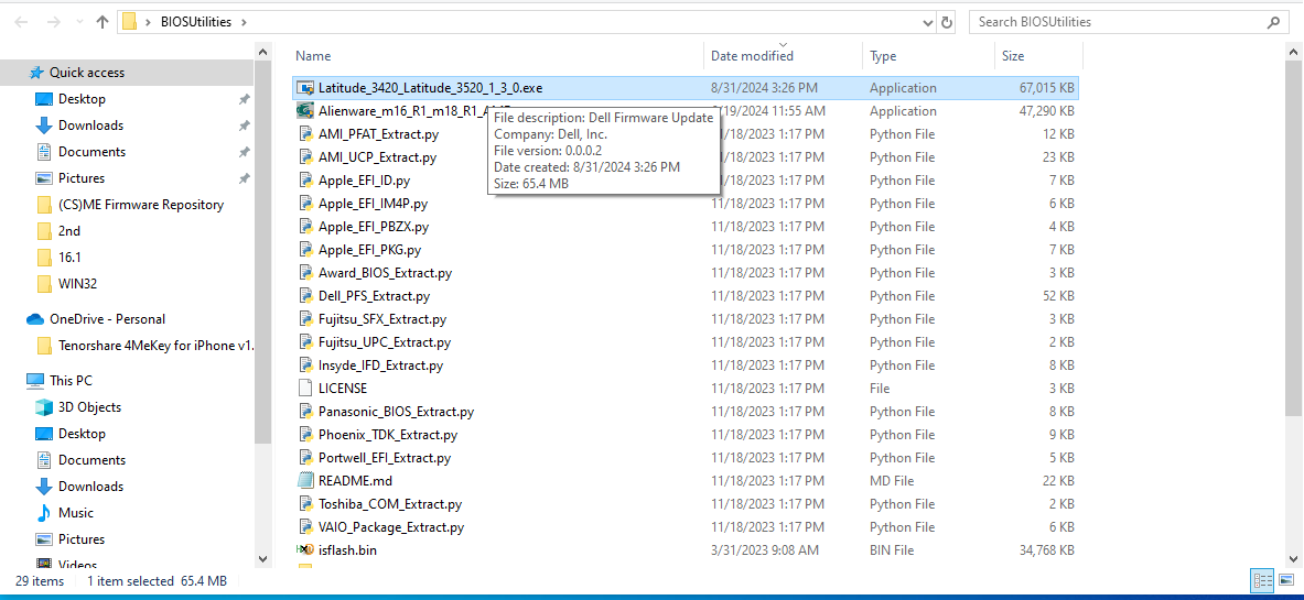

    3. Download Dell bios update from Dell site (in my example bios update for Dell Latitude 3420) and move it to "BiosUtilities" from Desktop.
    4. RENAME update exe WHITOUT SPACES AND DOTS! In my example "Latitude_3420_Latitude_3520_1.37.0.exe" to "Latitude_3420_Latitude_3520_1_37_0.exe"
    5. Open cmd as admin and go to folder "BiosUtilities" from Desktop. For win10 win11 drag&drop "Dell_PFS_Extract.py" [space] "Latitude_3420_Latitude_3520_1_37_0.exe" and hit Enter. (for win7 use copy/paste)
    6. For ALIENWARE use "Insyde_IFD_Extract.py", is not AMI bios but Insyde!

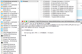

              This is a BIOS exe file belonging to a Dell E7440. I couldn't open it with InnoExtractor, UniExtractor, 7Zip, WinRar, ResurceHacker, or any other program or Python file. When I double-click it, nothing comes up. If it does, I can extract the dump file from the Temp folder. How can I open it? Can you help me?

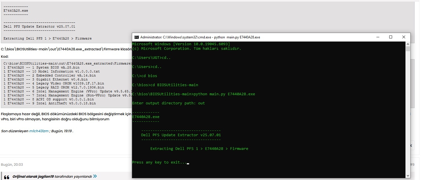

                It's an issue with the dependencies of the biosutilities package
                What worked for me was:
                1.
                Code:
                python -m pip install pefile==2023.2.7 dissect.util==3.20
                2. Download the required utilities separately (7z, UEFIFind, UEFIExtract, TianoCompress, big_script_tool.py and place them in "external" folder, inside the biosutilites folder
                Like this for example:
                C:\bios\BIOSUtilities-main\biosutilities\external\
                Code:
                C:\bios\BIOSUtilities-main\biosutilities\external>dir /b
                7-zip.dll
                7-zip32.dll
                7z.dll
                7z.exe
                7z.sfx
                7zCon.sfx
                7zFM.exe
                7zG.exe
                big_script_tool.py
                TianoCompress.exe
                UEFIExtract.exe
                UEFIFind.exe
                3. This step is important, it didn't work for me until i did this, you have to scroll down the instructions until you get to the packages section for this command, run it from the BIOSUtilities-main directory:
                Code:
                python -m pip install --upgrade biosutilities[pefile,lznt1]
                Code:
                C:\bios\BIOSUtilities-main>python -m pip install --upgrade biosutilities[pefile,lznt1]
                4. Create the output folder, i used "out", inside the BIOSUtilities-main folder
                C:\bios\BIOSUtilities-main\out\
                5. Copy your bios update E7440A28.exe to the BIOSUtilities-main folder and run the following command (in command prompt), it will ask you for the output directory, type "out", assuming you named that way your output folder
                Code:
                C:\bios\BIOSUtilities-main>python main.py E7440A28.exe
                Enter output directory path: out
                E7440A28.exe
                Dell PFS Update Extractor v25.07.01
                Extracting Dell PFS 1 > E7440A28 > Firmware
                It will extract inside the C:\bios\BIOSUtilities-main\out\E7440A28.exe_extracted\Firmware folder
                Code:
                C:\bios\BIOSUtilities-main\out\E7440A28.exe_extracted\Firmware>dir /b
                1 E7440A28 -- 1 System BIOS vA.28.bin
                1 E7440A28 -- 10 Model Information v1.0.0.0.txt
                1 E7440A28 -- 2 Embedded Controller vA.14.bin
                1 E7440A28 -- 3 Gigabit Ethernet v0.6.bin
                1 E7440A28 -- 4 Legacy Video OROM v1039.1F.17.bin
                1 E7440A28 -- 5 Legacy RAID OROM v12.7.0.1936.bin
                1 E7440A28 -- 6 Intel Management Engine (VPro) Update v9.5.65.3000.bin
                1 E7440A28 -- 7 Intel Management Engine (Non-VPro) Update v9.5.60.1952.bin
                1 E7440A28 -- 8 ACPI OS support v0.0.0.1.bin
                1 E7440A28 -- 9 Intel AntiTheft v3.0.0.18.bin​
                It's not ready for flashing, you may have to use UEFITool 0.28 to replace the BIOS region on your BIOS dump (keep a copy of the original dump), for the ME region i don't know, you may ask the experts here, there's 2 ME versions, one vPro, one non-vPro, i don't know which one is right

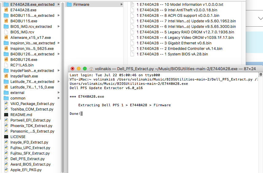

                  try Dell_pfs_extract ...

                    Thank you very much king, I did what you said one by one and as a result I was successful and I am happy. Thank you for your hard work.

                      The device I use is an imac, actually I will try this on the Mac side at the first opportunity. I struggled because the Dell FPS extractor was not working on the Windows side. It didn't work when I did it in Windows like you did. Thank you friend, I solved it, but I will try it on the Mac side at the first opportunity. Thank you very much for your interest. Good luck with your work.
