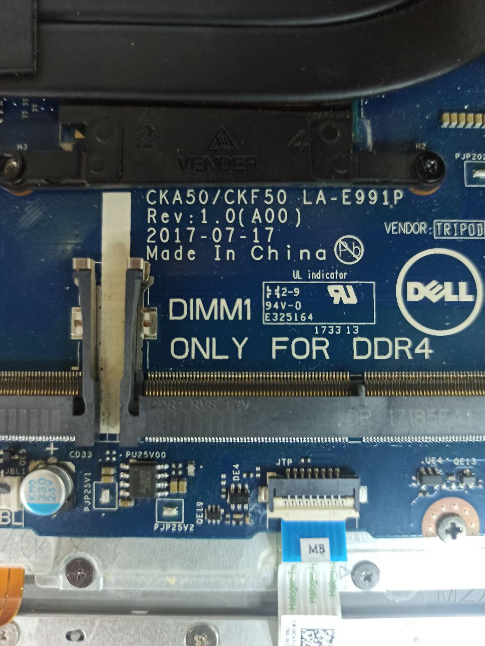

                  Dell Vostro 7570 charging problem
                  Hello
                  my 7570 is not charging
                  Battery detect ok
                  Charger detect ok
                  Test with other new battery same, other charger same ( 90w , 130w , 180w )
                  The batterie stay at the same volt with the charger but don't charge more , same with other battery
                  motherboard : CKA50 LA-E991P
                  Bat dat et clock 3v
                  and bat pres 3v with no battery, 0v with battery
                  Maybe bios problem ?
                  Thx

                            Hello, reflash bios, same problem, batterye detect, charger detect but not charging. Change the bp ship same
