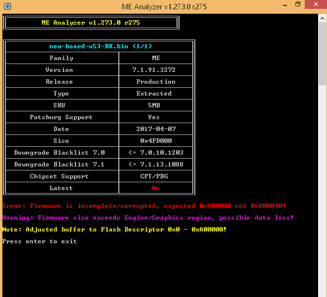

            i runned me analyzer and found this
            Error: Detected incomplete firmware size 0x800000, expected 0xA00000!
            Warning: Firmware size exceeds Engine region, possible data loss!
            will report back when i dissasemble laptop. i dont have it with me now its at a cousins house. as i had a cousin sent it to a repair shop but they could not fix it. so have to see when cousin is free to come maybe on the weekend.

              When the bios is split across 2 chips both of them should be joined together first before cleaning the ME region with flash image tool.
                ok so thats why it gives that error both files should be joined before analyzing and cleaning.
                the guy hoaca388
                above already posted a fixed or clean files. have to flash and test. once i get laptop back.

                        UPDATE
                        its fixed now. thank you all for your help
                        thanks hoaca388
                        since its was my first time flashing bios manually with programmer
                        i made a mistake. i didnt understand when compare files.
                        the program has built in verify file and it said it was the same. but it wasnt
                        all files were not a match
                        A78F433F9CD540B44C0E4464DBFBF747 u52-written.bin (file back up after erase/write and verify.)
                        C1B8EDEC03E771EA9541E5B29486E268 u52ok.BIN (file used to write chip)
                        130E8A3F0A44F69410A18883FF4512FC u53-written.bin (file back up after erase/write and verify.)
                        395FA0DA4DC293882FCF5DBF24E6FECD u53ok.BIN (file used to write chip)
                        so now with hoaca388 uploaded files i flashed both chips made a back up after flash. then with md6 sum check i created md5 and both files matched
                        8FDB2B2E133230A1F349E1BF2187DE5C oldboardbk-u53-New8mb.bin
                        8FDB2B2E133230A1F349E1BF2187DE5C new-FIX-BK-U53.bin
                        C1B8EDEC03E771EA9541E5B29486E268 new-FIX-BK-U52.bin
                        C1B8EDEC03E771EA9541E5B29486E268 oldboardbk-u52-New-2mb.bin
                        now with this bios i can see intel ME bios section
                        that is this for.?? it ask for password.. or should i just leave it alone.?

                                      Hello,I was installing window 10 on my dell precision m4600 service tag : 4zqs4s1 , and after installation complete and restart it's freez in dell logo , I searched and realized It need bios flash so I found this https://www.alisaler.com/dell-precis...reva00-bios-ec
                                      As I live in a small city and I don't have programmer sed it to a repairman to flash this but after flashing and boot up , touch pad didn't work , the USB or pexe boot don't boot and only DVD drive can boot , also the biggest problem is in f12 menu there is no Intel me mebx and the worst thing is after installation windows every time I shout down or sleep or hibernate it's freez in windows logo and I should go to safe mode and everything turn ok until I shout down or sleep and it's a cycle.
                                      After all that I found this : https://www.badcaps.net/forum/troubl...-flash-unbrick
                                      It's seem that guy flashed my bios don't know what is clear me region, like my self and that happened To my laptop
                                      Now my question is my laptop CPU is : I7 2820qp and I don't have the default dumped file , it will be ok if I use the last bios file with clear me that guy uploaded in to that
                                      ​​​​Topic or I should test different me version?
