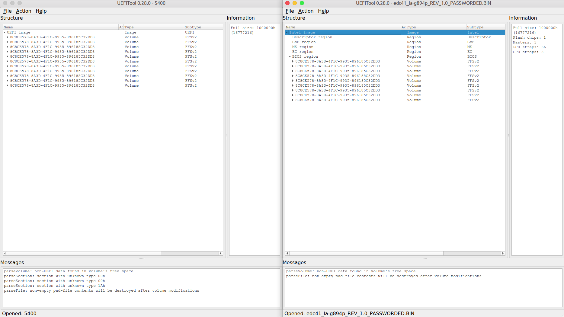

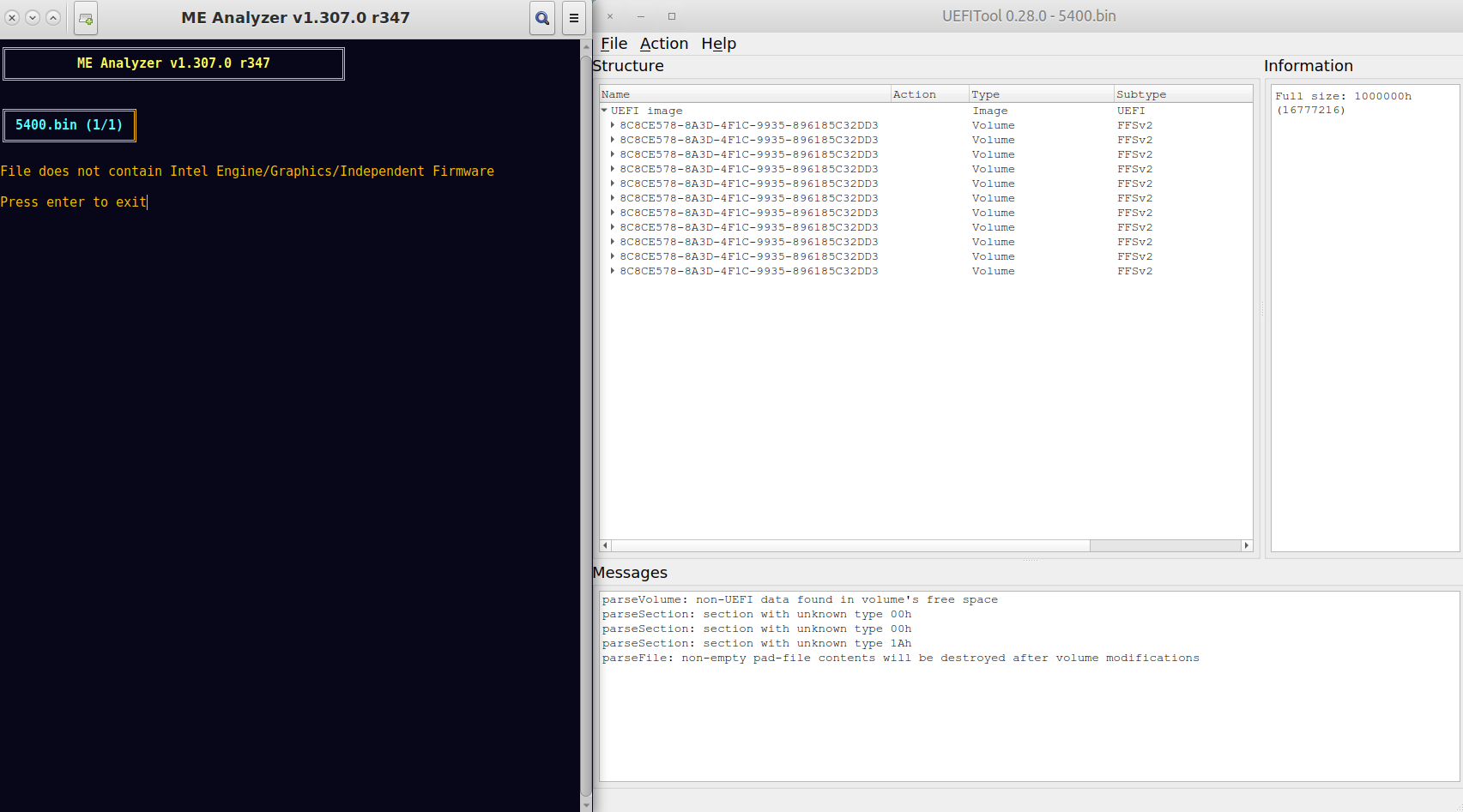

                              You're right, I have a defective motherboard from a Dell 5400 notebook LA-894P there is only a 16MB BIOS chip UC5.
                              You don't have an 8MB BIOS chip, but your original BIOS file is damaged and the entire ME EC region is missing.​

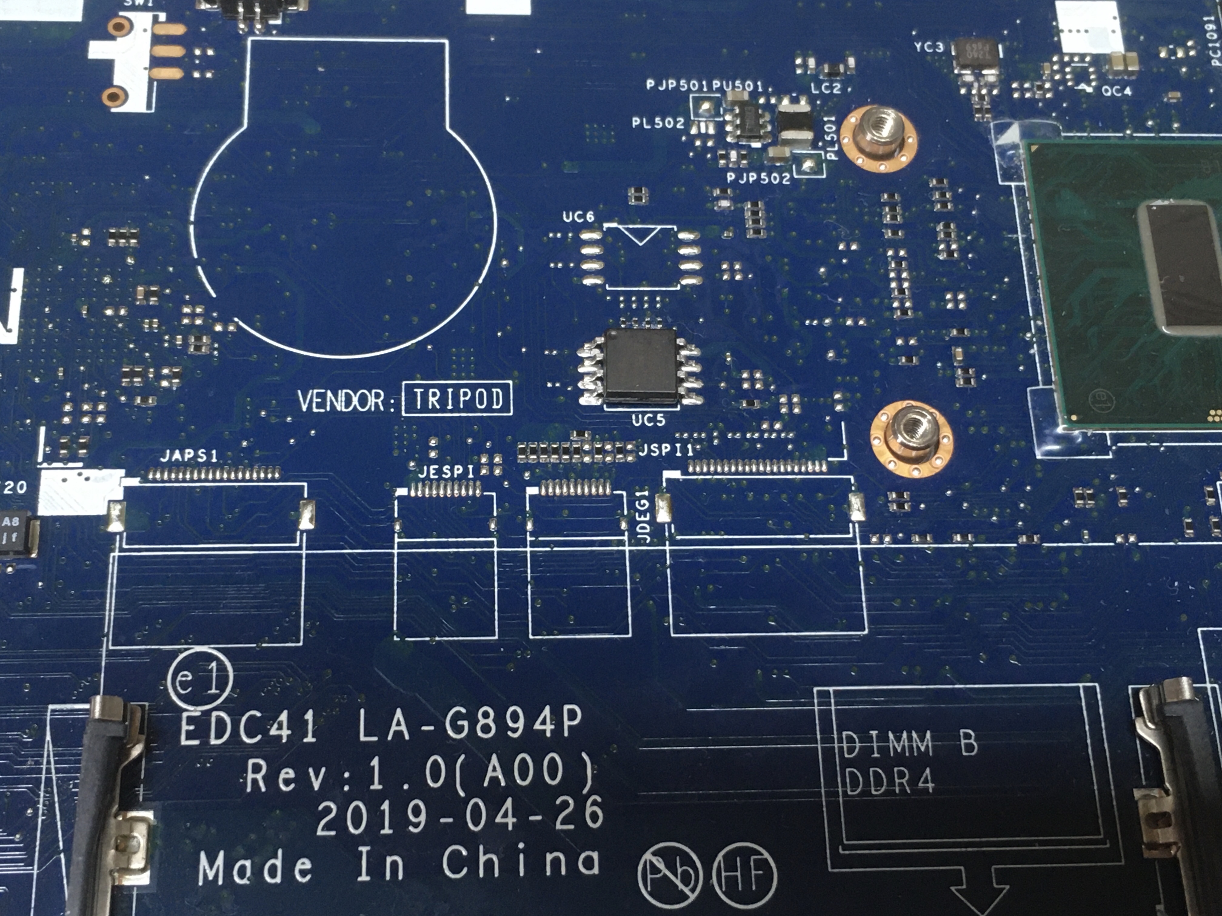

                                I am completely new to bios flashing and I am kinda lost...
                                My situation is similar to the one above.. I do not have a chip in UC5 only one in UC6... I could desolder it to dump the data but the data file that I obtain is a 32 MB file... And I saw it should only be 8MB... What that means? Did I get the wrong chip ? Which software can I use in linux to be able to patch my BIOS file?
                                Thanks,
                                Jorge
                                  Thanks,
                                  Jorge
                                  Post the U6 dump,and the laptop service tag
                                    Hello SMDFlea,
                                    Thanks for the help! I have just attached to this message my BIOS dump. I greatly appreciate the help. I would also like to learn what was done to patch... Could you also pinpoint a place where I can learn how to perform the Hex Editing and some information about the different BIOS regions and why people have different sizes in the same laptop model ? Thanks!!
                                    Service Tag is: 6YRRF13
                                    Regards,
                                    Jorge
                                      Hello SMDFlea,
                                      Regards,
                                      Jorge
                                      some laptops have 2 bios chipsets, main and EC. for bios regions use UEFITool. HxD has user guide, read it.
                                      Also read BIOS guides, methods, resources and tools of this forum:
                                      ​https://www.badcaps.net/forum/troubl...t=phoenix+bios
                                      here is your modified bios, at 1st boot (let it run for 2 mins, it will restart several times with no image) press F1, write service tag, save (apply changes) then exit. 2nd boot press Alt+F to exit manufacturing mode.
