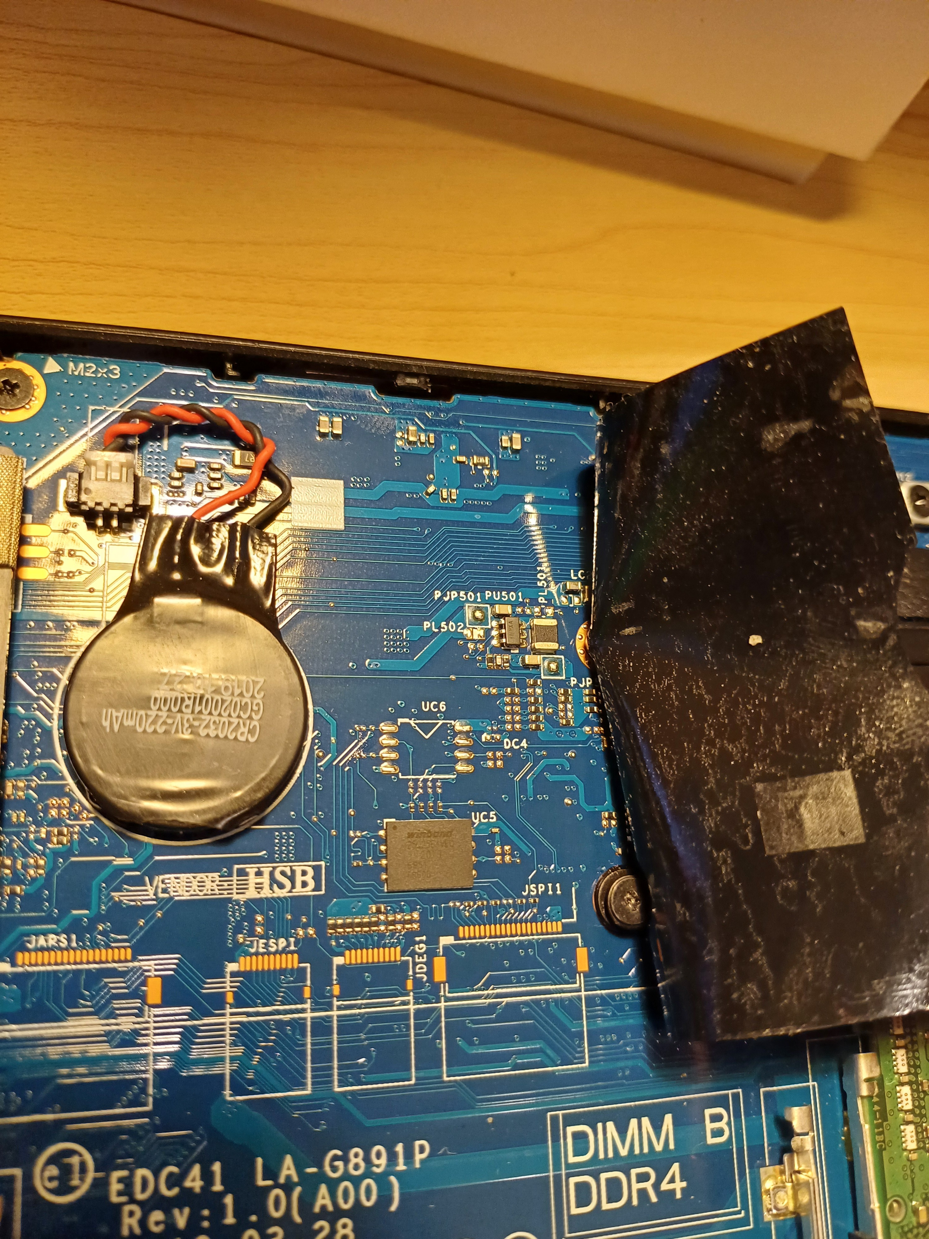

Originally posted by
U_pasta
View Post
According to the description in your notebook's documentation, the service tag is a no-vpro.
According to your motherboard diagram, the no-vpro processor uses two bios:
uc5 8mb
uc6 16mb
You need to join the two files to assemble the biosrom.bin.
No, it is just one chip.
olexky
View Post
This quote is not for your case, it is for a Latitude 5400 non-vpro.
In your case #199, the bios is vpro 32mb, already sent.
Did you test it? Can you give me feedback on the test?
