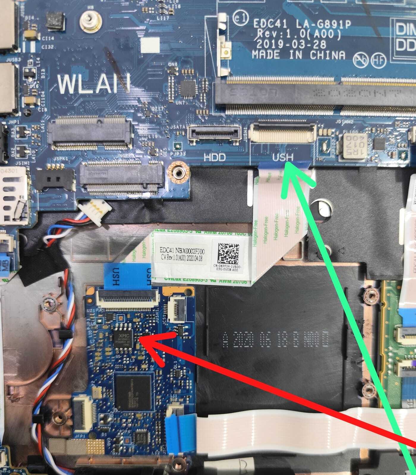

                  Could you help me repair this BIOS? I saved both bios, but from the description and size it is not vpro.
                  uc5 8mb - backup-8mb-lat5400-2rscy63.bin
                  uc6 16mb - backup-16mb-lat5400-2rscy63.bin

                      Originally posted by hoaca388 View Post
                      Latitude 5400
                      Service Tag: 2RSCY63
                      Thanks for sending it, I recorded the two files, but there was no video.
                      The keyboard blinked a bit and it wouldn't turn on.
                      Is there another repair file?
                        try and feedback
                          Originally posted by LBTT1121 View Post
                          try and feedback
                          Thanks for the file, still no success.
                          the board doesn't turn on.
                          it has 3.3v, 5v, 7.8v coils, but it doesn't turn on and no LEDs light up.
                            LBTT1121 hoaca388
                            I noticed that this notebook has an SPI (XMC 25HQ128 16mb) on an auxiliary board and the voltages +3.3V_ALW, +5V_ALW when the board has the flat cable connected to the USH.
                            Does this SPI need to be recorded?
