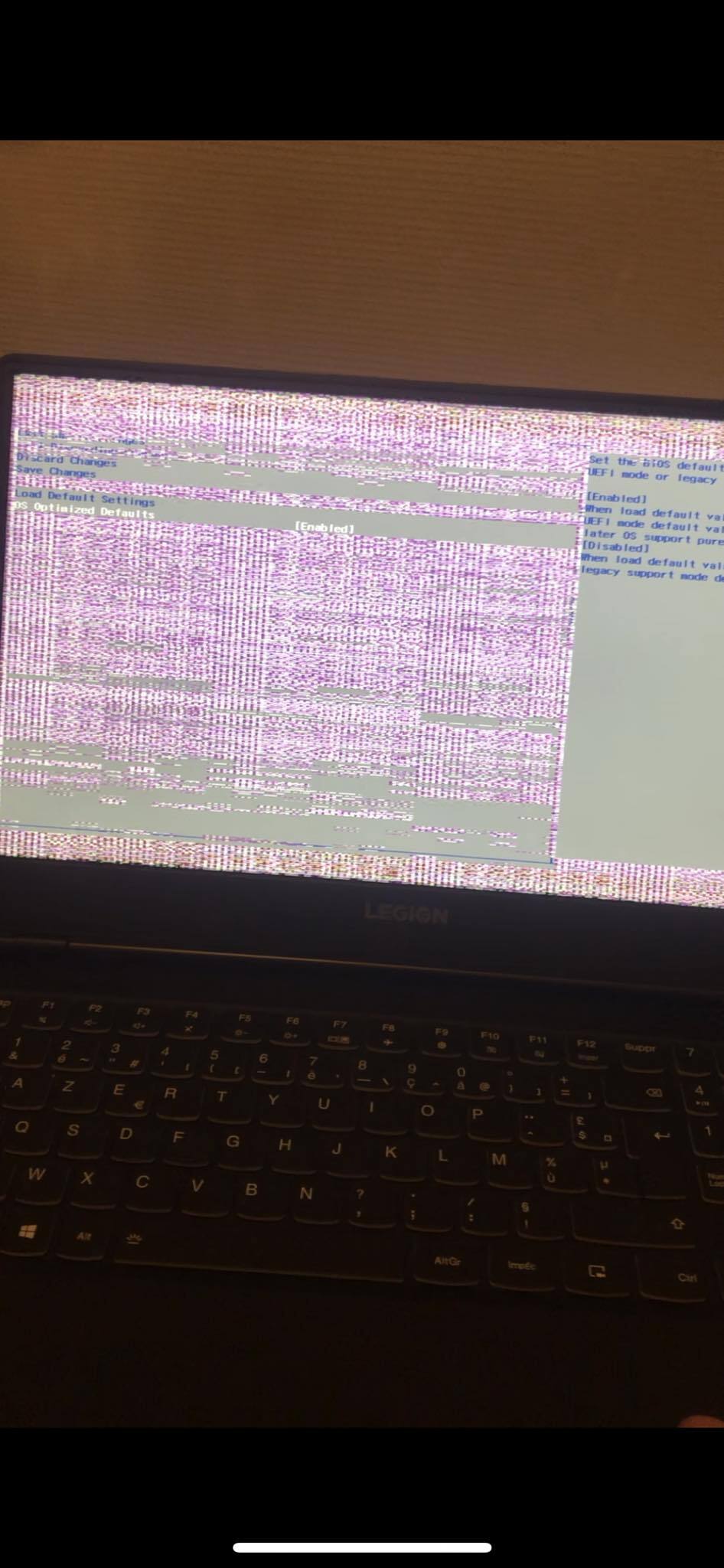

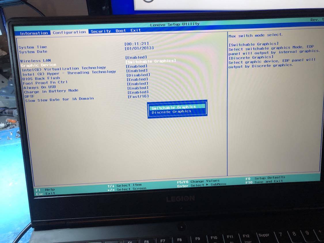

            #45
            If it helps anyone, I tried to heat the graphics card to do a reflow with a reballing machine, but that didn't change anything, I changed the bios to the latest version, still the same , display traits, I see very little what is marked on the screen, but I tried to change the bios settings, and I found Graphic Device in the bios settings, so I changed Discrete Graphics by Switchables Graphics, I now have a very clean display.
            Click image for larger version  Name:	407379488_681306707470892_5102048882236623459_n.jpg Views:	0 Size:	84.5 KB ID:	3165678
