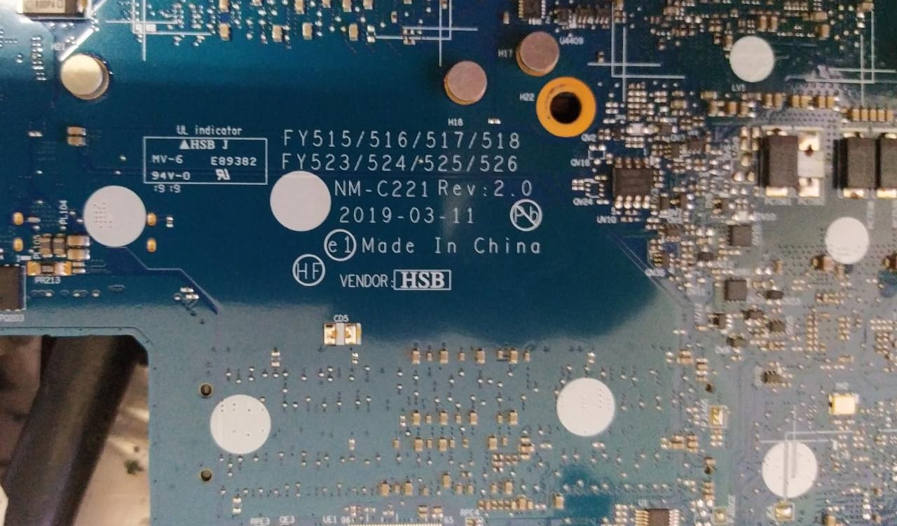

    hello
    got a Lenovo y540 15irh with blinking power button led,
    could someone fix and update this bios dump?
    thank you!!
    Moherboad
    NM-C221 Rev 2.0

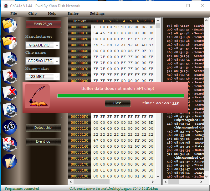

                            Thank you for replay but i got the following message
                            Buffer Data not match SPI chip!
                            • hoaca388
                              Badcaps
                              • Jan 2022
                              • 12142
                              Re: bios for lenovo y540-15irh (81sx)
                              CH341A
                              Supports I2C (24-series), SPI (25-series).
                              This programmer is not recommended but it is the cheapest programmer available.
                              It has several shortcomings:
                              Limited interfaces support, only SPI and I2C
                              Several different software with varying level of reliability and ROM IC support (especially troublesome with 128Mb and larger ICs)
                              Several different hardware design, some of them having design defects
                              No proper detection of communication issue with the ROM IC
                              Available software include: NeoProgrammer, Colibri, AsProgrammer, Flashrom…
                              Read the guide there: https://winraid.level1techs.com/t/gu...rammer/32948/3
                              If you have a black PCB, it is very likely that it needs to be modified for 3V operation instead of 5V. Failing to do so could damage the ROM IC.
                              Watch the instructions there:
                              https://www.youtube.com/watch?v=-ln3VIZKKaE
                              https://www.youtube.com/watch?v=HwnzzF645hA
                              ​https://www.badcaps.net/donate
                              • huss584
                                Hussein
                                • Apr 2020
                                • 229
                                • Palestine
                                Hello
                                Thank Soo Much i try another way in same Programmer it work fine

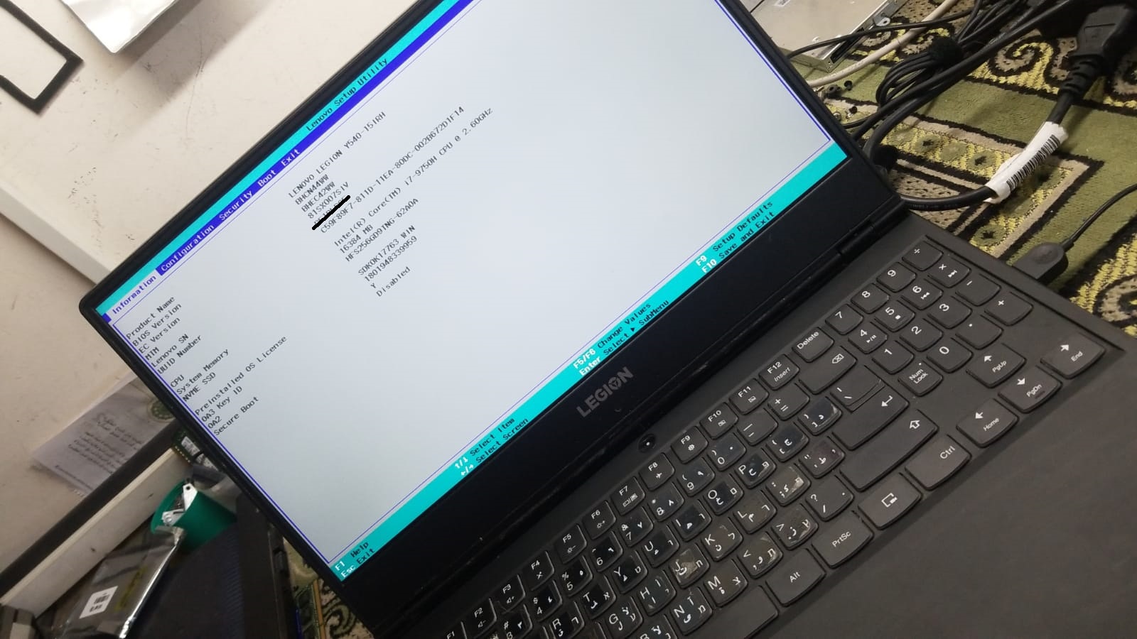

                                  HELLO EVERYONE
                                  I have some issues with this machine:
                                  lenovo Y540-15irh 81sx
                                  s/n PF1468B6
                                  This laptop is not turning on after restart. Only keyboard backlight and black screen. It takes a few minutes to be able to turn on again.
                                  Video card is performing good. Good temperature and performace.
                                  I attached bios dump.
                                  • brontobyte
                                    • Jul 2021
                                    • 85
                                    • Romania
                                    i already solved. Thanks
