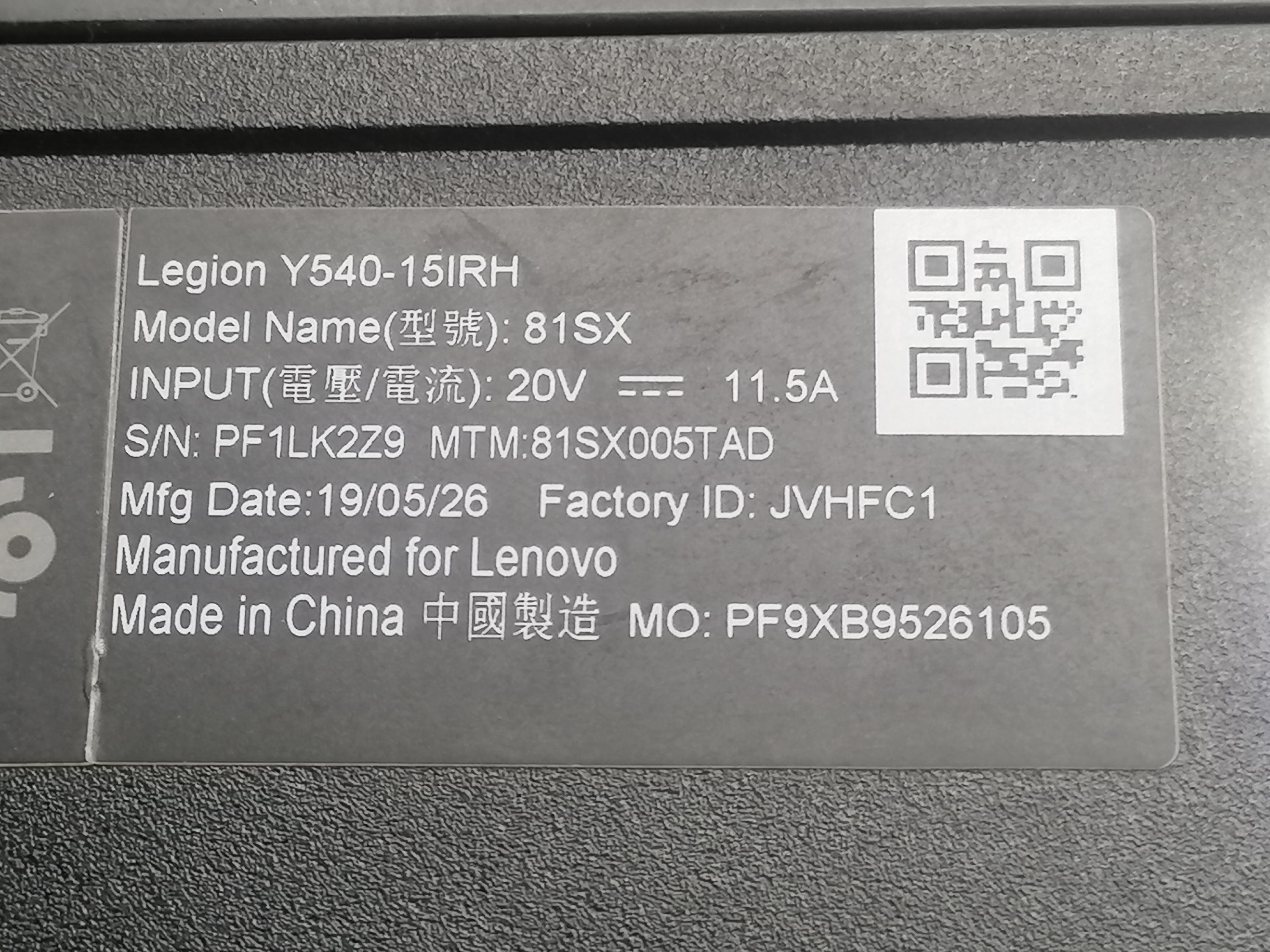

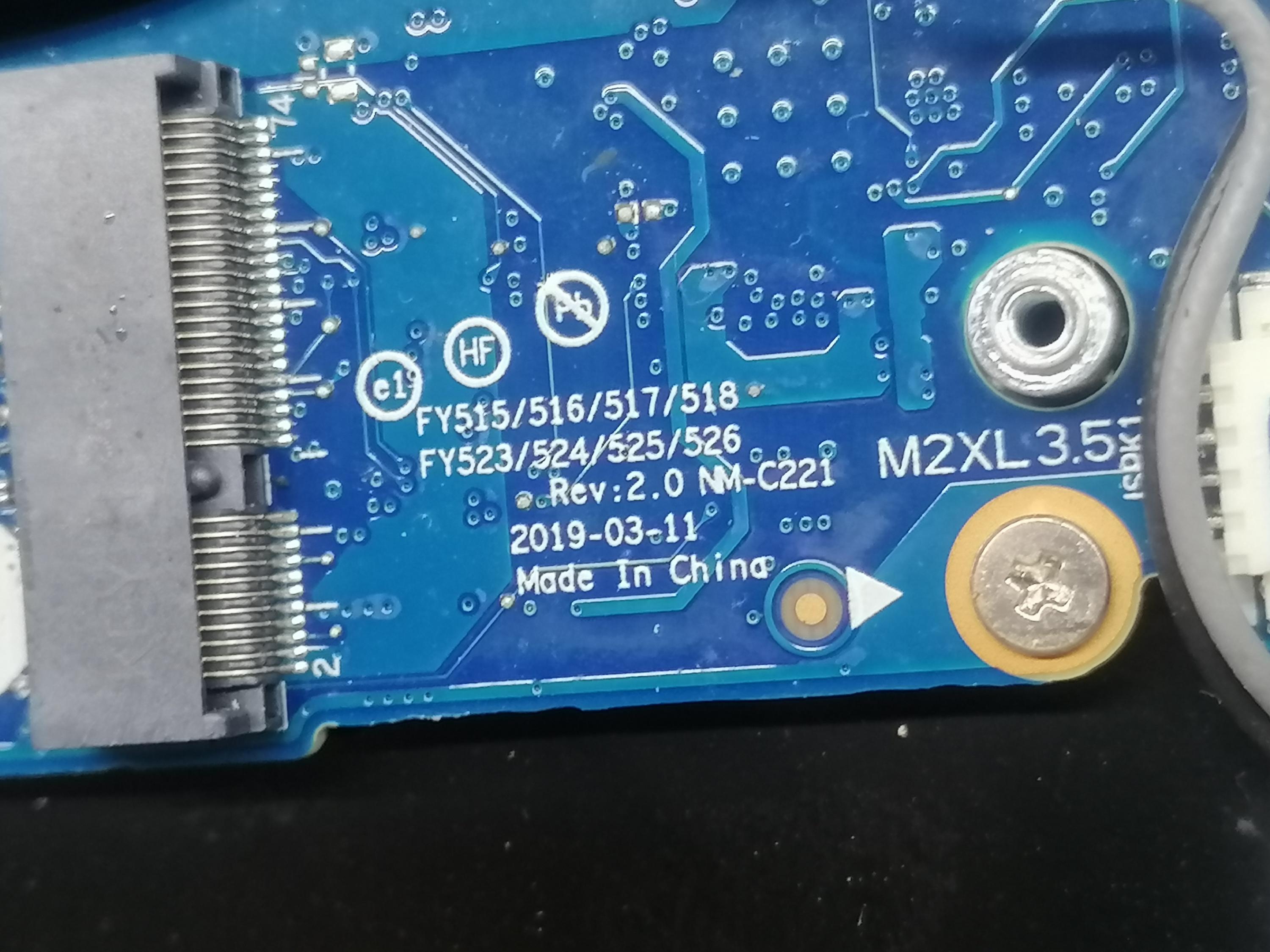

Need help unbricking Lenovo Legion Y540-15IRH
Hello everyone! I'm in big trouble!
Three days ago I had to force shut down the laptop by pressing the power button and after that the laptop would not start. Keyboards lights and backlight on, fans on for a while but laptop won't boot at all.
I have therefore tried to use CH314a programmer in order to write the bios onto the bios chip. First time I tried using a bhcn26ww already trimmed file I found on the internet but no response. 2nd try I have tried to trim the latest file myself, bhcn45ww and after I have successfully written the file on the chip, the laptop won't even turn on the keyboard lights or backlight anymore! Next, I have tried to reuse the bhcn26ww file from earlier to see if anything changes and I have returned to the main problem: laptop would not boot but at least the keyboards lights and fans are working again. After that, I have tried writing the bhcn38ww and bhcn44ww bin files that i have found on this forum onto the chip but it seems that nothing works.
Would you be able to give me the right bin trimmed file please or guide me through what I would have to do further? I'm in a bad spot and I really need this laptop to not die on me.
Bios chip: GD25B127DSIG
Also this is the bios file that i read before i have made any modifications on to the chip:Attached Filesif you find these attachements useful please consider making a small donation to the site
Re: Need help unbricking Lenovo Legion Y540-15IRH
Post the laptop's serial number, your error may be due to the hardware.Hello everyone! I'm in big trouble!
Also this is the bios file that i read before i have made any modifications on to the chip:↵
https://www.badcaps.net/donateComment
Legion Y540-15IRH Laptop (Lenovo) - Type 81SX FROM LENOVO HOME PAGEAttached Filesif you find these attachements useful please consider making a small donation to the site
