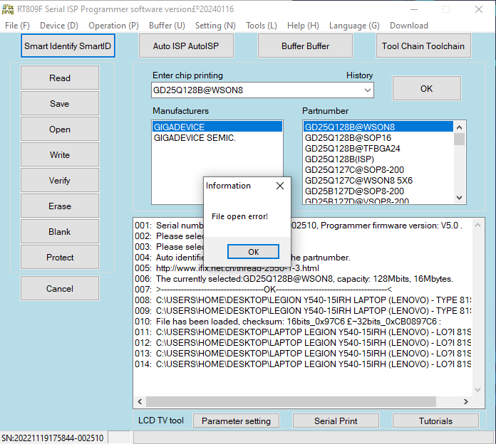

    Originally posted by CirebeaTiberiu
    File open error
    File bios is ok.
    • CirebeaTiberiu
      • Aug 2021
      • 22
      • Romania
      #62
      File open error
      I can't open this file in RT809F
