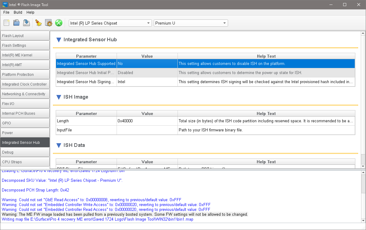

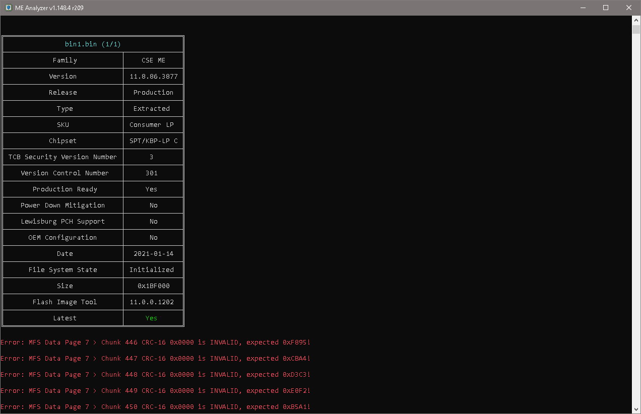

                    I have a Surface Pro 4 i5 8/256 X911788-009 and it was in "Logo freeze" state from the begining.
                    I've read carefully all the info from first post of this thread:
                    https://www.badcaps.net/forum/showth...=104153&page=1
                    1. I've succeded to read dump from chip, tried several times, just in case.
                    2. Tried to open this dump in MeAnalyzer with "-dfpt" option, it shows that dump doesnt have ISHC and also shows the dump is corrupted. (pic1 and pic2)
                    3. FIT - opened this bios dump and it doesnt have any "Integrated Sensor Hub Supported". (pic3) I've tried to clean ME and build new bin using this original bios, but it still freezes at logo.
                    Then i downloaded new bios with clean ME (pic4 - "File System State - Configured") from this post:
                    https://www.badcaps.net/forum/showpo...36&postcount=2
                    and flashed it.
                    Now i have touch firmware in bios, Touch and ME in device manager are fine, without any issues. But the touch screen still doesnt work.
                    I've tried to reinstall windows, also tried to recover from USB recovery by this article:
                    https://support.microsoft.com/en-us/...f-398fc7d62c07
                    I don't know what to do next, may be i failed some sequence?
