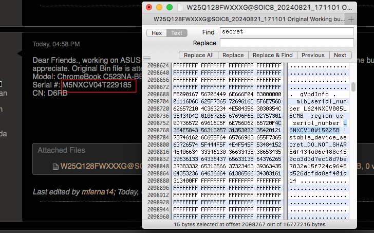

                      Dear Friends., working on ASUS ChromeBook C523NA-BB01T-CB. BIN files works & Display is fine but it's Locked, can someone re-build this BIOS, I would appreciate. Original Bin file is atteched.
                      Model: ChromeBook C523NA-BB01T-CB BABYMEGA D7B-B2G-B4Y-Z9E-A9X
                      Serial #: M5NXCV04T229185
                      CN: D6RB
                      • volinakis
                        • Jan 2021
                        • 2653
                        • N/A
                        CN: D6RB

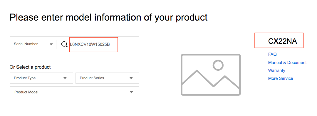

                        serial provided doesn't fit with serial from bios backup which seems to be from a CX22NA and not C523NA

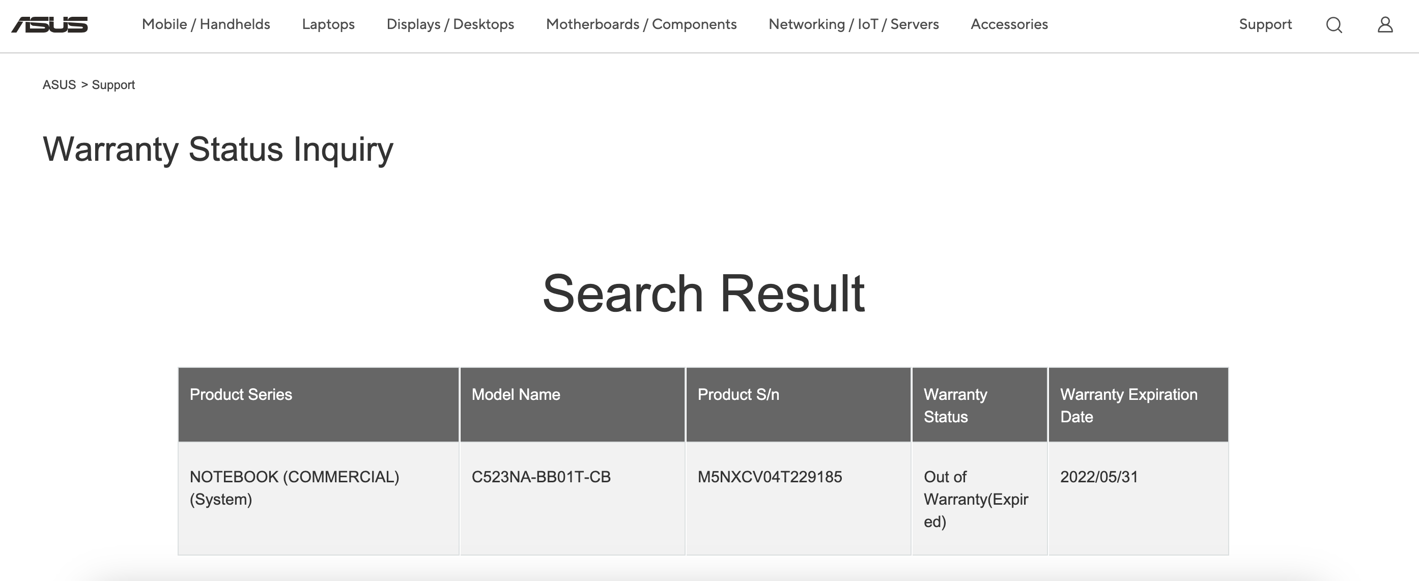

                          Dear this is only serial, I re-checked several times which is on at the back sticker of the laptop & from the ASUS Web site, comes up with the same model. Attached is the photo. Can you modify the serial # or trim it to the size if possible & just to inform you I purchased this motherboard from eBay as the original motherboard got dead & now this new one is locked. You know how they sell. This motherboard has been changed, I would not bother about the serial # or model # as long as he modified BIOS is working & Not locked to any Gmail Acc & maily it's out of ASUS warranty. Thanks dear for the help.

                            patched w RC unlocker
                            then filled !stable_device_secret area with FF
                            should allow to use new account now.
