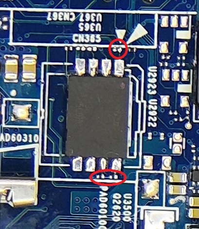

                • hoaca388
                  Badcaps
                  • Jan 2022
                  • 12425
                  #1548
                  Originally posted by Jesse James
                  This is what I used from post 19

                        Hello, I need to remove the password on a Elitebook 840 G5.
                        RC unlocker did not work because it is a 32MB EEPROM...
                        Prod ID 2FA66AV
                        SN 5CG9236L4L
                        motherboard C0796B10WEA rev1.11 (Full Intel, no dedicaced GPU)
                        ThanX!​
                        • hoaca388
                          Badcaps
                          • Jan 2022
                          • 12425
                          #1552
                          Prod ID 2FA66AV
                          SN 5CG9236L4L
                          ThanX!​
                          HP EliteBook 840 G5
                          Serial_5CG9236L4L
                          Product_2FA66AV
                          Fearture byte_3X476J6S6b7B7H7M7Q7W7m7saBaEapaqauawbUbhcAdUdpdqhKhkjh.F5
                          Build Id_17WWCSCT601#SABF#DABF

                            #1553
                            Originally posted by hoaca388
                            HP EliteBook 840 G5
                            Serial_5CG9236L4L
                            Product_2FA66AV
                            yhank you for your help but I have a problem.
                            the keyboard is out of order (I did not know that "detail") so I did desold and resold twice but at the second time, I swipe one or two components (I'm sure for one, this circle alone, next the white arrow).
                            I think it was resistors.
                            Do you have the resistance of them?
                            EDIT> I found what I need on the forum :-)
