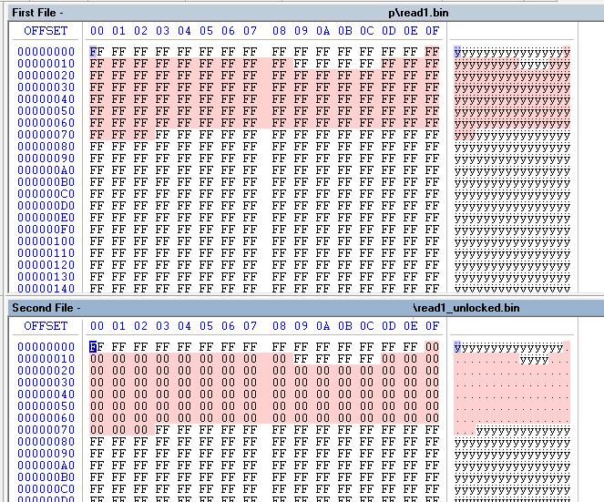

                Does this unlock look suspicious? This is on an EliteBook 745 G3. I tried booting with the unlocked rom but all I got was black screen with power & caps lock light on.
                I also tried the unlock on a rom from a water damaged 755 G5 and the unlock "looks" much more believable. Too bad I can't boot this one up.

                  Yes, your first read is bad. Did you verify what you read?
                  Oh and thatswhy RCUnlocker is the one to use. It will kinda let you know if you have a bad read.

                        I wrote my "read1.bin" back to the rom and it is booting. Is my read actually bad?
                          Re: HP BIOS unlock tool
                          Probably using Ch341A?
                          I guess it fails to read/write second half of the file properly so that would explain it.
                          Try reading and verifying, see if it passes.

                            Yes I am using CH431A
                            I have a new read which I also verified. Checksum is the same as my 2 original reads.

                              You just chose the wrong chip - U366, that's your problem. It is near the RTC battery. The password is in the other with board positional name U365, located next to the CPU fan. Upload a dump of it here and I'll remove the password. Read it twice and compare the contents beforehand.

                                Thank you RCUnlocker recognized it and unlocked it BUT I accidentally made a huge mess while soldering and now it wont boot into bios
                                My immediate repair didn't work so I'll have to get my multimeter out and figure out what's going on
