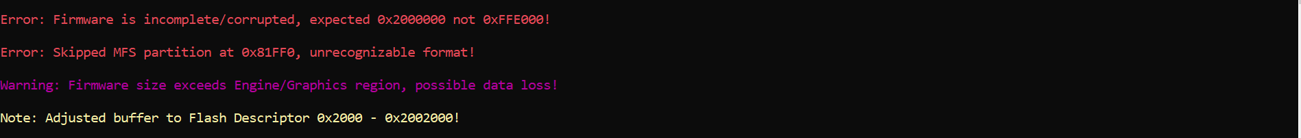

                              • skinner
                                • Jun 2013
                                • 60
                                #975
                                Re: HP BIOS unlock tool
                                I have 3 HP Elitebook 830 G7 with bios passwords and was looking for some help. Here is the 16mb dump of each. Thanks.
                                • Vesko356
                                  VIP Moderator
                                  • Aug 2018
                                  • 4386
                                  • Bulgaria 🇧🇬
                                  #976
                                  Upload main 32MB dump too.
                                  The same applies for Mrnixdorf.
                                  There is no way to do the unlock with just 16MB file.

                                  • RethoricalCheese
                                    • Mar 2013
                                    • 1519
                                    • Estonia
                                    #977
                                    Not correct It's just that it seems a little bit hit-n-miss for now. I've done a few here when I have been 100% certain it works on that machine.
                                    A small part of first padding on 16MB needs to be cleared.
                                    Just in case backup your 32MB and then try this.

                                      • Maxpower3
                                        Bad Veteran
                                        • Feb 2018
                                        • 1334
                                        • France
                                        #979
                                        Surprise, surprise , that's new approach, nothing to do with the old method
                                        Many thanks
                                        Ok seen
                                        but information seem encrypted?
                                        a xor or others swap bytes can be use for see may be ?
                                        what information is written in this part?
                                        Just 16mb is enough now or always do both for bypass?
                                        • RethoricalCheese
                                          • Mar 2013
                                          • 1519
                                          • Estonia
                                          #980
                                          Just continue doing it the old and tested way. My way is actually older but the problem is that I don't get any newer machines to test enough to get it working on all machines. Thatswhy I haven't published new version yet. It would just complicate things.
                                          On the ones I do get, I always only modify 16MB chip.
                                          HP doesn't use xor sadly. So decrypting wouldn't be viable.
