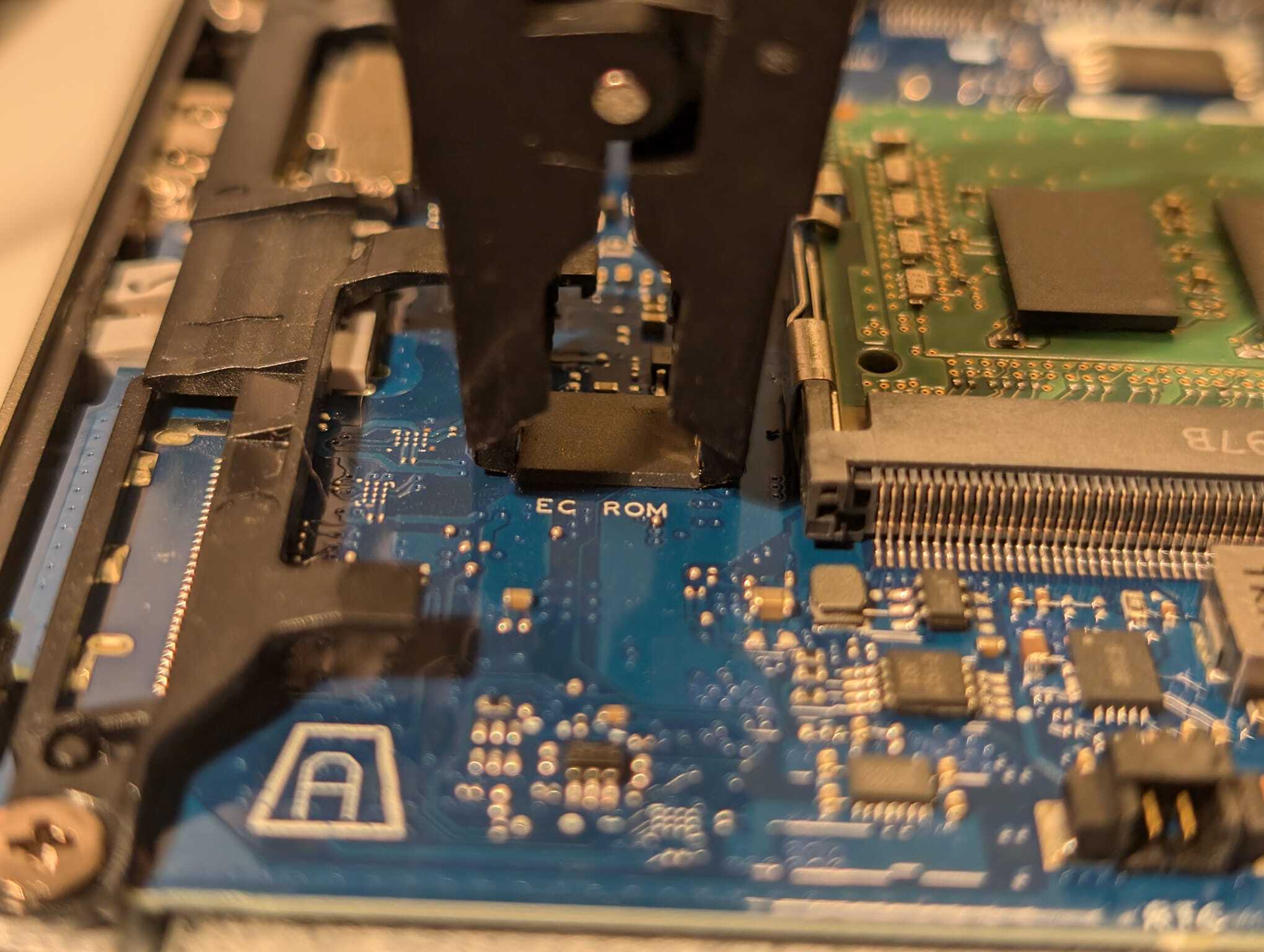

        Hello guys i tried to read my EC from my HP 455 G8 with the CH341A Programmer but on my pc and the ch341A programm i couldnt find the chip Winbond 25Q256JVEN ?
        • peste
          • Dec 2016
          • 13422
          • ROMANIA
          #44
          try..
          https://www.badcaps.net/forum/showpo...6&postcount=10
          https://www.badcaps.net/forum/showpo...04&postcount=7

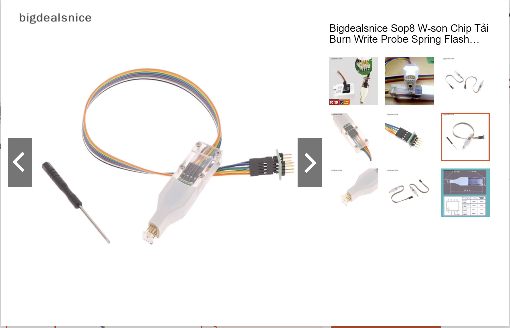

            Thank you, i found the chip with the AS Programmer. But it seems like i cant read the chip via the clipper or do i make something wrong?
            • hoaca388
              Badcaps
              • Jan 2022
              • 12268
              #46
              You used the wrong tool, with WSON chip you have to use this.
              https://shopee.vn/Bigdealsnice-Sop8-...2-4f563c2c4430
