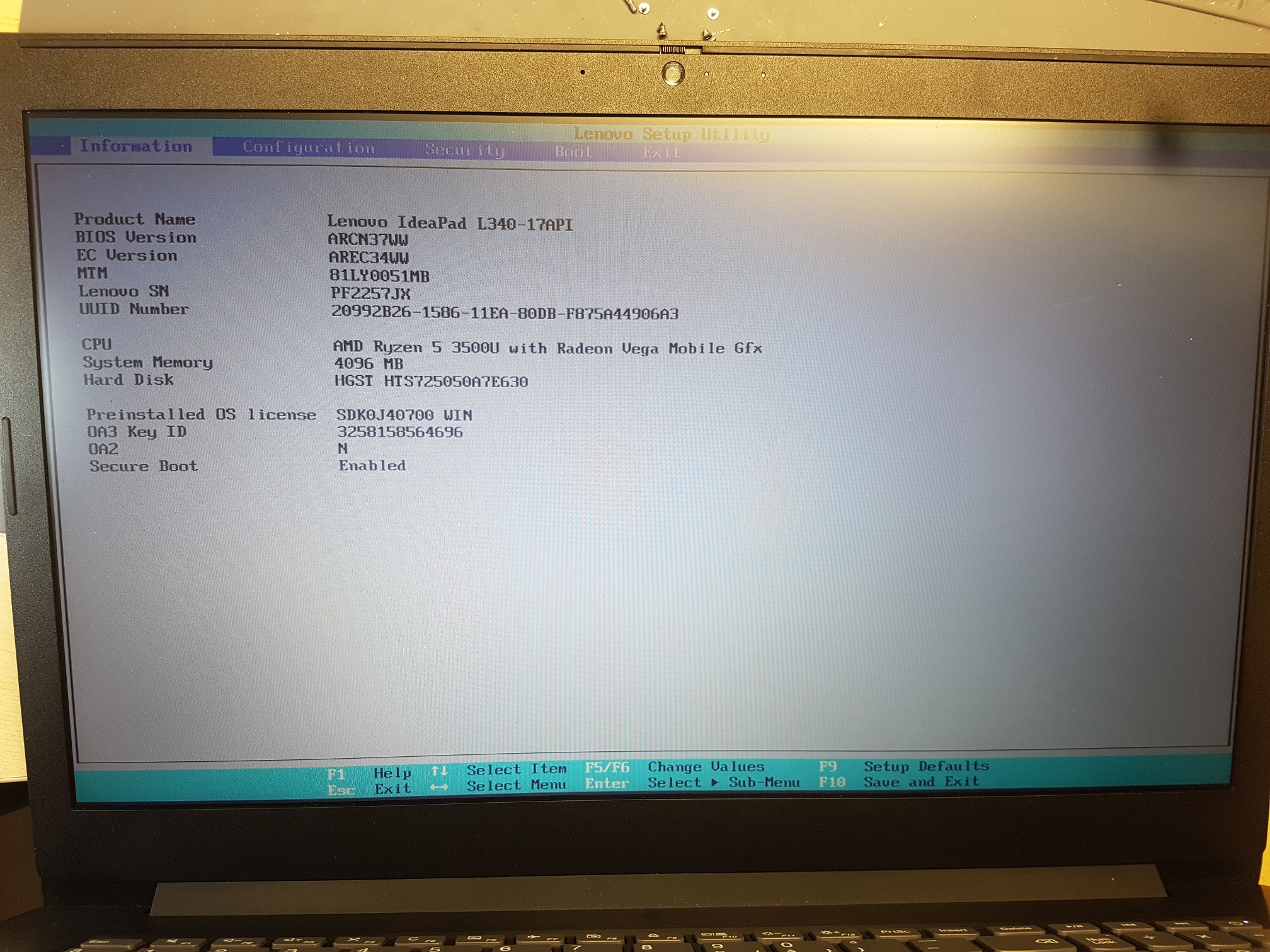

          Hello!
          I have a Lenovo L340-17API with corrupted bios.
          Ive programmed it with the dump of Vesko, it works but model and Model number are wrong.
          Can someone help me fixing the original dump?
          Much appreciated

            Here's your new file, hope it works fine.

              Re: Lenovo L340-15API BIOS Dump needed
              Thanks Hardware1!
              I will test and update tomorrow.
              Much appreciated.

                Re: Lenovo L340-17API 81LY
                Perfect!
                Thanks once again.
                  Does it flash as a bin or do have to change it?
                  • hardware1
                    • Sep 2021
                    • 2925
                    • N/A
                    You can just flash it as .bin file, but you have to use an SPI Programmer.
                    all donations are welcome,
                    • Destineal
                      • Sep 2023
                      • 3
                      Thank you! I was able to flash the bios using L340-17API 81LY new bios.rar.
                      I didn't have the 1.8v adapter, but I took a chance and got lucky I suppose.
