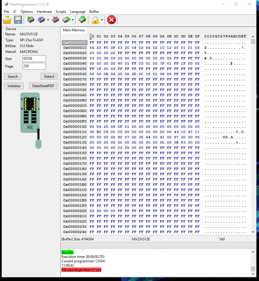

      Asus K53SD v. 5.1 bios
      Good evening. I own an asus k53sd with mb version 5.1. The laptop turns on but does not show anything on the screen. voltages are ok. I dumped the bios with a CH341a and the file is 65kb big. The original Asus bios file is too big to load. I understand that I need to extract only a part of the original file, but I can't figure out which one. Can anyone help me ? Thanks
      • FrozenHaxor
        • Jun 2015

          Thank you very much. Can you help me ? Which part of the "Intel image" should I upload to the Mb ?
          The complete file is too big !
          Can you tell me how to do it?
            Use NeoProgrammer or AsProgrammer software, desolder the chip if you can and attach to an adapter board, or you might have problems if you`re using a clip .Choose the chip manually by the part number on top of it .
            Make 2 backups first, compare the files with HxD hex editor,look at both just make sure there`s some code in them.The backups should be 8MB not 65kb. Post your backup here before flashing any other bios
            https://www.badcaps.net/forum/showpo...04&postcount=7 NeoProgrammer
            https://www.badcaps.net/forum/showpo...6&postcount=10 AsProgrammer
            HxD https://mh-nexus.de/en/hxd/

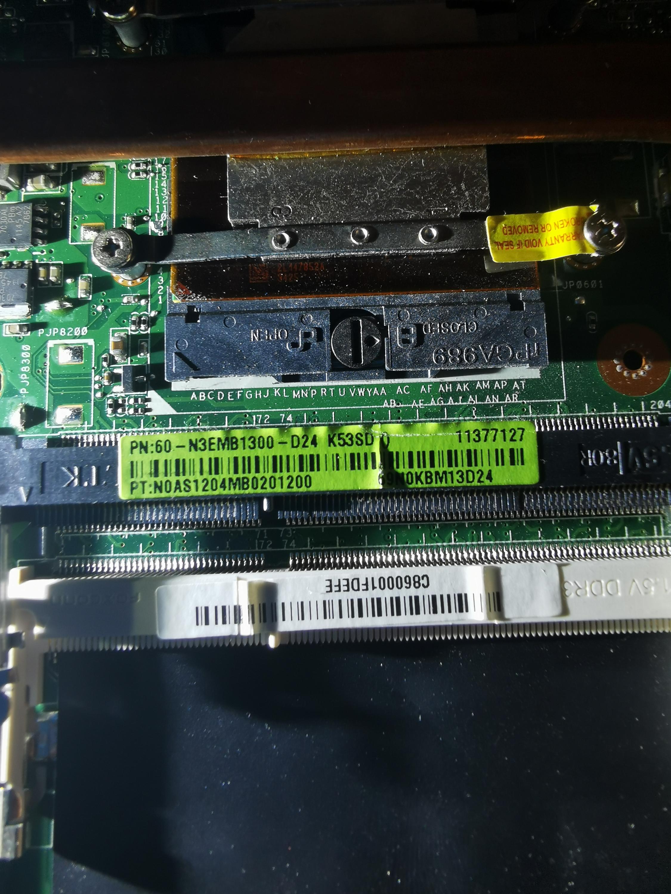

              Re: Asus K53SD v. 5.1 bios
              Post a picture of the green/white barcode sticker on the ram slot as well .
              • ManuCE
                • Sep 2021
                • 13
                • Italy
                Here...thank you for the help.
                  The chip you selected is only 512kb .Find the bios chip,then don`t auto-detect select it manually,look at the part number on top of the chip. Make 2 backups,don`t flash anything yet

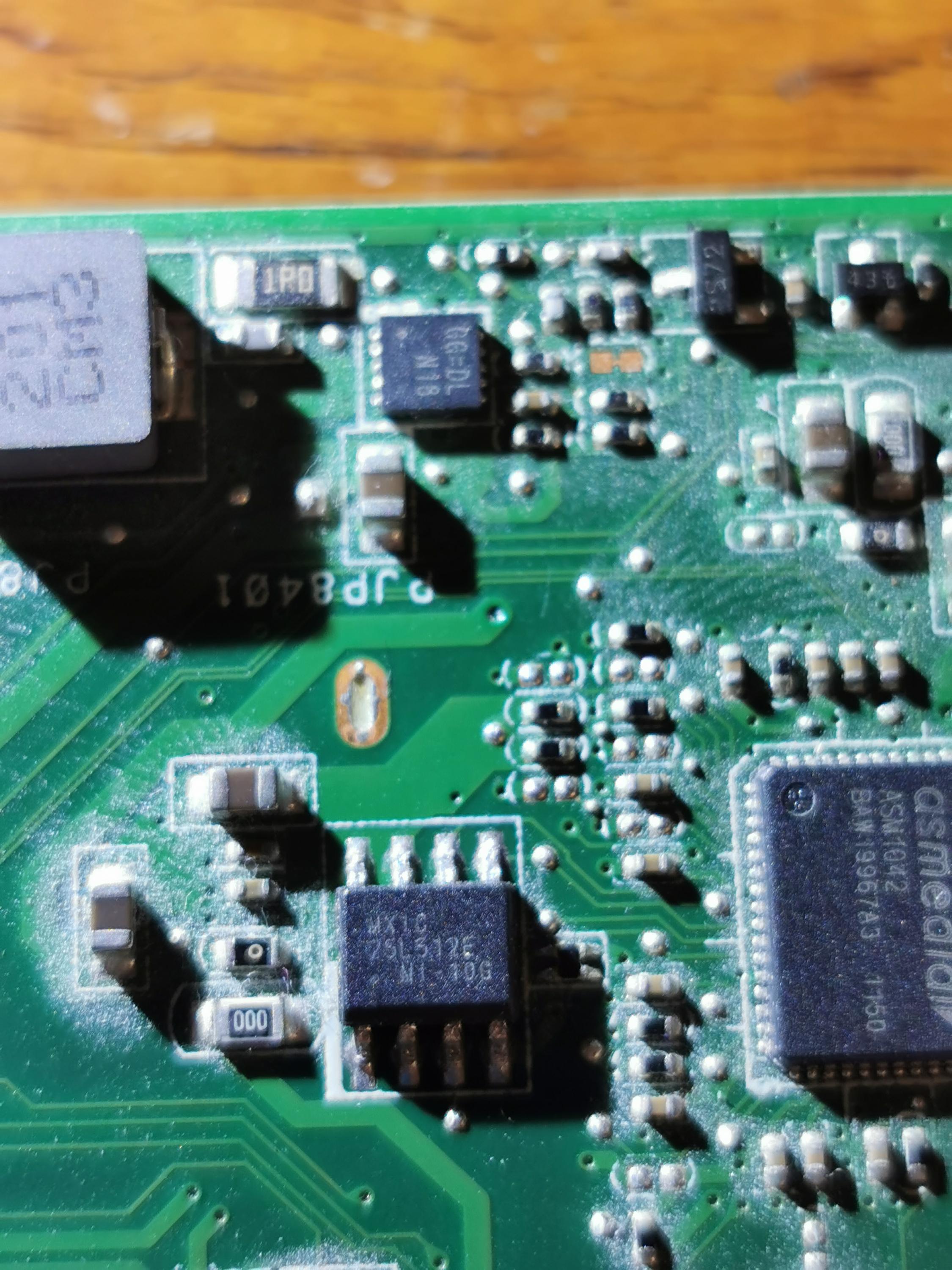

                    The bios chip is an MXIC 25L512E. The data sheet lists it as 512Kb. I attach pictures. Thanks
                        This is the dump of my bios. I don't know if I did it right!
                        I've already flashed...
                        Wrong chip,what you`ve posted is the USB3 firmware for the ASMedia IC .
                        The bios chip is 4MB not 8 as i said at post #4 ,
                        it should say something similar to 25Q32 on top

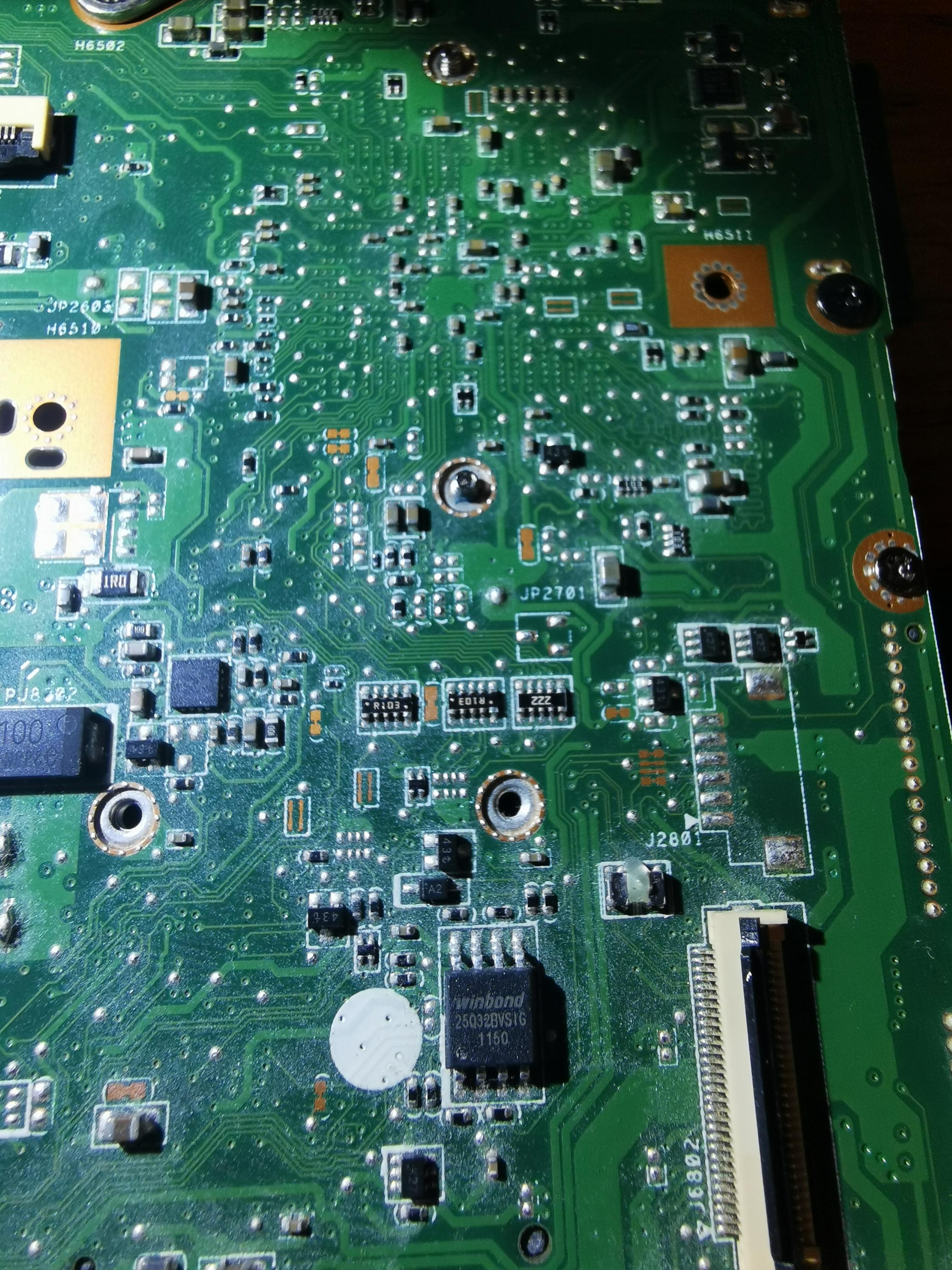

                          The bios chip is next to the big square chip with 128 legs. The bios chip is 4MB not 8 as i said at post #4 ,
                          Could it be this one ?
                            • 22276
                            yes

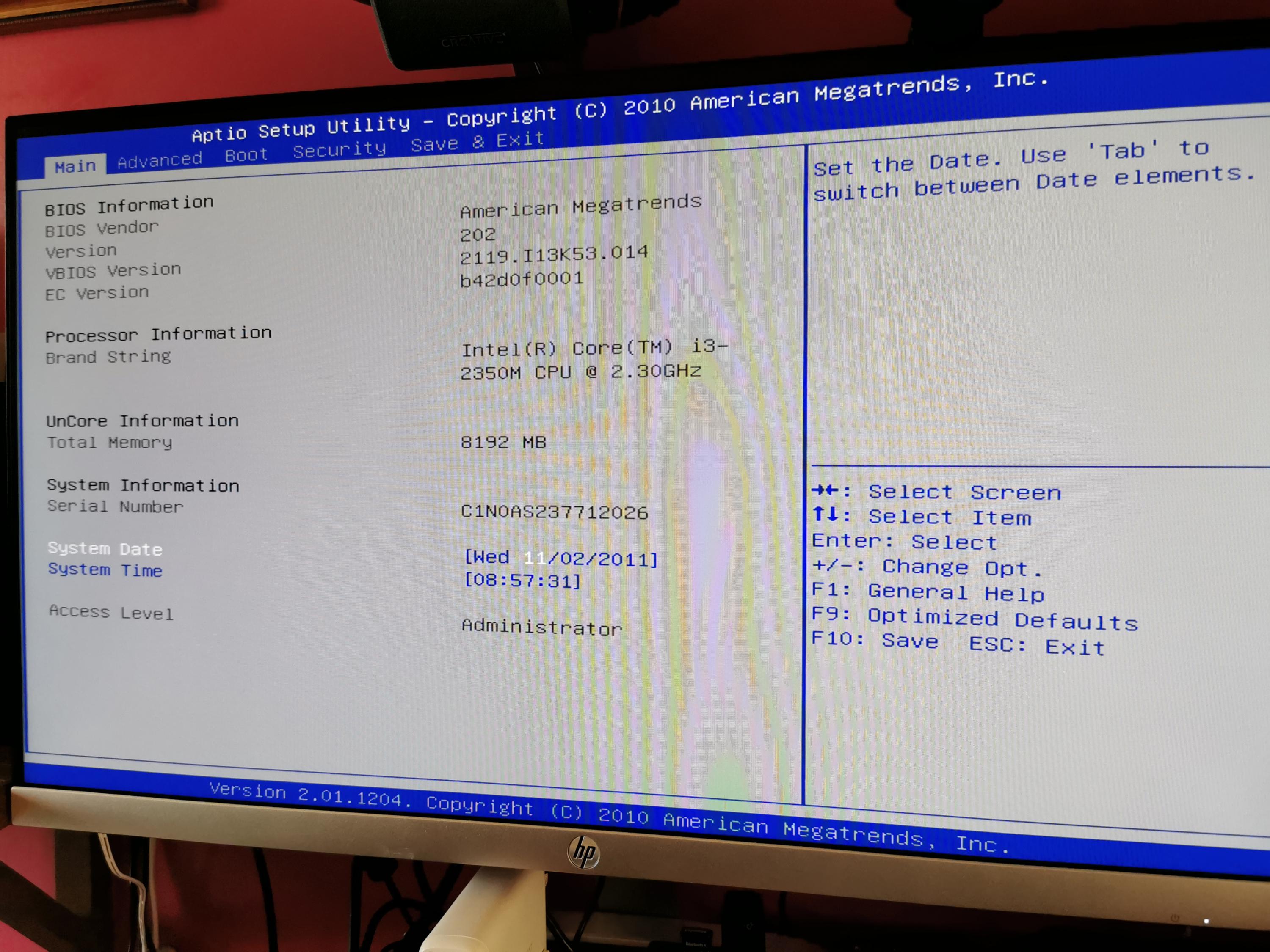

                                yes
                                Good morning. I tried to load the bios "dump_work_rev5.1" but the pc doesn't boot. It turns on but doesn't show anything on the screen. I attach the original bios. Thanks
                                • ManuCE
                                  • Sep 2021
                                  • 13
                                  • Italy
                                  Thank you all. I solved it. Everything works. Without the ram the bios would not start !!! THANKS THANKS
