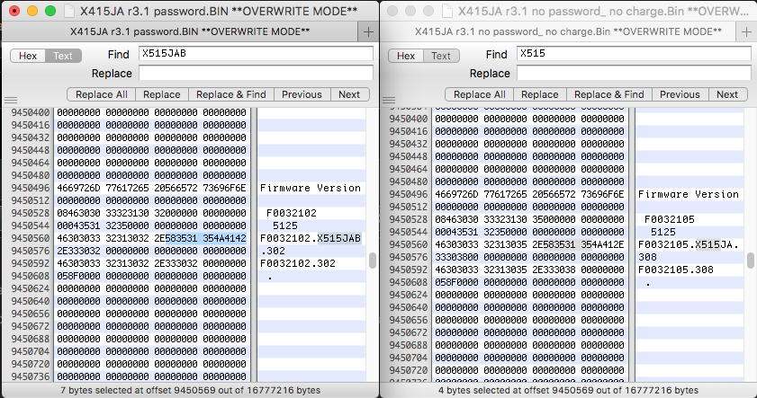

                          Hi, I have this Asus which when turned on displays a password, who can unlock it? thanks for the help
                        • reset1986
                          • Dec 2014
                          • 308
                          • italia
                          #75
                          Asus P1511CJA-EJ2609
                          SN N1NXCX009616035
                          CN C8K6
                          MFD 2022-01 24M
                          • danito
                            • Jun 2016
                            • 950
                            • Romania
                            #76
                            SN N1NXCX009616035
                            CN C8K6
                            MFD 2022-01 24M
                            try
                            • reset1986
                              • Dec 2014
                              • 308
                              • italia
                              #77
                              Originally posted by danito
                              try
                              thanks, the password has been deleted, but I have a problem that with this bios it doesn't charge my battery and the fan doesn't turn, a strange problem, can I solve it? the previous bios works fine but requires password
                              password protected bios, boots, charges battery at 1.5A, battery charges normally,
                              bios without password, it does not turn on with the power cable, it does not charge the battery, absorption at 0A, however with a full battery the PC works until the battery runs out, if I only connect the cable it does not turn on, charging icon indicated but absorption at 0A
                              Is it possible a damaged bios?​
                              • volinakis
                                • Jan 2021
                                • 2734
                                • N/A
                                #78
                                Basically I have this problem,
                                because you are using bios from another motherboard, yours is X515JAB and the other is X515JA. Rookie mistake. Post your serial no. as in RULES of this forum and i'll help you.
                                • reset1986
                                  • Dec 2014
                                  • 308
                                  • italia
                                  #79
                                  SN N1NXCX009616035
                                  CN C8K6
                                  MFD 2022-01 24M
                                  Mainboard X415JA Rev 3.1
                                  Thanks​
                                  • volinakis
                                    • Jan 2021
                                    • 2734
                                    • N/A
                                    #80
