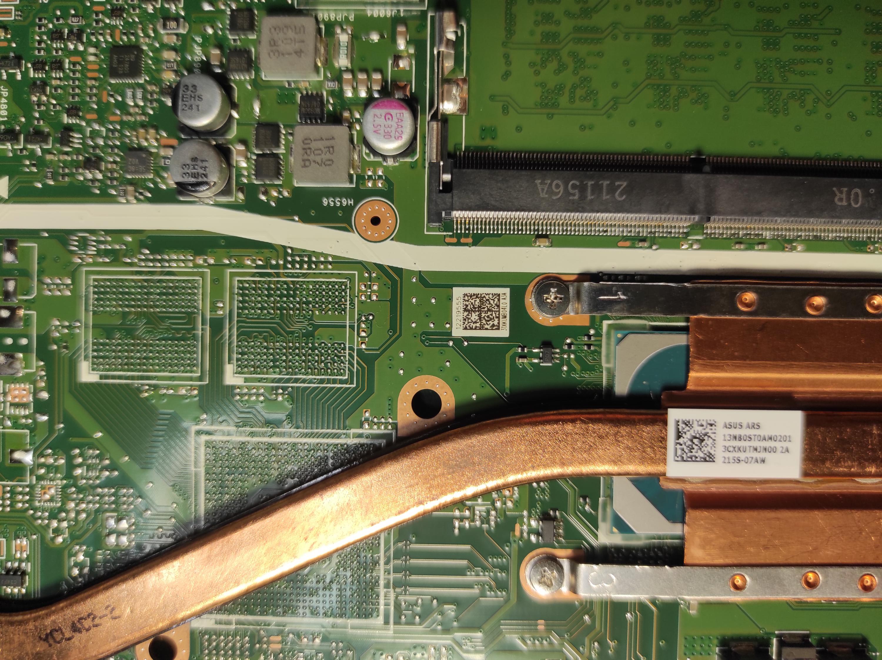

    SN is M4N0CX10F11716A
    Also here is the MB barcode picture

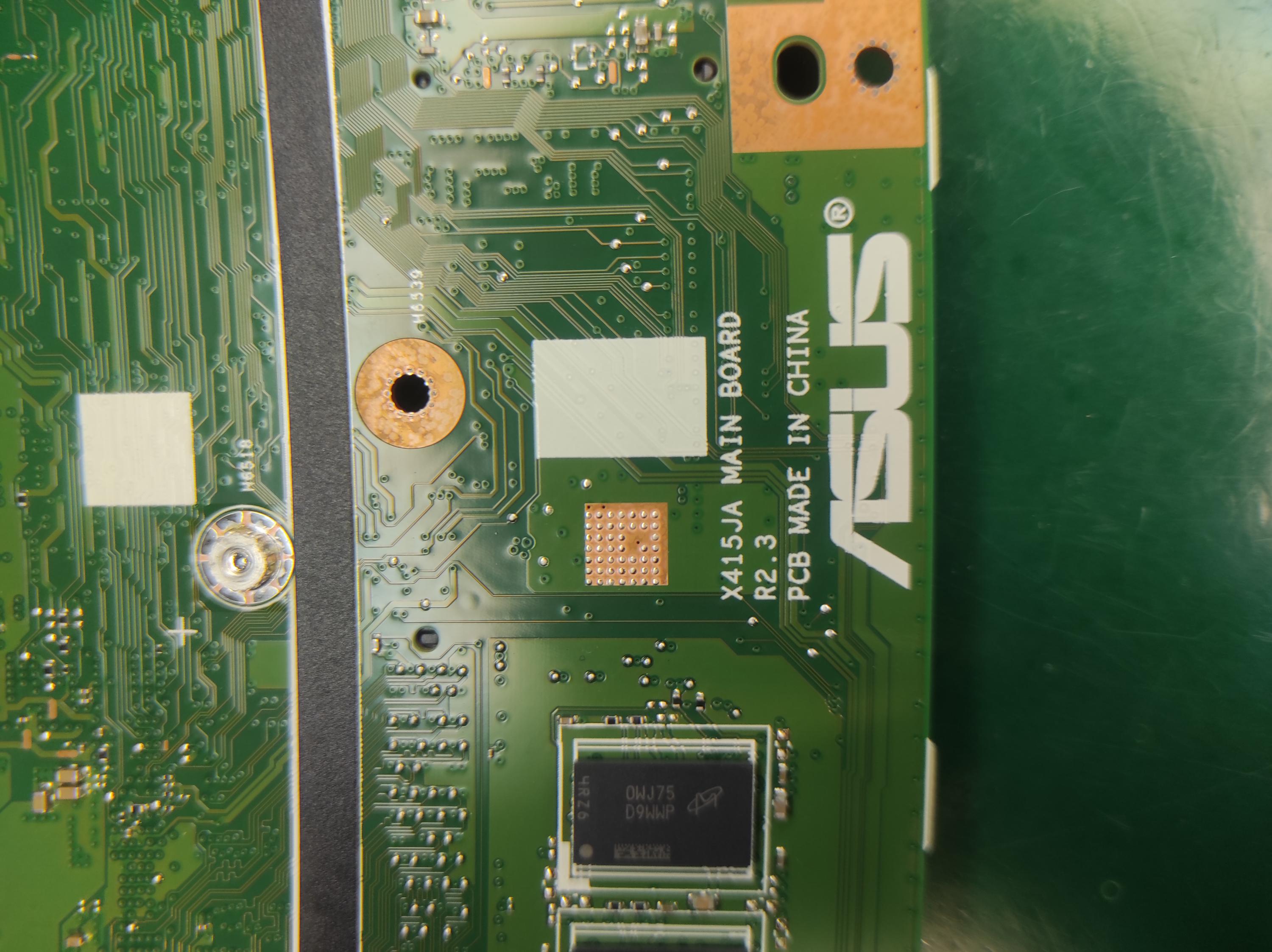

                                #35
                                Re: asus x415ja bios
                                ask for help for ASUS X415JA R2.3 No display
                                Thank you in advance
                                • peste
                                  • Dec 2016
                                  • 13451
                                  • ROMANIA
                                  #36
                                  try post#13
                                  • thix
                                    Mr
                                    • May 2015
                                    • 11
                                    • INDONESIA
                                    #37
                                    Originally posted by peste
                                    try post#13
                                    thank you, already tried but still no display
                                    • lapfix
                                      • Mar 2020
                                      • 2756
                                      • my workshop
                                      #38
                                      Try and give feedback
                                      • thix
                                        Mr
                                        • May 2015
                                        • 11
                                        • INDONESIA
                                        #39
                                        thank you for everything.
                                        it turns out that this bios file is also normal, but it's the processor that needs to be reflowed.
                                        now it is running normally
