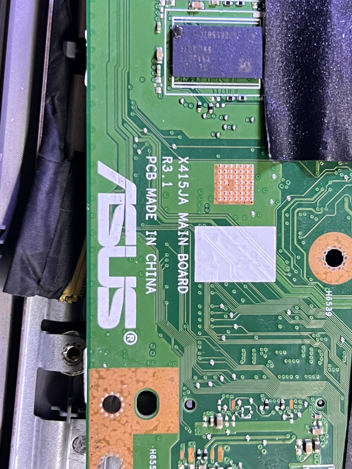

    hey guys i need clean bios for asus x415ja rev4.2
    • peste
      • Dec 2016
      • 13917
      • ROMANIA
      #122
      post S/N, full name and model, motherboard model, etc.
      post the contents of the bios chip even if it is corrupted..

        #123
        asus model: x515j
        sn: r7n0cx04d698295
        x415ja main board

          #124
          asus model: x515j
          sn: r7n0cx04d698295
          x415ja main board
          The bios chip must be unsoldered from the board before writing or reading..
          do not use the clip, you may have errors..if you do not have anything to unsolder it with,
          solder wires between the programmer and the bios chip..
          you need an SPI programmer...here is a video for example..https://www.youtube.com/watch?v=DWWi...nnel=ThisIsHow

            HERE IS THE BIOS BIN BUT NO DISPLAY
            • mrpoures
              PersiaNEngineeR
              • Mar 2022
              • 16
              • Iran
              #126
              here its tested bios 100% working
              this laptop model mostly have bad ram
              (u can bypass ram by disabling it in bios)

                                • fadi4001
                                  • Mar 2016
                                  • 4
                                  • Damascus
                                  #136

                                      Post moved to X415JA topic. Can you scan the QR code on the motherboard and post what it says, or post a good clear picture of it like this one - https://www.badcaps.net/filedata/fetch?id=2100713
                                        • 22275
                                        #139
                                        Originally posted by fadi4001
                                        model - asus R465J-EK278T
                                        m/b - X415JA REV 3.1
                                        serial - M7N0CX15204929B
                                        CN: F6A1
                                        my bios work but when i install windows i have blue screen
                                        Can you DIS RAM in my bios
                                        Try the ram patcher script - https://www.badcaps.net/forum/troubl...20#post3232220 .If it doesn`t work look for the schematic/boardview and try to disable by resistor straps.
