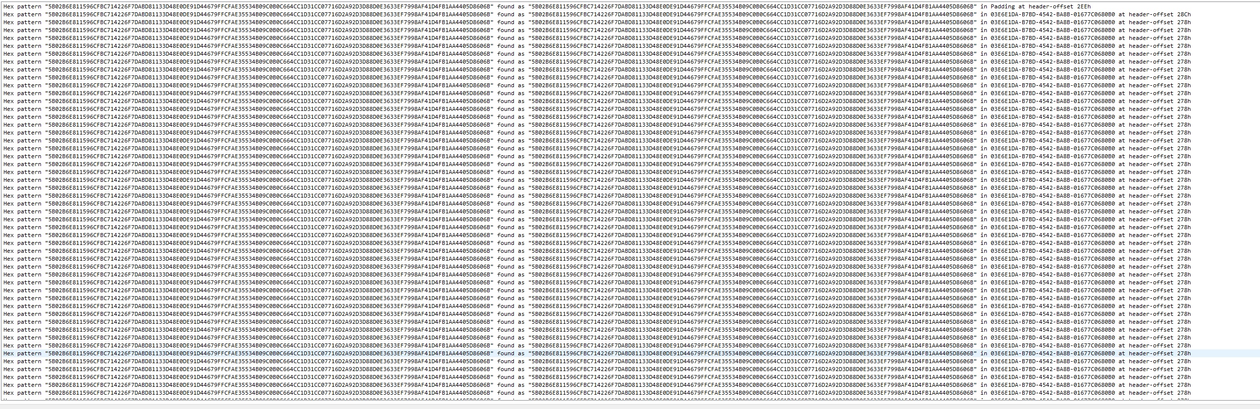

                        #31
                        Re: Panasonic CF53 MK4 CF-532S74RMG
                        looking with
                        5B 02 B6 E8 11 59 6C FB C7 14 22 6F 7D AB D8 11 33 D4 8E 0D E9 1D 44 67 9F FC FA E3 55 34 B0 9C 0B 0C 66 4C C1 D3 1C C0 77 16 D2 A9 2D 3D 88 D0 E3 63 3E F7 99 8A F4 1D 4F B1 AA 44 05 D8 60 6B
                        may be??
                        more repetition in dump

                                    • Maxpower3
                                      Bad Veteran
                                      • Feb 2018
                                      • 1355
                                      • France

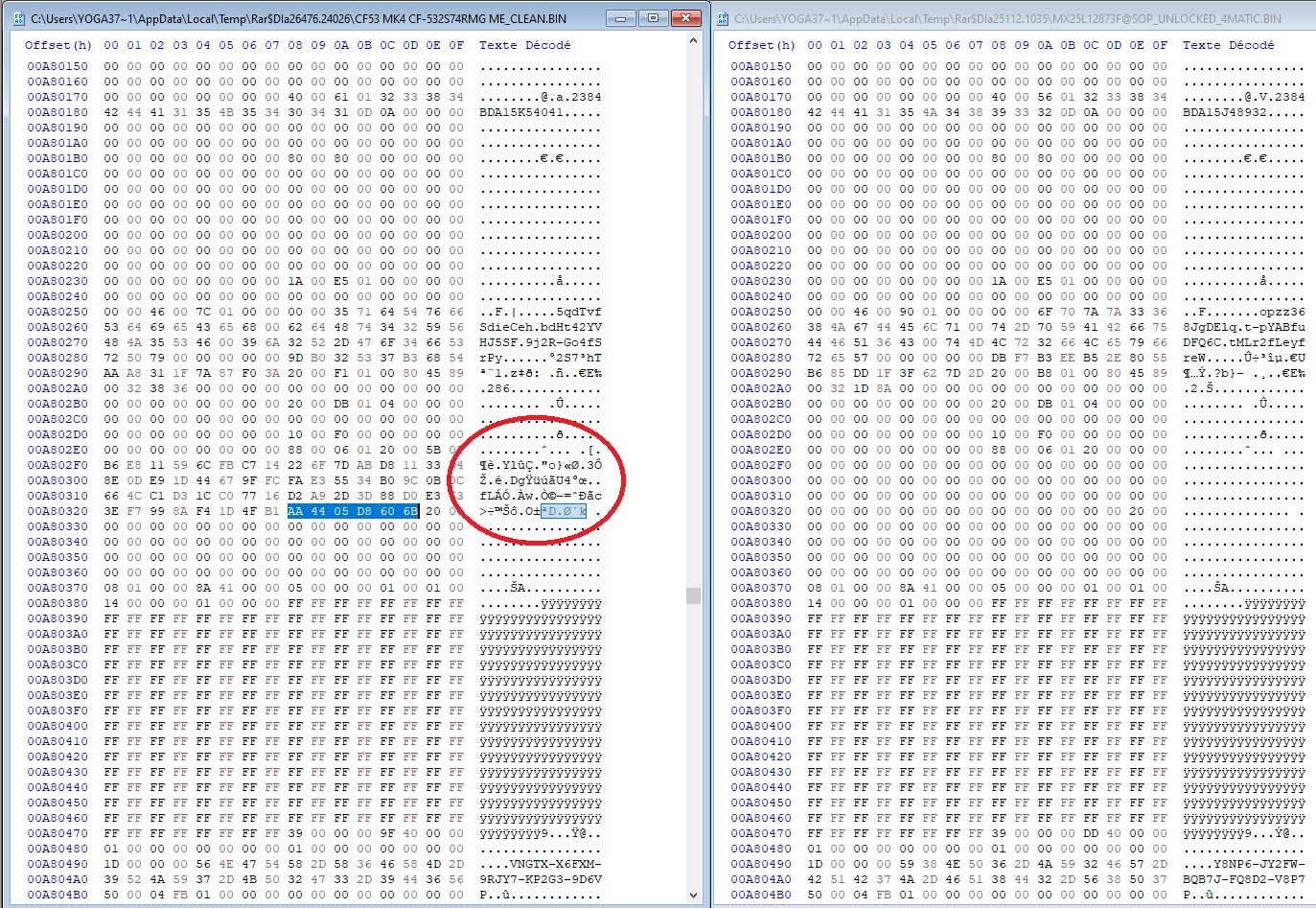

                                      #38
                                      Originally posted by LenBios;
                                      what do you mean exactly? i do not understand
                                      many occurrence of the end of the old encryption key. (AA 44 05 D8 60 6B)
                                      OLD DECRYPT Xor Key: 5B 93 B6 26 11 BA 6C 4D C7 E0 22 74 7D 07 D8 9A 33 2E 8E C1 E9 54 44 E8 9F 7B FA 0E 55 A2 B0 35
                                      0B C9 66 5C C1 EF 1C 83 77 16 D2 A9 2D 3D 88 D0 E3 63 3E F7 99 8A F4 1D 4F B1 AA 44 05 D8 60 6B
                                      AMITSETUP: 5B AB B6 1F 11 CB 6C 7F C7 DE 22 8F 7D 4F D8 7D 33 73 8E 45 E9 5C 44 79 9F 89 FA 11 55 85 B0 2A 0B E3 66 27 C1 C6 1C 6D 77 16 D2 A9 2D 3D 88 D0 E3 63 3E F7 99 8A F4 1D 4F B1 AA 44 05 D8 60 6B
                                      in PADDING and NVAR :5B 02 B6 E8 11 59 6C FB C7 14 22 6F 7D AB D8 11 33 D4 8E 0D E9 1D 44 67 9F FC FA E3 55 34 B0 9C 0B 0C 66 4C C1 D3 1C C0 77 16 D2 A9 2D 3D 88 D0 E3 63 3E F7 99 8A F4 1D 4F B1 AA 44 05 D8 60 6B
                                      I find it weird
                                      • Maxpower3
                                        Bad Veteran
                                        • Feb 2018
                                        • 1355
                                        • France
                                        #39
                                        Originally posted by SMDFlea
                                        Try this one .
                                        you have cleaned well
                                        but there are still 2 occurrences
                                        0xA80328 :5B 02 B6 E8 11 59 6C FB C7 14 22 6F 7D AB D8 11 33 D4 8E 0D E9 1D 44 67 9F FC FA E3 55 34 B0 9C 0B 0C 66 4C C1 D3 1C C0 77 16 D2 A9 2D 3D 88 D0 E3 63 3E F7 99 8A F4 1D 4F B1 AA 44 05 D8 60 6B
                                        0xADAD8E :5B 48 B6 FE 11 42 6C 69 C7 57 22 6F 7D 64 D8 31 33 42 8E 3C E9 5C 44 30 9F AE FA 4F 55 4A B0 E4 0B 4F 66 12 C1 9C 1C 55 77 16 D2 A9 2D 3D 88 D0 E3 63 3E F7 99 8A F4 1D 4F B1 AA 44 05 D8 60 6B
                                        wait return of Lenbios
                                        with the file of post #16 which seems to unlock,
                                        we find written only once.
                                        0xADADC8 : 5B 48 B6 FE 11 42 6C 69 C7 57 22 6F 7D 64 D8 31 33 42 8E 3C E9 5C 44 30 9F AE FA 4F 55 4A B0 E4 0B 4F 66 12 C1 9C 1C 55 77 16 D2 A9 2D 3D 88 D0 E3 63 3E F7 99 8A F4 1D 4F B1 AA 44 05 D8 60 6B
                                        SMDFlea if not working maybe need to remove it ?
