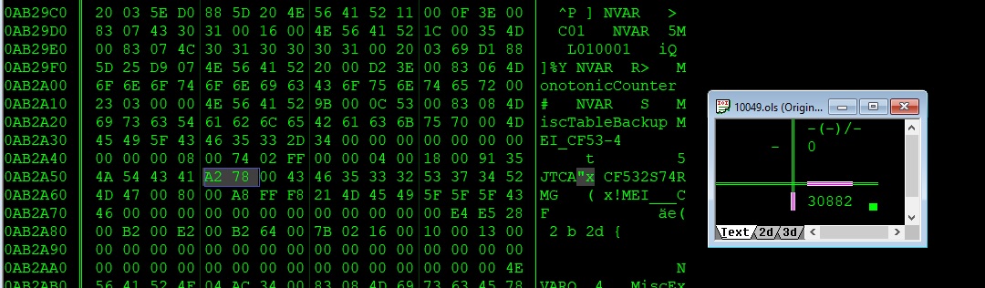

    yes but written many times in several ways and I don't know if any checksum to verify.
    My original patched file is working fine?
    So better to start from an original file and modify it my way if you have other pc to do. You keep the original file like that
    The serial is stored in the ME region in one of the partitions.

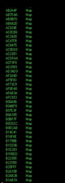

      yes but search and look just with text 5KTCA or 5JTCA
      there are lots of little bits of serial everywhere
      the last digits are coded on 16bits little-endian to ascii
      look at the number of times found serial on my picture
