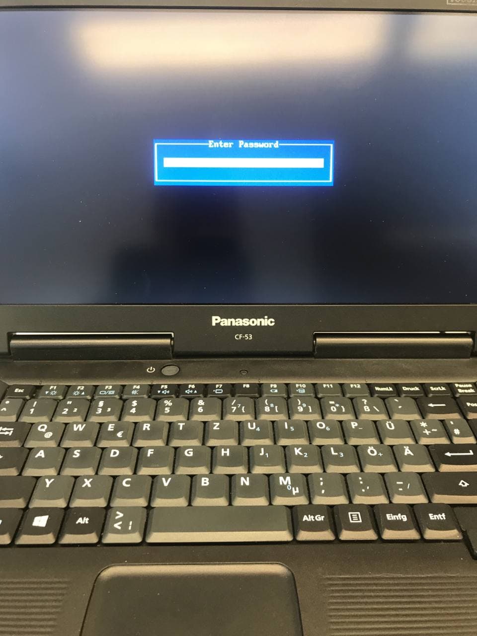

    hi guys, here is my bios file (from CF-532S74RMG). is it possible to remove the bios password? many thanks in advance

      thanks for the fast respond but it doesnt work. the bios password is still there.

        It seems that this type of CF-532S74RMG bios is a little different from some types of Panasonic that I have ever unlocked, passwords are not only stored in NVRAM (amitsetup)...
        but I quite believe that passwords are stored in the bios region
        based on this;
        hxxps: //www.ebay.com/itm/BIOS-CHIP-Panasonic-Toughbook-CF-532-CF-533-CF-534-CF-535-CF-537-CF-53-MK4-serie-/142935839407
        Then I have checked several types of cf53, there are 3 types
        -cf53-4
        -cf53l-4
        -cf53w-4
        I got an biosupdate from Panasonic;
        hxxps: //pc-dl.panasonic.co.jp/dl/docs/077133? dc% 5B% 5D = 002003 & no = 2 & p1 = 185 & p2 = 1850600 & score = 1.0 & sri = 14814591 & trn_org = 2
        the bios that suits for your bios is type cf53-4.
        BIOS_53_V400L20.exe
        i was extracted bios region from that file.. and rebuild with your descrp ,me , gbe region.. and i try to inject your serial nr, win keys and model..
        Now you can try one more time, if that doesn't work then I give up ...
        goodluck and please confirm..

          it worked like a charme. rioreno you are the man. thank you very much.
