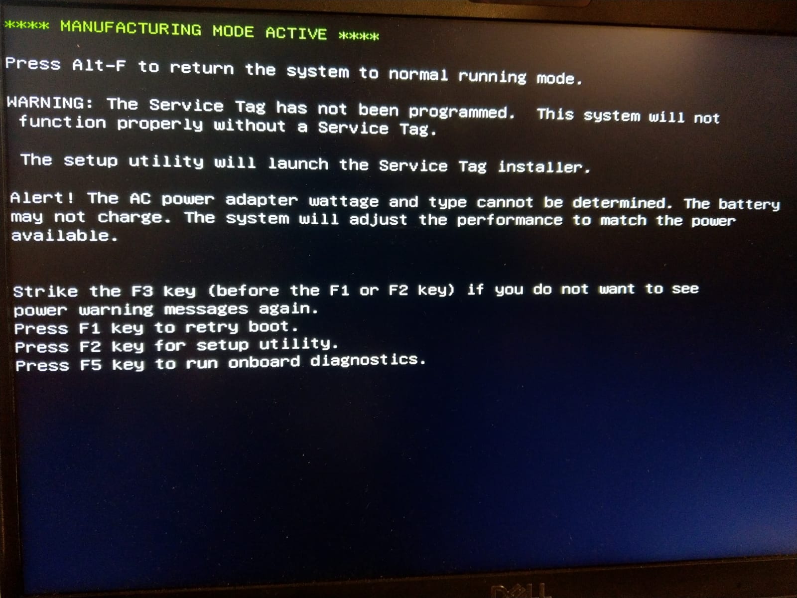

    It doesn't ask for password anymore, but it gives me this at startup

      Re: Dell Latitude 5400 Bios password
      So, what's the problem? Press F2, write Service Tag, save, restart, press Alt+L to exit manufacturing programm, it's written on screen very clear.
        Ok,I managed to solve the problem, I didn't immediately notice where to enter the service tag, but now everything is fine, thanks for your help. Greet
          "The setup utility will launch the Service Tag installer" "Press F2 key for setup utility"

                                          1st boot:
                                          Press F2 to enter System Setup.
                                          Click Security. (Deactivate Absolute Computrace).
                                          Click Service Tag Settings. (Enter old or new Service Tag).
                                          2st boot:
                                          Press <Alt><F> to turn off manufacturing mode.
