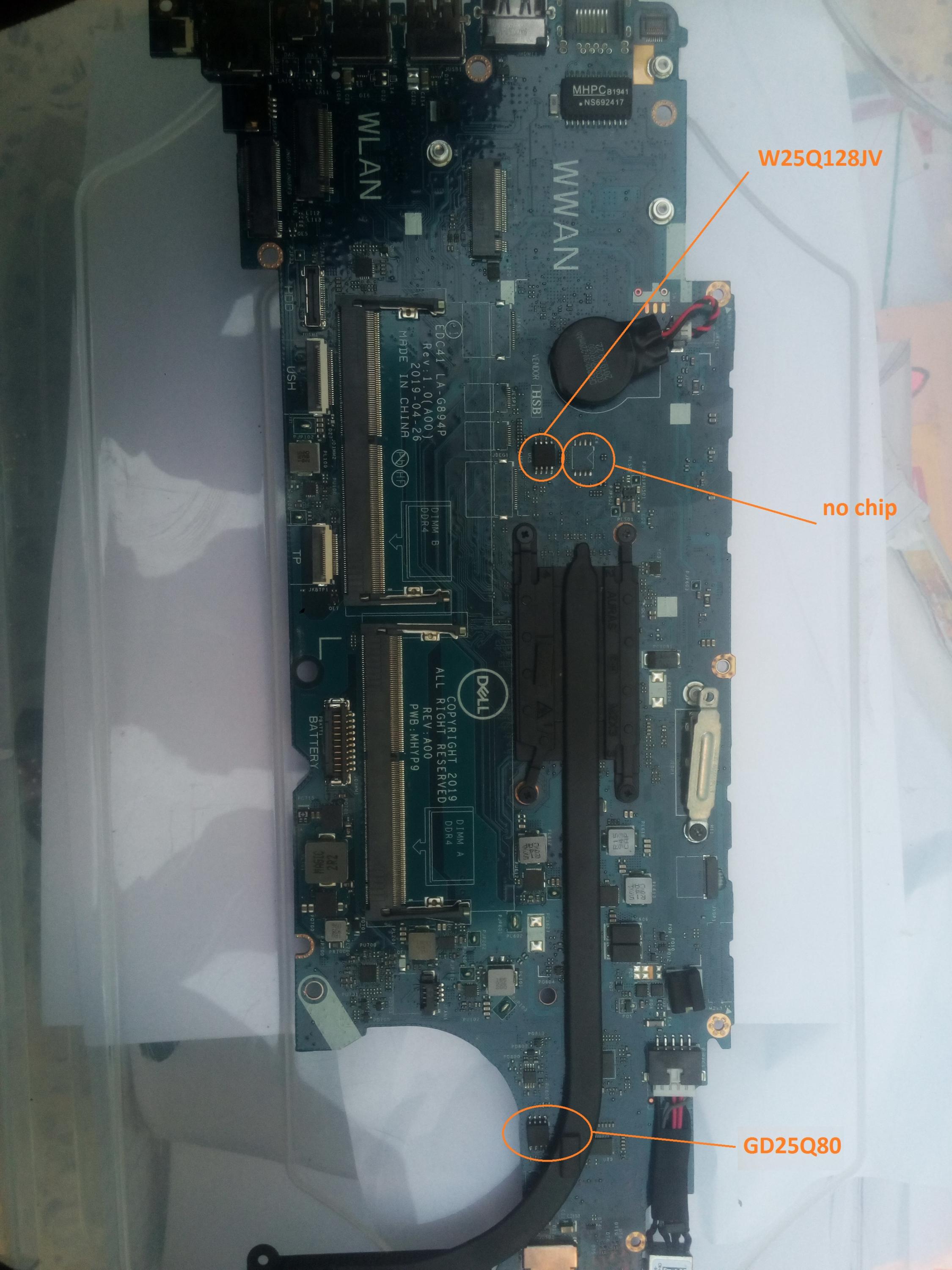

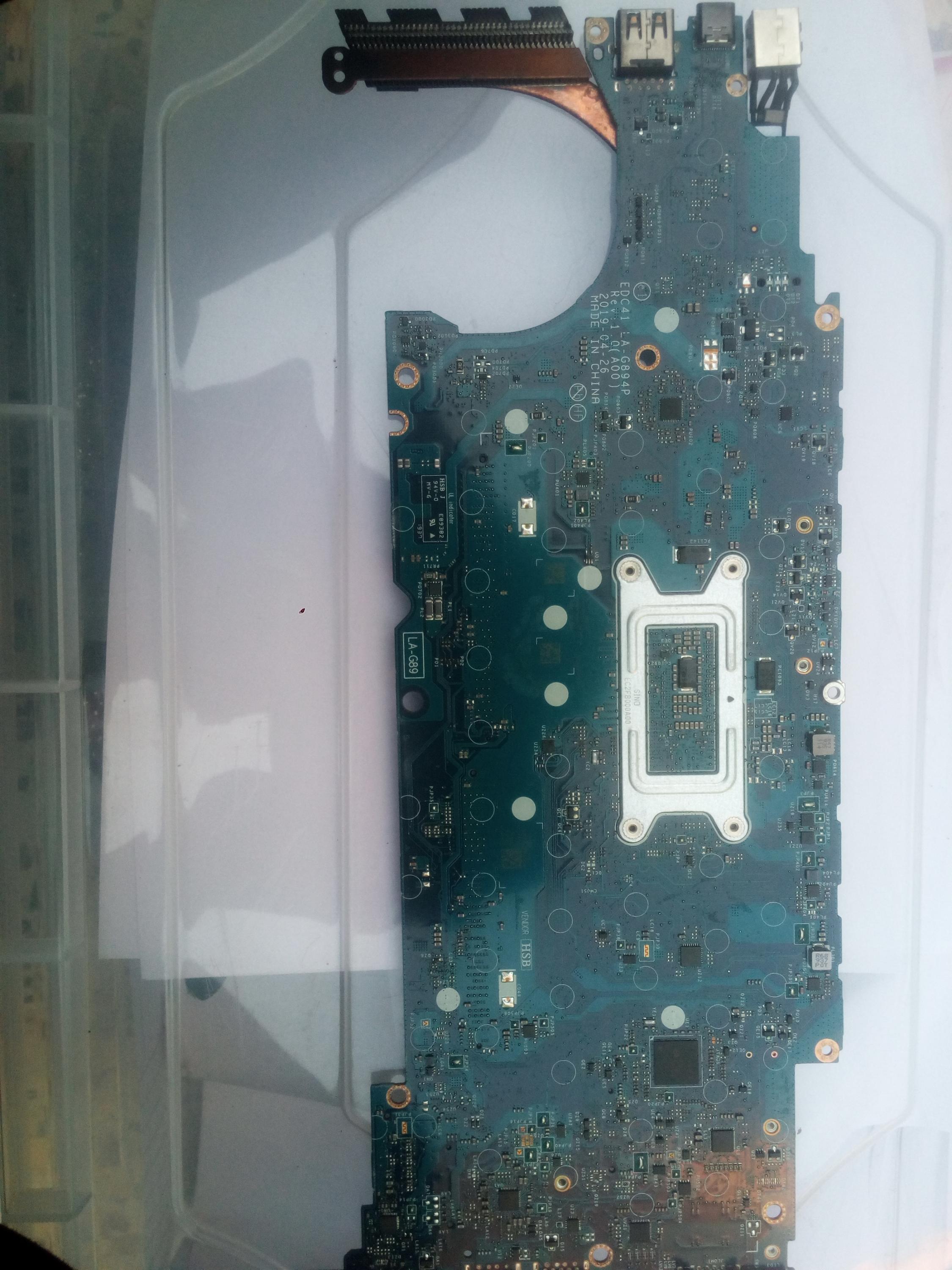

                      • nonomanita
                        • Feb 2018
                        • 30
                        • algeria
                        #71
                        Re: Dell Latitude 5400 Bios password
                        These are pictures of the motherboard.
                          • 22151
                          #72
                          You`re right there is no 8MB bios, checked the 16MB and it has consumer ME FW configuration. (ProSupport Plus ⦁
                          Expires 17 DEC 2022)
