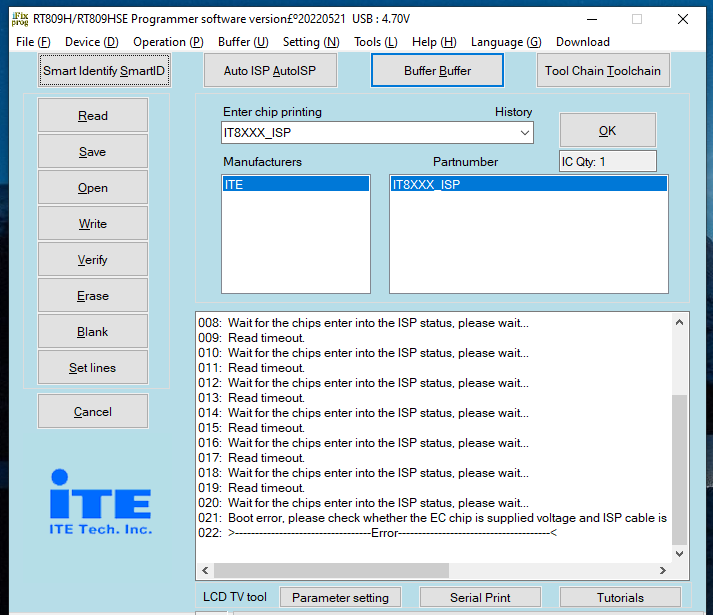

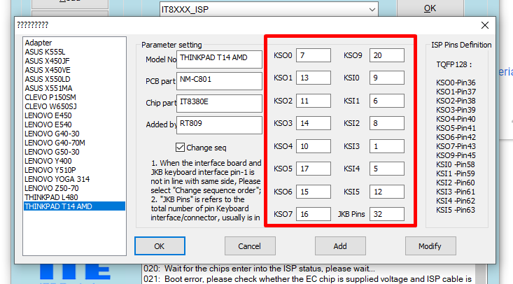

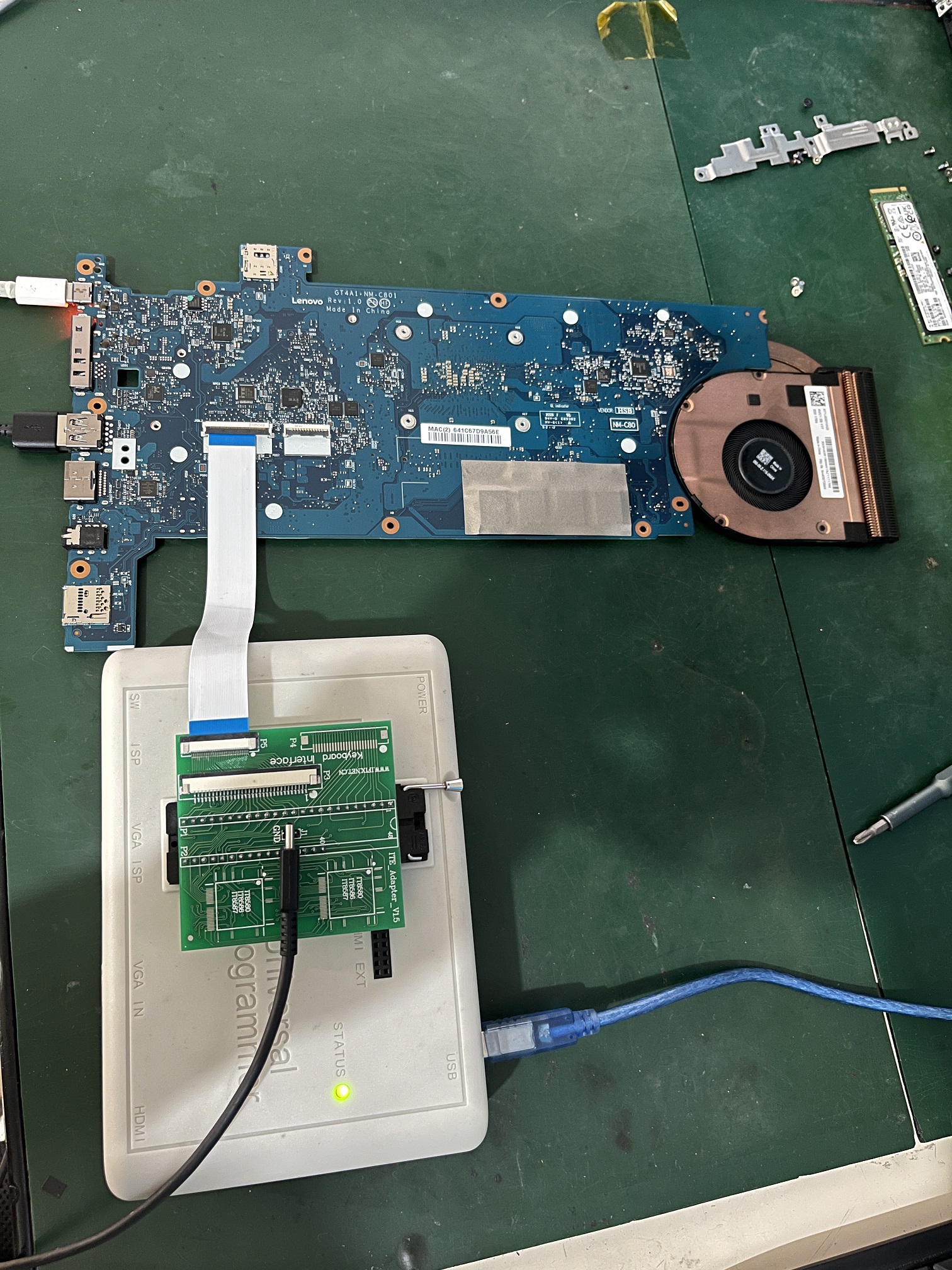

                  Has anyone read the EC IT8300 chip, from thinkpad T14 AMD, using RT809? Mine is giving an error and even with everything right, would there be any other modification on the board that I do to make the reading? I don't have vertyanov and I don't have svod.

                          What kind of help do you expect? All answers was given. Blank eeprom region in EC (jtag) After this you need restore dmi. In my case I still had product name error after restore. It was solved by golden key.
                          Info in eeprom can be decoded by xor FF
