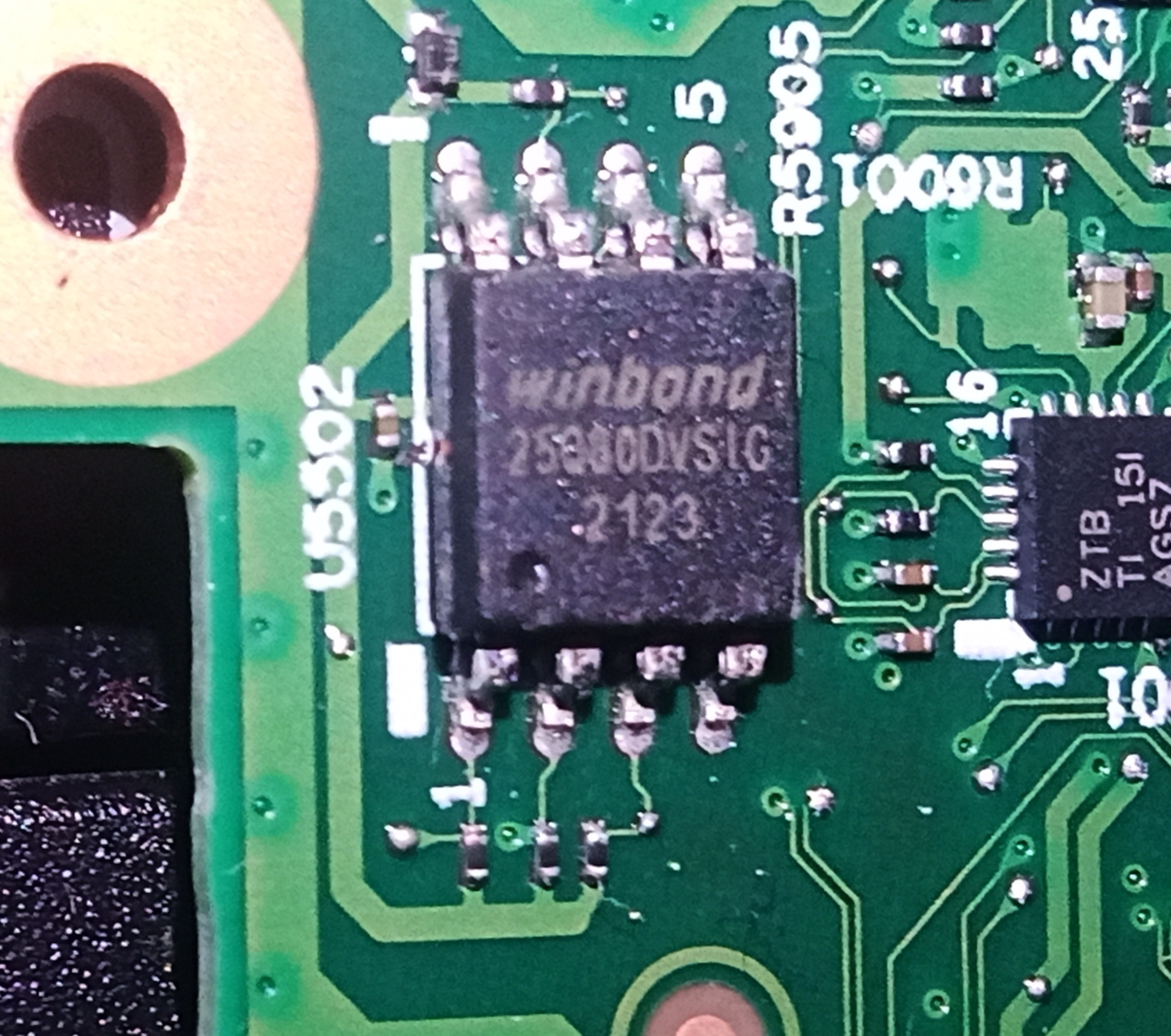

    Hello, it's my first post... So, I Welcome... My English not so strong, and i'm Sorry about that...
    I also have secured Lenovo T14 1st gen, I have programmer EZP2010. When I Try to unlock by autopatcher I have this messege:
    "Using UEFIReplace to inject 2 DXE drivers...
    [1/2] BootOption (GUID e0746c42-d3f9-4f8b-b211-1410957b9ff5)
    LENOVOORG.bin is corrupted or does not contain a valid dump.
    There was an error... Aborting."
    I have few questions... How big should be dump file of this chip? My, is only 1024KB
    There is Winbond 25Q80DVSIG
    It is necessary to solder out this chip? Right now I use clips, to read this chip.
    Can someone tell me, is my dump is correct?
    Thanks in advance

      T14 has no solution, only recording the I/O as far as I know, you can't patch like the other models, your DUMP is wrong, the DUMP of this machine has 32MB.

        WOW Thanks for this fast reply... OK I will try to do better dump. Can You Tell Me something more about I/O recording?

          I don't have an IO recorder but I know "vertyanov" does this job. This chip you read the DUMP on is not the correct one, it's another chip.

                    I was reading somewhere that You don't need pragrammer like this... Yo just can solder wires to correct pins and You can do with normal programator... All You need is schematics, and technical skils

                      yes, it can also be done, but where would the pins be? I've never seen anyone post the pin to make this kind of flash in IO on notebooks.
                        I saw... on this forum, also
                        for example on this subject mec 16xx dump with info block

                          Hi, post clear Fotos from MEC Chip + JTAG. Which programmer do you have?

                            ch341 and tl866.. as soon as I'll post pictures of the machine's MEC chip. But I think the friend below can help before me at this point.

                              you can not use this programmer to read / write MEC

                                  vertyanov or RT809H works always for new Lenovos
                                  Vertyanov is easier no need to solder wires only remove 1 resistor, you can use Keyboard connector to read only eeprom area

                                        If I wil buy Vertyanov Can You help me with T14 removing SVP? Which resistor should I remove, and where is the pasword in dumb of KBC?

                                          b.t.w. I'm searching on this motherboard other chips simillar to bios and there is no other... There is only Winbond 25Q80DVSIG. When I check datasheet of this chip there is writed that it have only 1MB capacity... so how dump can have 32MB?? I try to read again and still have 1MB dump.
