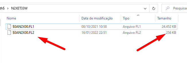

          #85
          Re: ThinkPad T14 Supervisor password
          Originally posted by evserv
          I don't know how your programmer works since I never had one. I can assume that the chip has a jitag lock, that is, you need to first erase the chip, and then upload the firmware there and then restore it with a prom dmi utility.
          The firmware you need can be taken from the BIOS update by first deleting the bytes at the beginning of the file.
          what would be a "prom dmi utility" the EC has already been extracted and edited from the bios downloaded from the site.

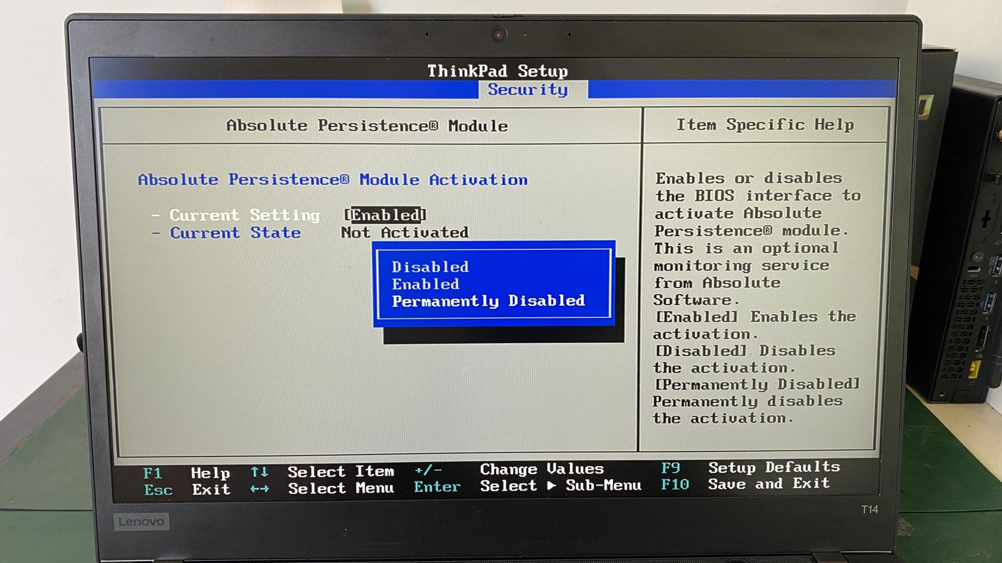

                #88
                After a lot of persistence I was able to remove the bios password from T14! I believe that few here know how to do it and no one shares it, I understand that certain types of information are not shared and are sold! But I persistently come to inform you that the (Thinkpad T14 1st 20S1) was unlocked by an RT809H the only programmer I have. Here are photos in the attachment, now all that remains is to reverse the bios information, but I had taken a photo first of all.
                • 69d0b913
                  • Mar 2018
                  • 146
                  • BR
                  #89
                  Finally, I managed to solve this damn T14 again. Now it works perfectly without a password and without computrace.

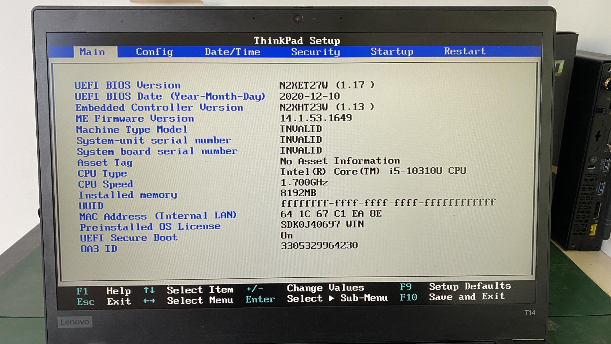

                    #90
                    Unlock password t14
                    can someone help me unlock this ThinkPad T14
                    nm-c801 ver:1.0
                    eeprom 25Q128JWSQ

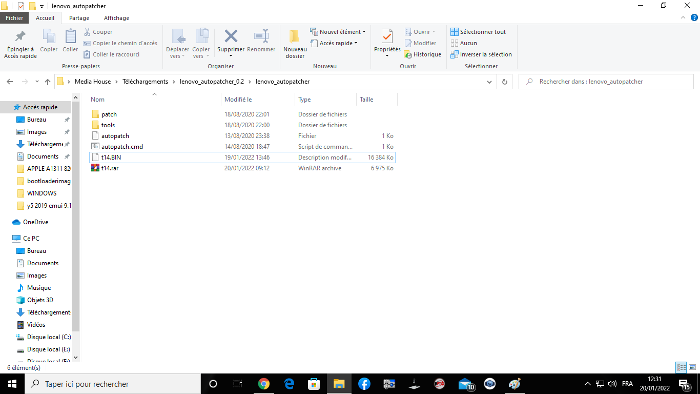

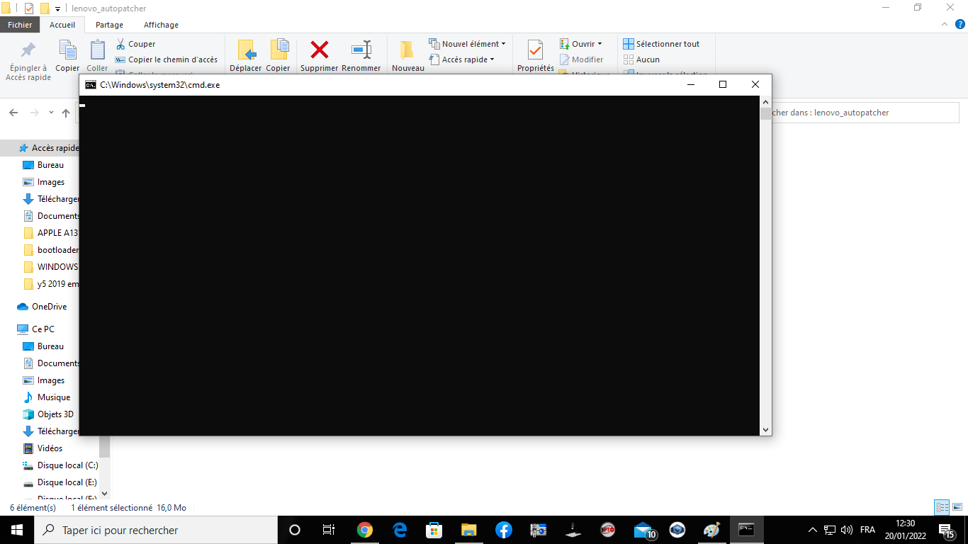

                                PATCH WON'T OPEN
                                JUST PAGE black OPENS AND CLOSES
                                @wajdi.hamed
                                I asked if you know the procedure!! Forum autocorrect doesn't work for you. My auto-patch works for your model.

                                  Re: Unlock password t14
                                  Originally posted by onizzbox
                                  @wajdi.hamed
                                  can you send me my patched bios
