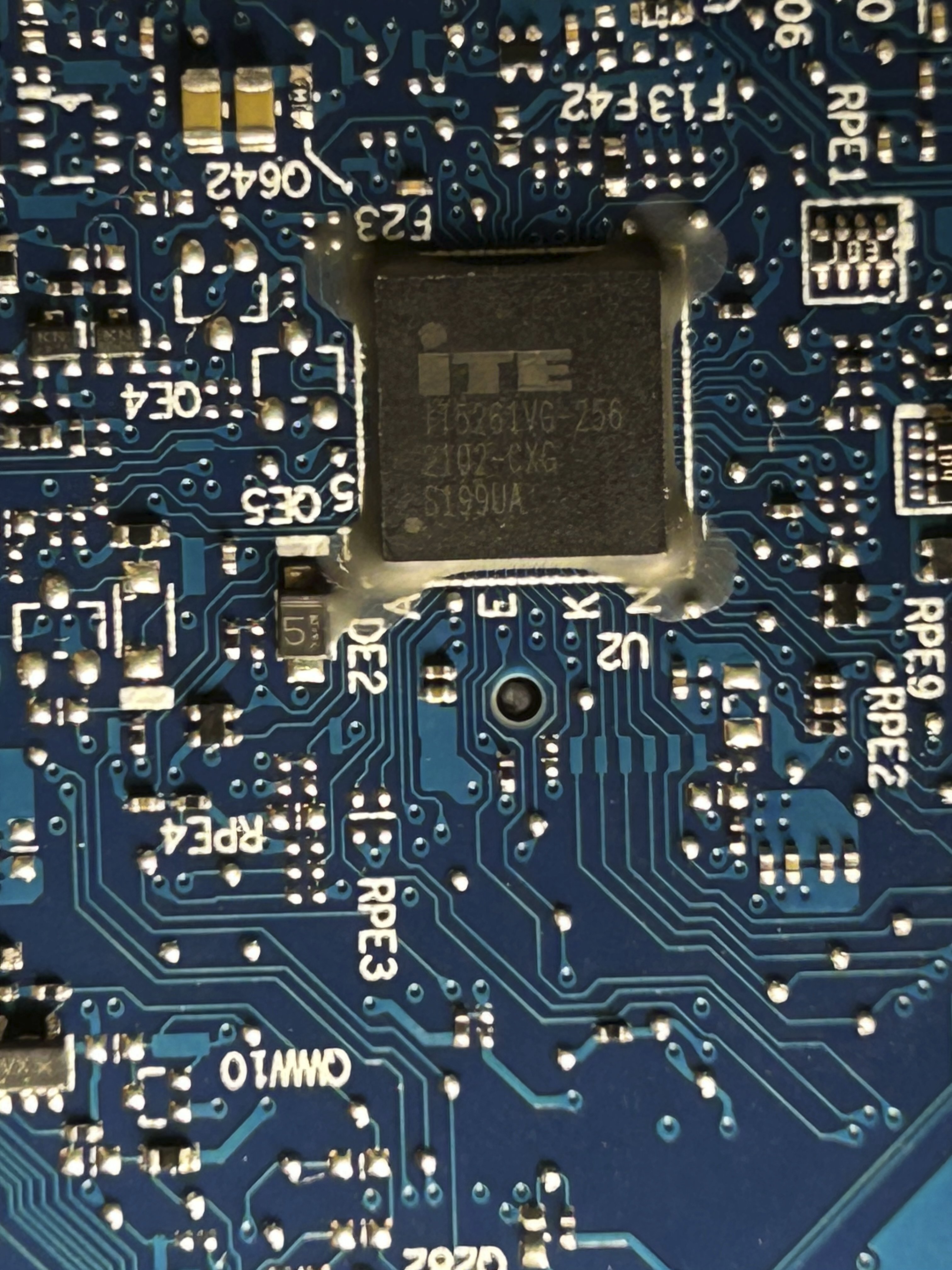

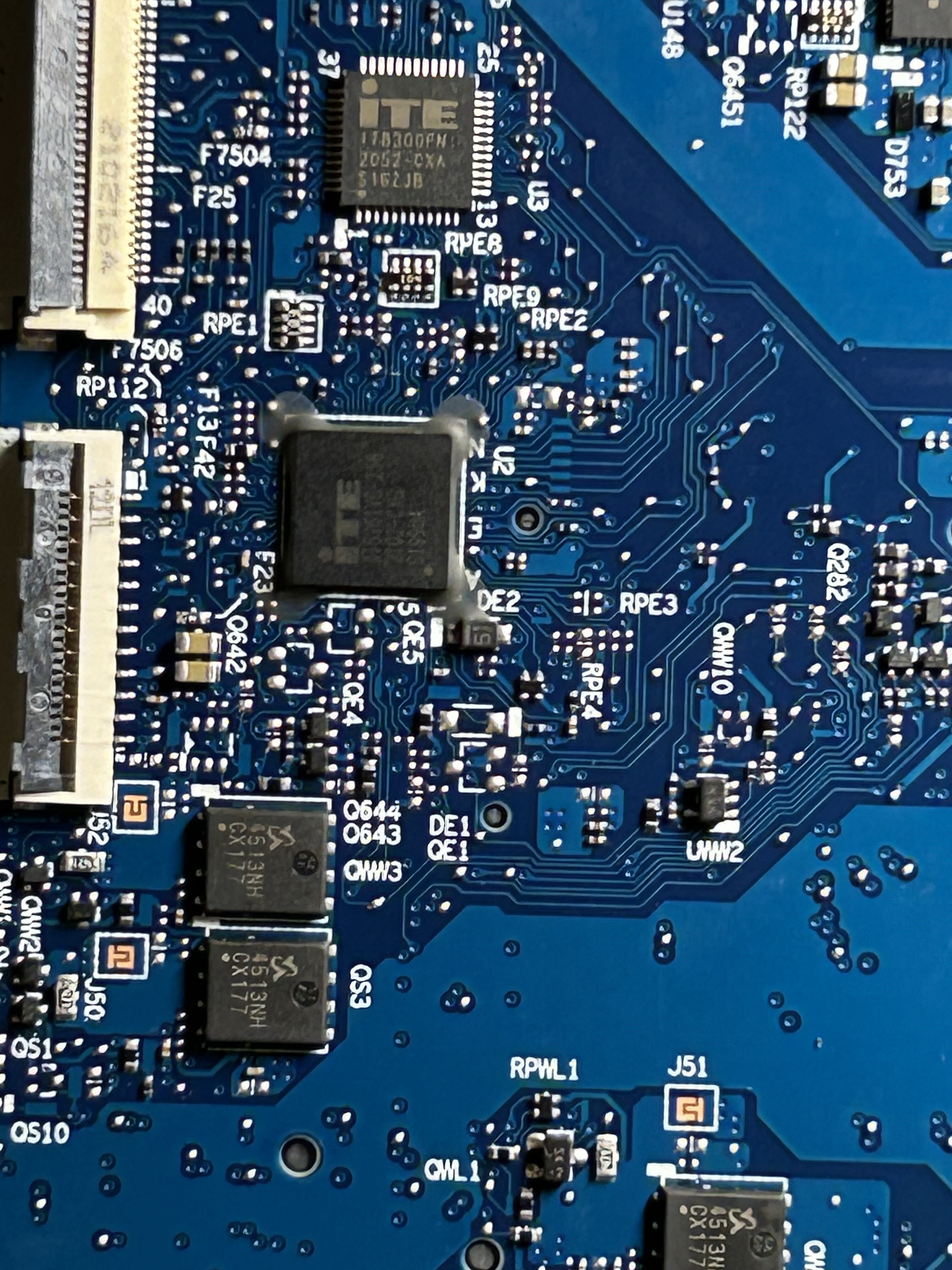

ThinkPad T14 Supervisor password
    replied
    Originally posted by charli
    Lenovo ThinkPad T14s
    nm-c791 motherboard
    Where is the password ec?
    This thread is for the T14 not s T14s .If your motherboard is rev 2.0 please post in this topic - https://www.badcaps.net/forum/troubl...rev-2-0-unlock
    Also, post the laptop serial number it`s required with every bios request - https://www.badcaps.net/forum/troubl...before-posting
    Leave a comment:
  • charli
    replied
    Lenovo ThinkPad T14s
    nm-c791 motherboard
    Where is the password ec?
    Leave a comment:
  • Stefan Steff
    replied
    Originally posted by sundeon
    It didn't work. But i have another one, can you remove password from this one?
    serial number: PF-24097K
    type: 20UE-S0RX00
    board no.: Gt4A1 NM-C801 REV1.0
    Try this:
    Leave a comment:
  • sundeon
    replied
    try but it's not like usual.
    What is EC?? ITE
    It didn't work. But i have another one, can you remove password from this one?
    serial number: PF-24097K
    type: 20UE-S0RX00
    board no.: Gt4A1 NM-C801 REV1.0
    Leave a comment:
  • sundeon
    replied
    try but it's not like usual.
    What is EC?? ITE
    Yes it is ITE, will try out today and get back to you! thanks
    Leave a comment:
  • Maxpower3
    replied
    Originally posted by sundeon
    Sorry! here is the 256kb file
    try but it's not like usual.
    What is EC?? ITE
    Leave a comment:
  • sundeon
    replied
    Originally posted by hoaca388
    File is incomplete, try 256KB.
    Sorry! here is the 256kb file
    Leave a comment:
  • hoaca388
    replied
    Originally posted by sundeon
    Hi guys!
    I managed to read the ec from a Thinkpad T14 Gen 1 with a SVOD4, can someone help me remove the supervisor password from it?
    serial number: PF-2ZM1FZ
    type: 20UE-S56E00
    board no.: Gt4A1 NM-C801 REV1.0
    File is incomplete, try 256KB.
    Leave a comment:
  • sundeon
    replied
    Hi guys!
    I managed to read the ec from a Thinkpad T14 Gen 1 with a SVOD4, can someone help me remove the supervisor password from it?
    serial number: PF-2ZM1FZ
    type: 20UE-S56E00
    board no.: Gt4A1 NM-C801 REV1.0
    Leave a comment:
  • hamma_tn
    replied
    Hello everyone, I hope you're doing well.
    I need your help, please. I'm trying to understand if it's possible to remove the supervisor password on a Lenovo ThinkPad T14 Gen 4 (AMD version).
    I've read several threads on the forum, but I couldn't figure out which method actually works for the T14 Gen 4 AMD. Some mention using a motherboard jumper, others talk about a special USB key, and I also saw something about using an SVOD4 device.
    To keep it simple: Is it possible to remove the supervisor password on a T14 Gen 4 AMD?
    If yes, what is the correct method to do it?
    If needed, I can provide the required information such as BIOS details, dumps, etc.
    Thanks in advance for your help!​
    Leave a comment:
  • PMDev
    replied
    Can someone could write step by step guid how to remove password on lenovo T14 gen 1 AMD NM-C80 Rev 1.0? And what if there is something like password-on instead of supervisor password?
    Leave a comment:
  • ledro
    replied
    Originally posted by Carrie Takamiya
    Hello, Found how to remove abtstate on the laptop by checking on the p53 post that was shared. Here is what i changed to remove that.
    Thanks for the helpful posts!
    It also worked on T14 gen 1 AMD NM-C801.
    Thanks!
    Leave a comment:
  • dahnking
    replied
    Originally posted by santoslao
    Re: ThinkPad T14 Supervisor password
    Has anyone read the EC IT8300 chip, from thinkpad T14 AMD, using RT809? Mine is giving an error and even with everything right, would there be any other modification on the board that I do to make the reading? I don't have vertyanov and I don't have svod.
    Has anyone managed reading EC IT8300 on thinkpad T14 AMD, using RT809??
    Leave a comment:
  • Maxpower3
    replied
    Originally posted by Carrie Takamiya
    Hello, Can somebody help me remove Absolute Persistence from this bios.
    Lenovo Thinkpad T14 Gen1 i7
    Serial Number: PF-22ABKR
    Type Number: 20S0-002VUS
    Motherboard Number: GT4A0/GT5A1/GP4A0/GT4A2 NM-C931 REV: 1
    Thanks in advance!
    Click image for larger version  Name:	image.png Views:	0 Size:	8.9 KB ID:	3579326
    not sure that the PC will restart with this generation.
    you have to try
    edit : I didn't see that you responded to the post yourself​
    Last edited by Maxpower3; 02-23-2025, 10:11 AM.
    Leave a comment:
  • Carrie Takamiya
    replied
    Hello, Found how to remove abtstate on the laptop by checking on the p53 post that was shared. Here is what i changed to remove that.
    Thanks for the helpful posts!
    Leave a comment:
  • Carrie Takamiya
    replied
    Hello, Can somebody help me remove Absolute Persistence from this bios.
    Lenovo Thinkpad T14 Gen1 i7
    Serial Number: PF-22ABKR
    Type Number: 20S0-002VUS
    Motherboard Number: GT4A0/GT5A1/GP4A0/GT4A2 NM-C931 REV: 1
    Thanks in advance!​
    Leave a comment:
  • wraster
    replied
    Hi! I am excited to learn about these chips. Can someone tell me if one of these chips is the embedded controller with the supervisor password stored on it?
    This is on a NM-C801 motherboard from a T14 Gen 1 w/AMD Ryzen 7.
    ITE IT8300FN
    or
    ITE IT5261VG-256
    Thank you!
    Leave a comment:
    commented on 's reply
    Thread merged.
  • Sanj242
    replied
    Hi, I need the administrator bios for the below if you could help please be much appreciated!
    Lenovo Thinkpad T14 Model: 20S1S6Q909
    Serian Number: PF24B3FP
    Type Number: 20S1-S60900
    Motherboard Number: GT4A0/GT5A1/GP4A0/GT4A2 NM-C931 REV: 1
    Last edited by Sanj242; 01-05-2025, 11:43 AM.
    Leave a comment:
  • BMCappelletti
    replied
    Originally posted by testinglaptops
    Password in SIO. you need vertyanov successor or Svod 4 programmer.
    Someone wrote here that patching was not doable on 32MB BIOS chip.
    I have a T14 gen 1, but it has a 16MB BIOS. Any chance?
    I see some people that after trying the patch only got black screen. I don't want to risk, as the machine is usable. Although I could write the original file later if that happens.
    Leave a comment:
  • badzymandiaz
    Thinkpad P14s Gen 4, BIOS Supervisor Password
    by badzymandiaz
    I have a laptop that was purchased second-hand, and I am able to boot Windows on and extract the BIOS dump (ONLY the BIOS region, I was unable to dump anything else due to an FCERR I received trying to dump the other regions) and use normally. However, because the BIOS is locked with a supervisor password, I am unable to use anything else except for Windows, and it has also disabled some hardware features of the laptop itself, such as the fingerprinting module, etc. that I really do wish to use.
    I have been digging around for nearly 2 weeks trying to find any mention of the same model...
    09-28-2025, 10:49 AM
  • Andreasandreou
    Lenovo Thinkpad T14s GEN 4 Supervisor Password Bypass
    by Andreasandreou
    Hello, I have Lenovo Thinkpad T14s GEN 4 serial number GM-0FK2ER laptop. It was brought to me by a customer to reinstall windows. The problem is it is locked with a superviser password. Can anyone please give instructions on how to reset the bios or bypass the supervisor password? Thank you.
    09-02-2025, 09:45 AM
  • vijayppatel017
    Lenovo Thinkpad X13 Gen 6 BIOS Supervisor Password Remove
    by vijayppatel017
    i have Lenovo Thinkpad X13 gen 6. with supervisor password enable. anyone know how to remove it. as i am starting this thing first time so dont know. but i am good in solder.
    10-12-2025, 09:04 AM
  • Badpatch02
    Thinkpad X380 Yoga supervisor password removal + Intel ME removal question
    by Badpatch02
    Hi all, I'm new here, a few words about myself: CS student, interested in hardware stuff too - tinkering my whole life but with practically no experience when it comes to firmware "hacking".
    So I have this X380 Yoga with a supervisor password in place and before doing anything stupid I figured I'd rather ask.
    I plan on using the tool from this thread: https://www.badcaps.net/forum/troubl...password-remov...
    11-30-2024, 05:22 AM
  • AppleLover123
    Lenovo Yoga X380 22LH Supervisor Password removal
    by AppleLover123
    Hey guys,
    have a laptop here that has a supervisor Password (dump in Attachements).
    Before i write the Serial NR.etc i wanted to say that strangely after flashing with 3 different Bios dumps and one from lenovos site
    the laptop works but everytime it wants me to type a supervisor password i never set.
    I thought the supervisor password is stuck in the ec bios but no it isn't either because after replacing the ec chip from one of another board it still has the supervisor password.
    Anyway i wanted to ask what of the two chips is the ec bios because on the left...
    04-17-2025, 03:42 PM
