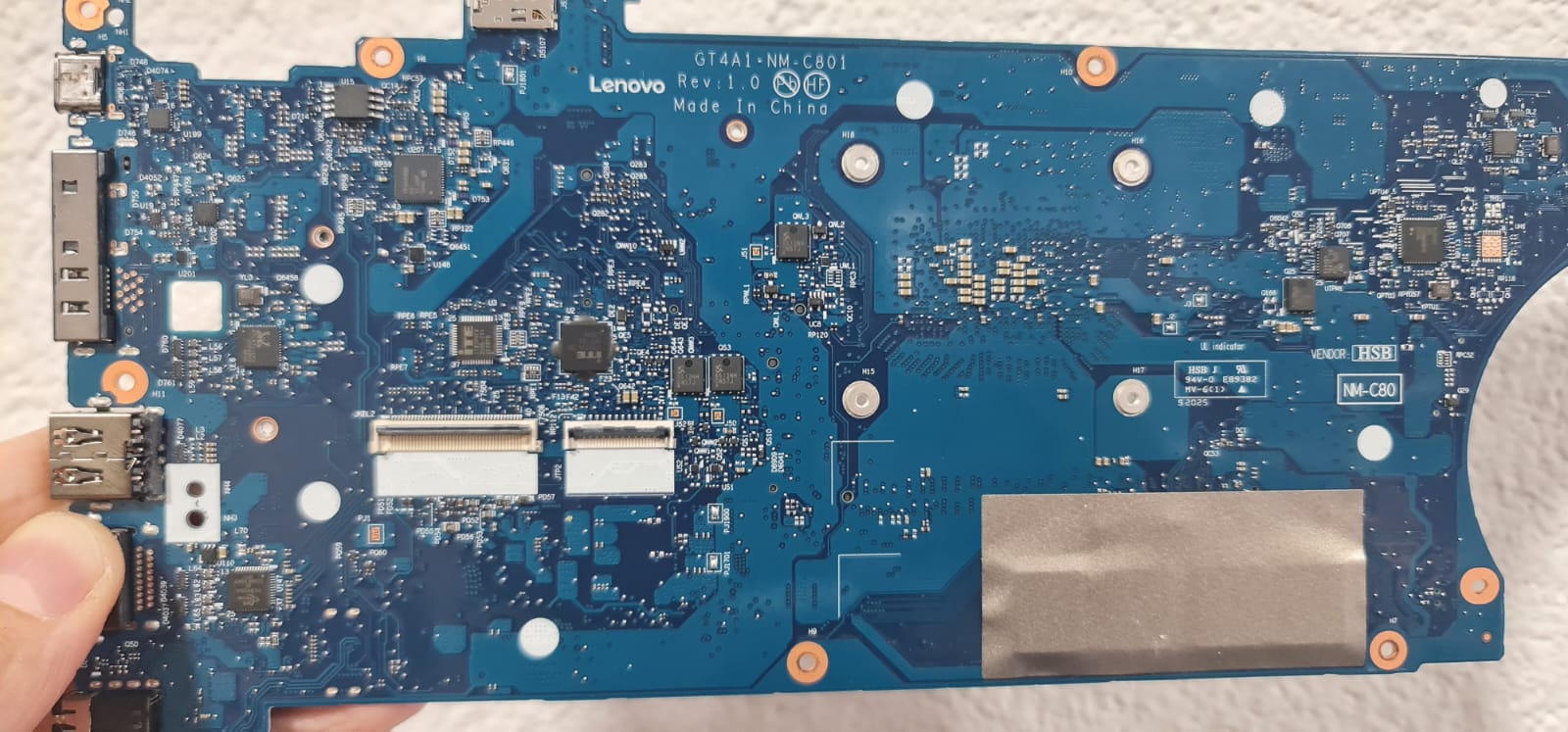

                                      Hi! I am excited to learn about these chips. Can someone tell me if one of these chips is the embedded controller with the supervisor password stored on it?
                                      This is on a NM-C801 motherboard from a T14 Gen 1 w/AMD Ryzen 7.
                                      ITE IT8300FN
                                      or
                                      ITE IT5261VG-256
                                      Thank you!
