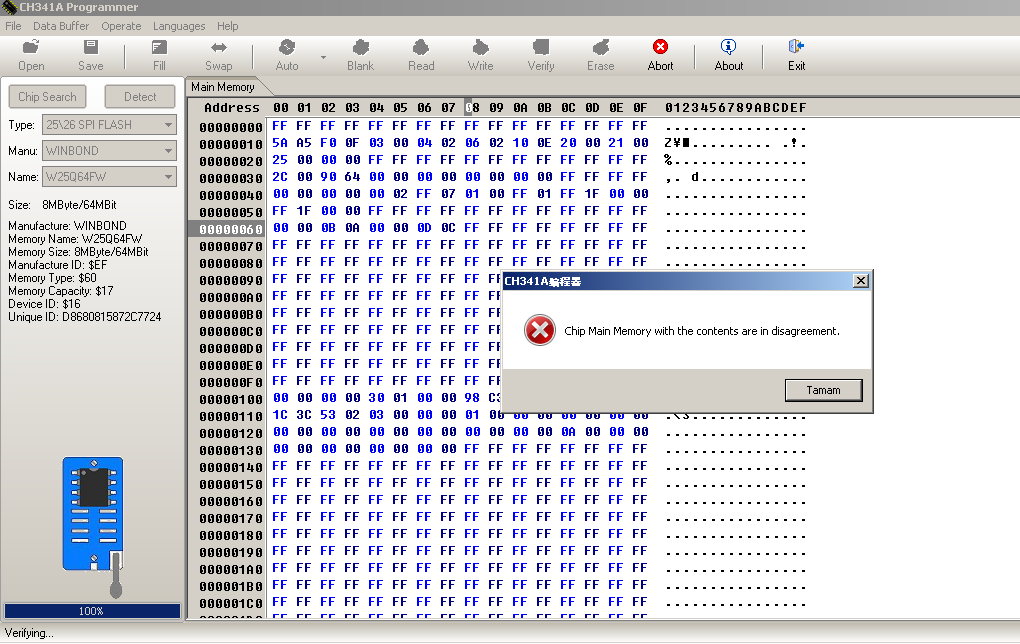

          and i m always getting this error with all dumps on the forum..
          "chip main memory with the contents are in disagreement"
          but there is no pb with backup bios file..(T101HA_306sw_W25Q64FW 1.8V)​

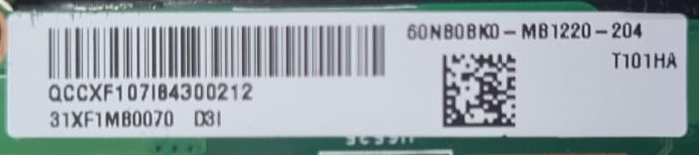

            post the laptop serial number https://www.badcaps.net/forum/troubl...before-posting
            Use alternative software. NeoProgrammer , ASProgrammer ,Flashrom

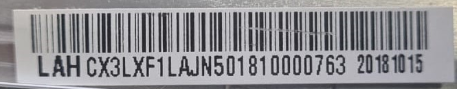

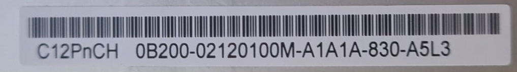

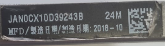

              i really dont know which one is SN.. :$
              JANOCX100392438
              C12PnCH 0B200-02120100M-A1A1A-830-A5L3
              LAH CX3LXF1LAJN501810000763 2018 10 15
              QCCXF1 F107184300212
              60N808KD- C-MB1220-204​

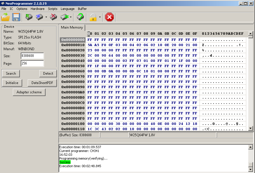

                Neo Programmer Log; backup file used.. still white led blinking..
                Programmer for MCU, AVR, SPI FLASH/EEPROM, I2C, Microwire, v2.1.0.19
                Current programmer: CH341
                SPI ID: EF6017
                <<W25Q64FW 1.8V>>
                Done
                Old SREG: 00000000(0x00),
                New SREG: 00000000(0x00),
                16:50:04
                Erasing memory...
                The process can take more than a minute on large flash memories!
                Success
                Execution time: 00:00:49.476
                16:50:53
                Verify memory...
                Success
                Execution time: 00:01:09.537
                16:52:03
                Programming memory(verifying)...
                Success
                Execution time: 00:02:48.845

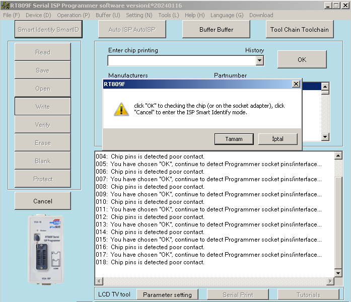

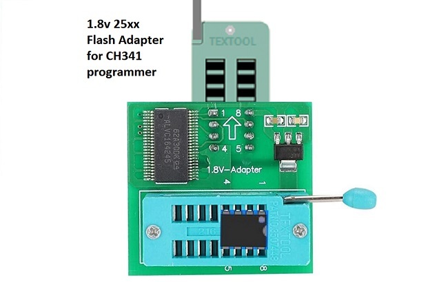

                    hey again..
                    Currently selected: W25Q64FW [1.8V] 64 Mbits, 8 Mbytes
                    !! Adapter required !!
                    what is the SPI_1.8v_Adapter..? do i need this adapter for this eeprom.? <<W25Q64FW 1.8V>> i can read or earse the eeprom.. still i need it..?

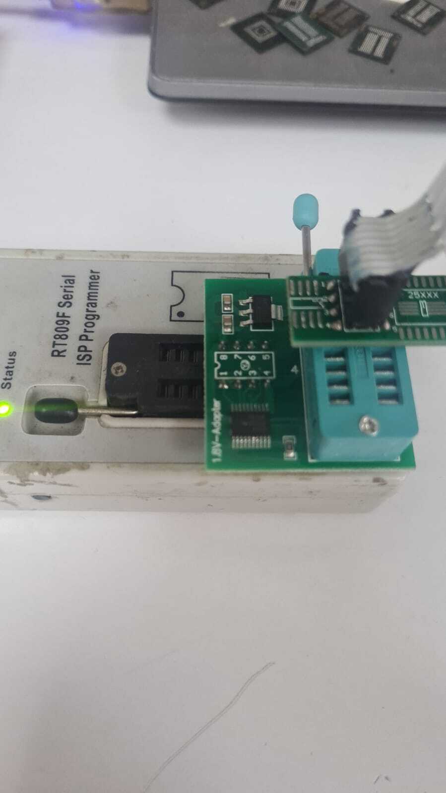

                      i see you have also RT809, use SmartID tab, chose 1,8V and 25xx SPI then hit ok tab (is in Chinese but is the tab on the left on bottom window)
                      • just_bios
                        • Mar 2021
                        • 39
                        • Netherland
                        hey.. software detects the eeprom as W25Q64FV(QPI)​ but my eeprom is <<W25Q64FW 1.8V>>
                        022: Auto identified 25 ID is match with the partnumber.
                        023: http://www.ifix.net.cn/thread-2550-1-3.html
                        024: The currently selected:W25Q64FV(QPI), capacity: 64Mbits, 8Mbytes.
                        025: >------------------------------------OK---------------------------------------<
                        • volinakis

                          did you select 1.8V?

                            hey..
                            as u mention above i cannot choose any 1.8v.. if i press the "Smart Identity Smart ID" or "Smart ID" buttons this is the log;
                            001: Chip pins is detected poor contact.
                            002: You have chosen "OK", continue to detect Programmer socket pins/interface...
                            003: Auto identified 25 ID is match with the partnumber.
                            004: http://www.ifix.net.cn/thread-2550-1-3.html
                            005: The currently selected:W25Q64FV(QPI), capacity: 64Mbits, 8Mbytes.
                            006: >------------------------------------OK---------------------------------------<
                            there is no option like 1.8 or another... my rt809f version is 20240116

                              for RT809F you have to use 1.8V adapter. Man, do I have to read for you user manual? An if detected "poor contact" you chose to continue operation?
                              • just_bios
                                • Mar 2021
                                • 39
                                • Netherland
                                hey..
                                if i use the 1.8v adapter rt809f not detecting the eeprom..
                                  hey..
                                  "poor contact" - now you want me to read what programmer try to tell you ...
