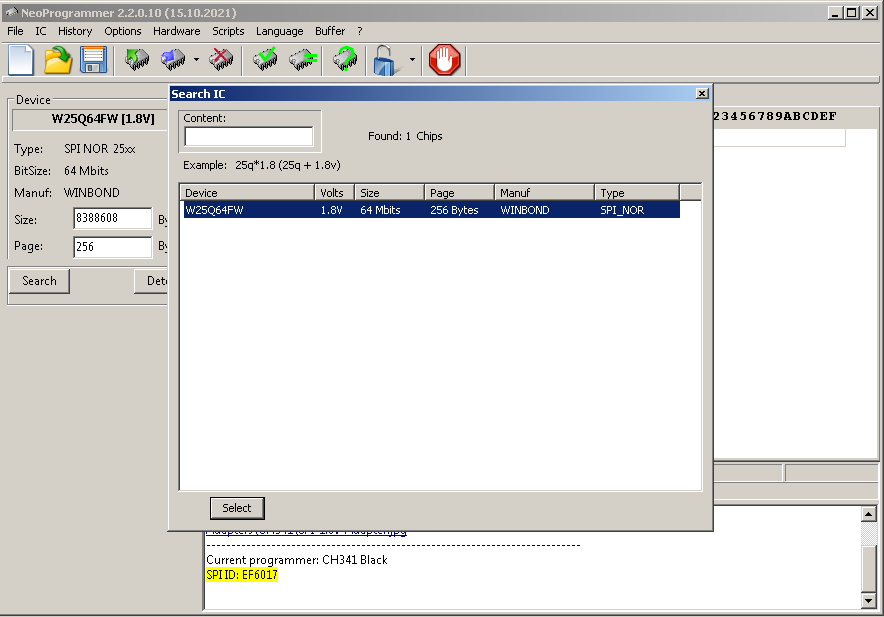

                thanx alot.. i modfied it ( changed ur SN -J1N0CX08U850027- with mine -JAN0CX10D39243B-) and flahed ur working bios but still same white led blinking 5-6 times then nothing.. and this is the RT809F log;
                software detects my bios W25Q64FV(QPI) but my bios marked W25Q64FW 1.8V.. which software did u use for dump..? and i added my modified bios file and other thread for my pb..
                https://www.badcaps.net/forum/troubl...a-bios-request

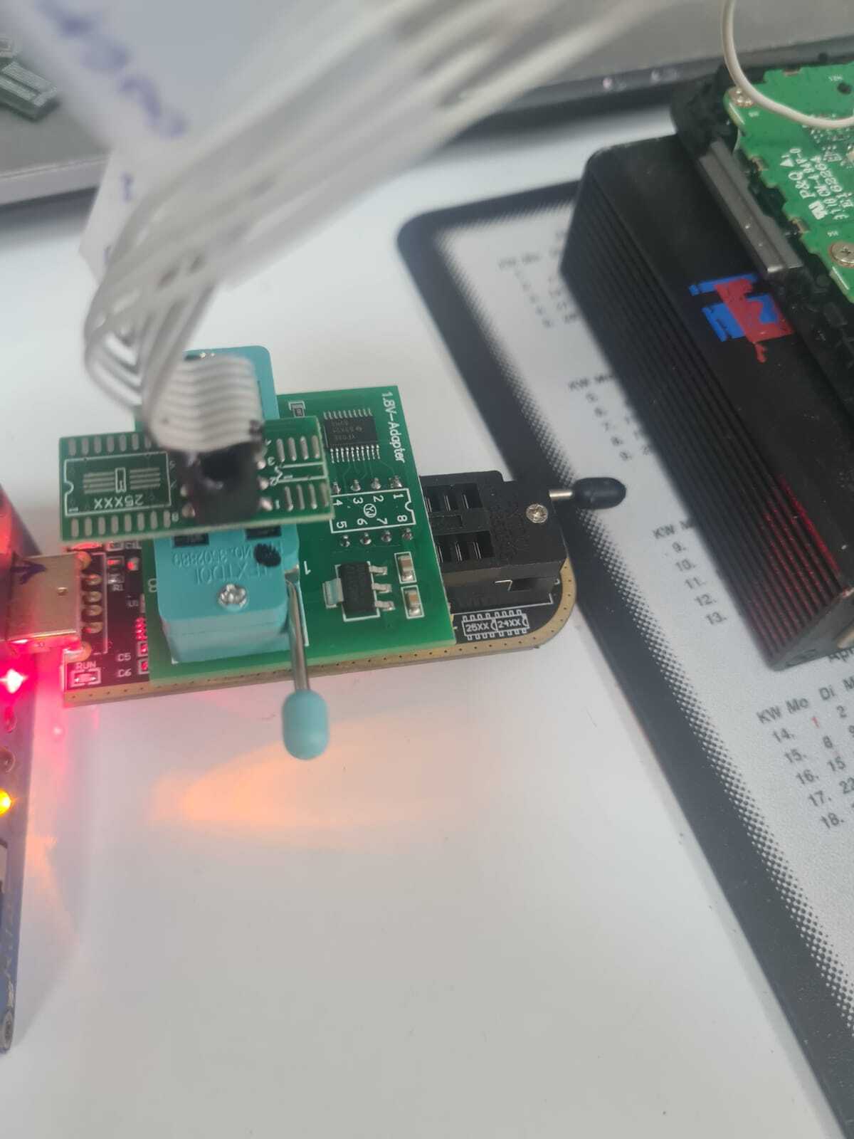

                    I've checked voltage on BIOS chip and there is indeed 1.8V. So, you will need adapter for your CH341 if it supports only 3.3V.
                    • just_bios
                      • Mar 2021
                      • 39
                      • Netherland
                      thanx alot..
                      i am waiting for my adapter.. i will post the results...

                        hey again..
                        i tired via CH341 with 1.8v adapter but nothing changed with my old working buckups or anothers...
                        Code:
                        Programmer, for MCU, AVR, SPI FLASH/EEPROM, I2C, Microwire,2.2.0.10 (15.10.2021)
                        chiplist.dat Version: 29.09.2021
                        Currently selected:  W25Q64FW [1.8V] 64 Mbits, 8 Mbytes
                        !! Adapter required !!
                        Current programmer: CH341 Black
                        SPI ID: EF6017
                        Done
                        CRC32 = 0x5B8EBAD9
                        Old protection Register: 00000000(0x00),
                        New protection Register: 00000000(0x00),
                        16:04:54
                        Erasing memory...
                        Success
                        Execution time: 00:00:31.919
                        16:05:26
                        Erasure control...
                        Success
                        Execution time: 00:01:05.196
                        16:06:31
                        Programming memory(verifying)... Main Memory
                        Success
                        Execution time: 00:02:05.558
                        RT809F not detecting ic with 1.8v adapter..there is no pb without 1.8v adapter..
