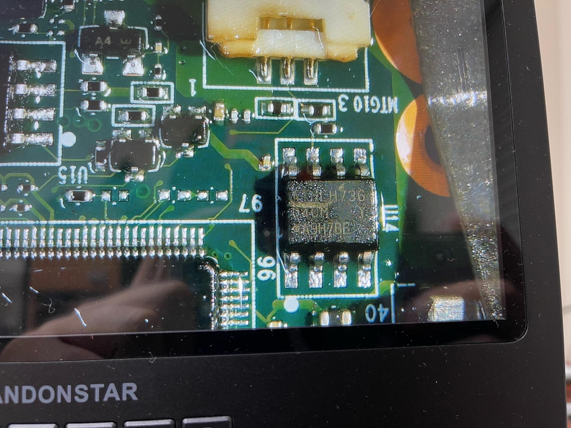

        Hello! I'm trying to read this BIOS on a Getac V110 G4 but after comparing with the files shared here it seems I'm lacking one file that is the Intel image. I only got a 1024kb file but I'm unsure of which chip I should be reading besides the W25Q80DVSIG. If anybody could point me in the right direction that would be awesome. Thanks!

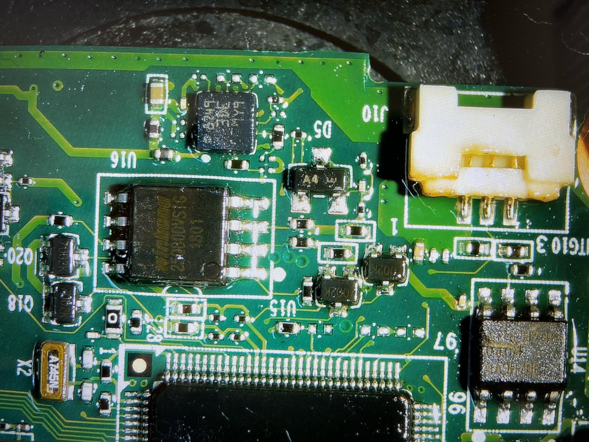

            Hey Vesko356, thanks for that link. I've carefully examined the board looking for another memory. I've actually found an ATML736 that seems to be a 93C46 per the datasheet. I tried reading that with two different programmers: UUSP-S (formally UPAUSB) and CH341a and still nothing came up. Check the attached pictures if you can. Thanks!

              Re: Getac V110 Bios Needed.
              Neither of these is the bios chip.
              Search for it more carefully by looking around the board.
              It should be labeled W25Q128xxxx or something similar containing the 128 in the marking.
                I finally found the right chip. On my version of Getac V110 G4 its located right underneath CPU chip. I see the SystemOemGetacS variable and its GUID: 919F933F-46CD-46F6-9BBB-6EA0D8F05DA0 but I've compared the body of other Invalid variables inside the dump and can't find a consistent result that I could use to invalidate SystemOemGetacS. Can somebody help me clean password on this one? Or try to guess it, please.
